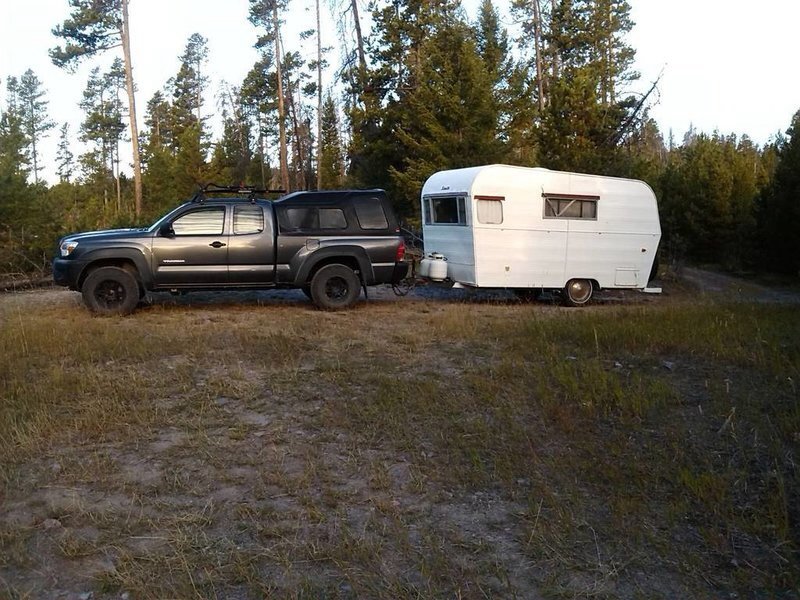

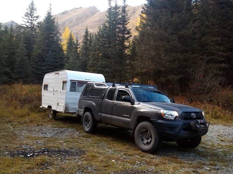

    Back when we were pretty much stock
    Truck lifted on 33s, trailer lifted too
