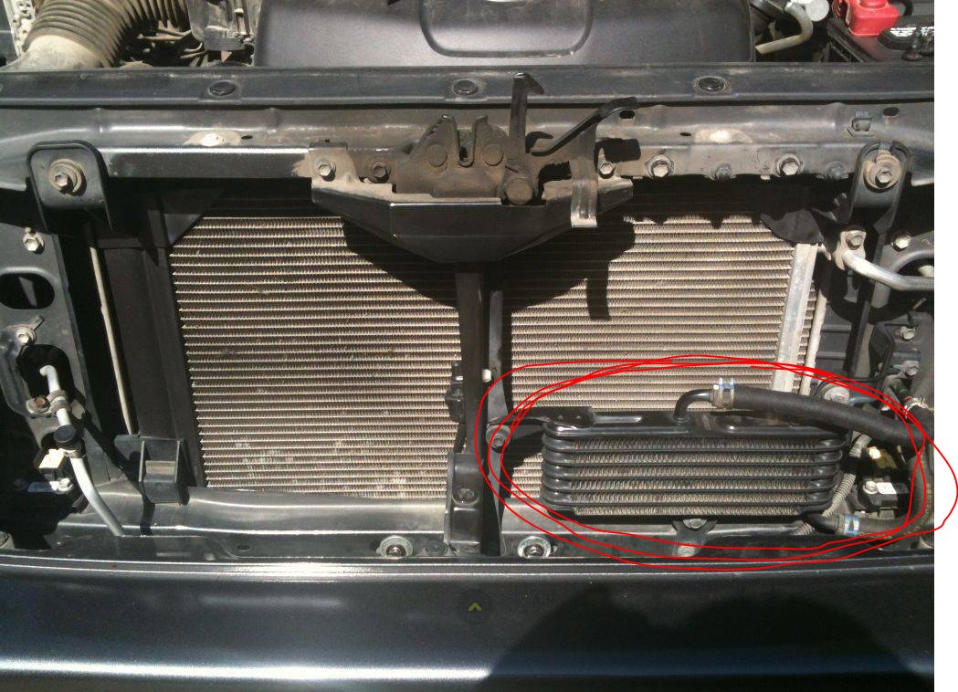

    Might check to see if you have the transmission oil cooler, too. That is another way to see if it had Factory Tow Package.
    Pic not mine, but it's the thing circled in red. You can see it through the grill, or looking down from above (don't need to remove grill like in this pic).

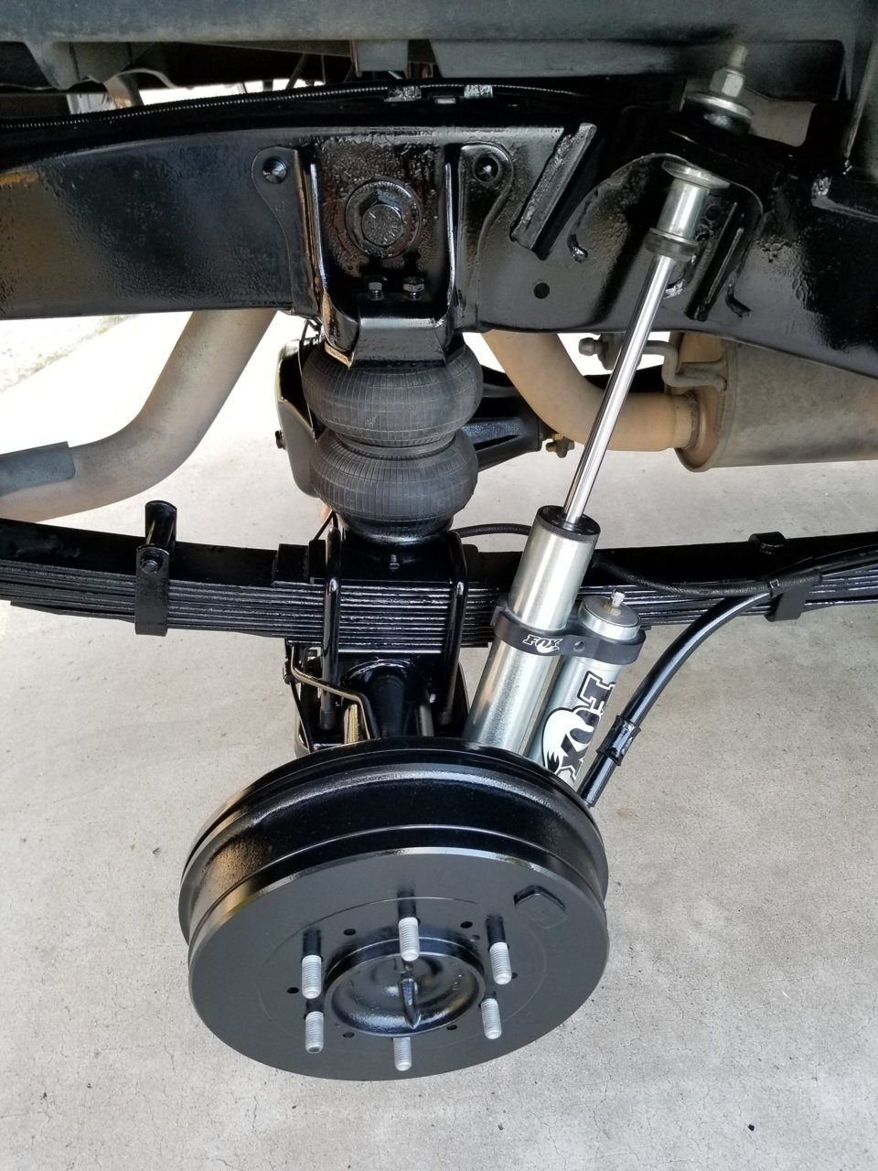

    No, just hook up and go. I do run air bags though.

    Very nice, and SOO many leaves. Looks good.
    Just thought I'd ask since "comfortable" towing might be helped with a few simple add-ons. Equalizer hitch, airbags, etc. I'm a big fan of airbags for their versatility, and the price point is awesome.
    Personally I have HD leaf springs instead, but that was just cause I ALWAYS have a lot of weight on the truck, rather than just sometimes. And yes, I do tow a lot, but not a travel trailer. Just an open car hauler. The wind resistance makes a massive difference between open and enclosed trailers. I'll stick with my open trailer. :D

    I do have the transmission oil cooler on my truck. Thank you.
