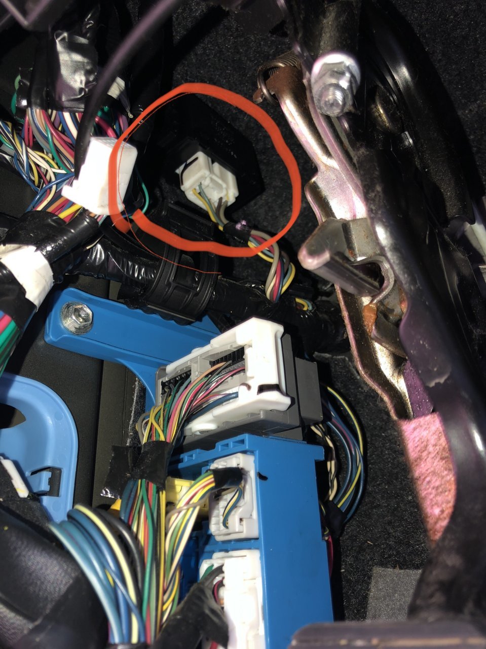

    Anyone know what this is?

    thats not it.
    I believe mine was taped up to the main loom hidden you had to feel for the plug.

    hey again nd. Is it a 2 wire plug?

    Is it a two wire small plug?

    It has a blue wire and a yellow with looks like a brown stripe

    That's not it.
    It looks a little more rectangular.

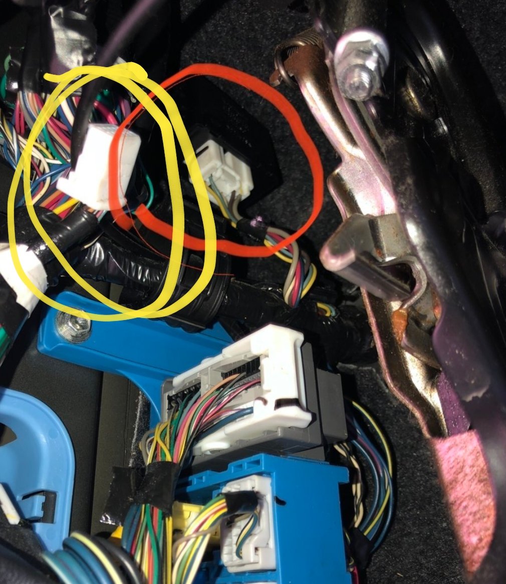

    Im having a hard time seeing this plug from your photo. What's this guy?

    Looking again

    Hey again. Is this it?
    I sure hope so

    Sure looks like it to me.

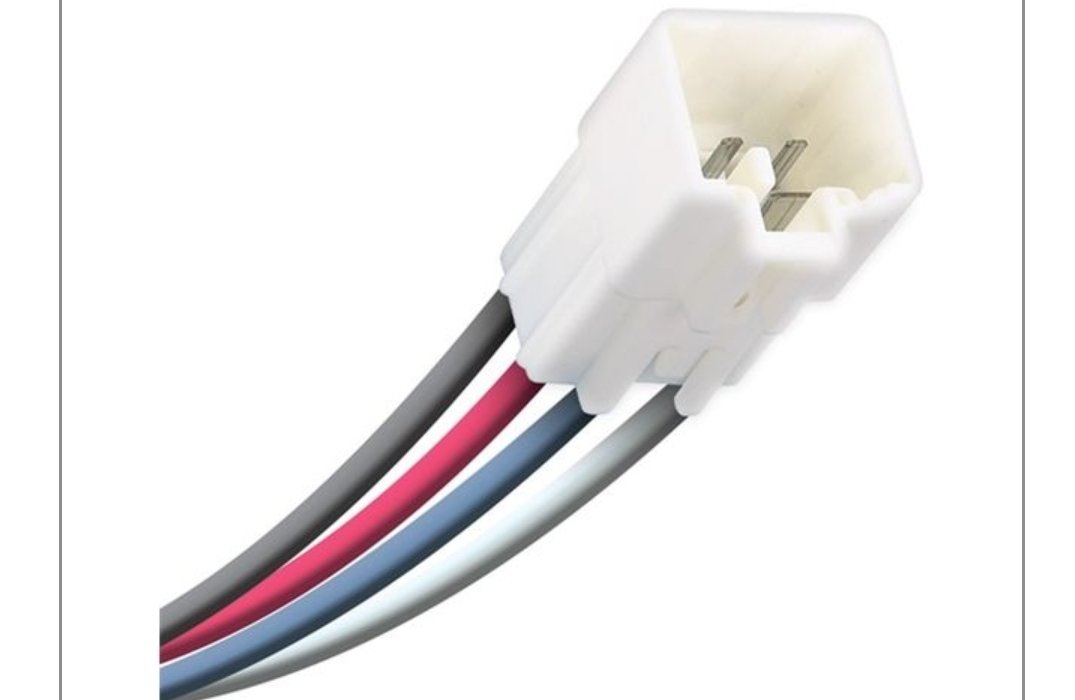

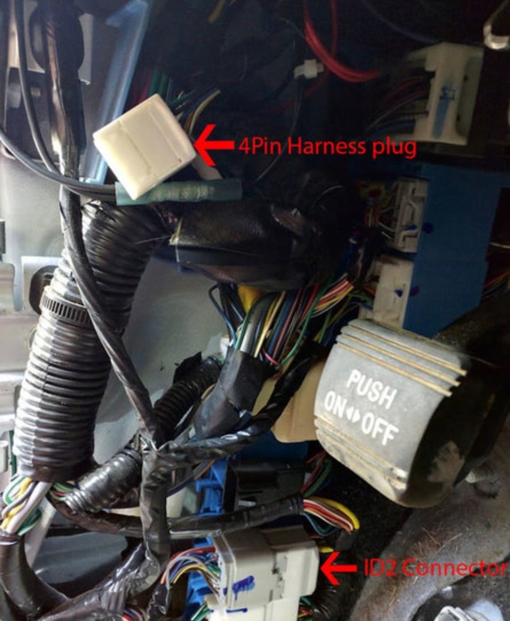

    Here is what a 2010 adapter harness looks like, and I think it matches your plug there.
    I think we have a winner.
