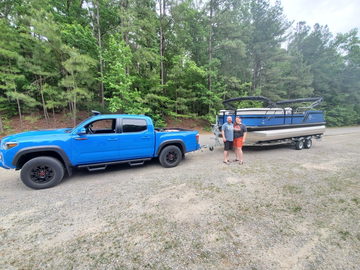

    i towed a pontoon from Virginia to ohio and it wad a pita due to it being so tall plus it being close to the towing capacity it felt squirrely over 65 mph

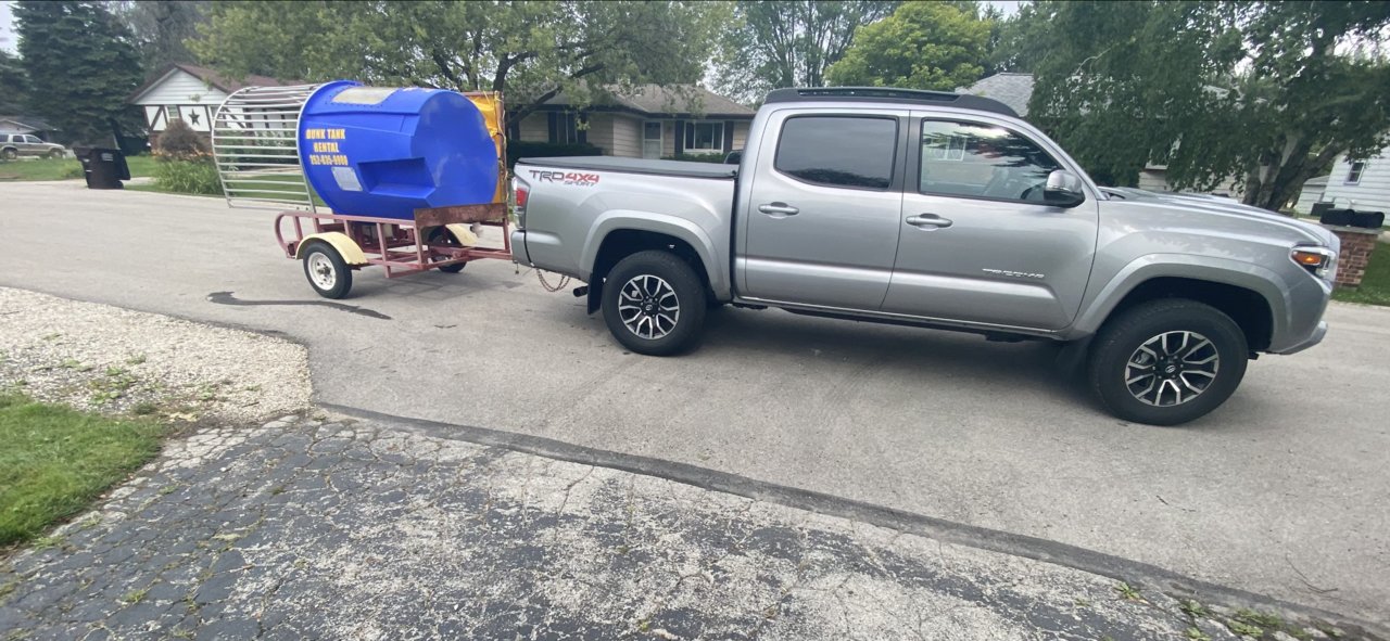

    It’s that time of year again.
    I picked up the dunk tank for the annual block party with my new 2021 Sport. Didn’t even notice it back there for the 12 mile drive. Maybe because it weighs less than 500lbs.
    :rofl::rofl::rofl:
