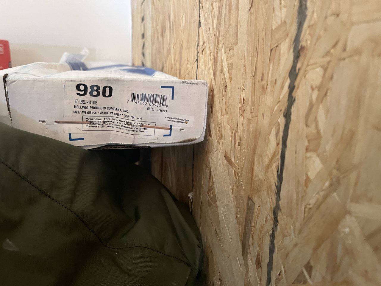

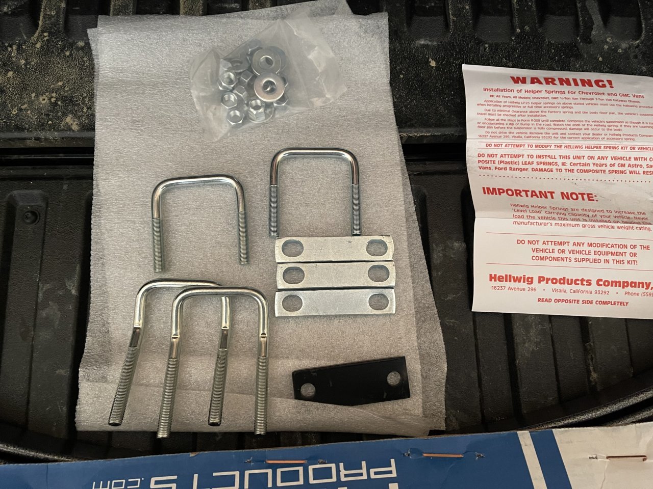

    I have out grown my helpers and will be upgrading to OME Heavy Leafs next month. The Hellwig 980 Helpers for my '21 DCSB TRD Sport did their job without issue but I am constantly carrying 800 to 1000# which is asking the helpers to do more than they were designed to do. Overall I am very pleased with how the helpers behave unloaded as well as how they help (pun intended) when under load. Unfortunately, my Taco is carrying too much weight on the regular for these to be effective - that is my issue not any issue with the product.
    I am extremely disappointed with the packing job (all the parts were rattling around in the box) and there were no instructions but thankfully there were some YT vids out there. Only thing to know on the install is the driver side front bracket is the only one out of the 4 brackets that is different. Rather than the U joints facing down and threading from the bottom they instruct you to install the black bracket vertically and the U bolt on its side (pictured above). That is the only thing you really need to know.
    PM me if you'd like to buy my used set of Hellwig 980 Helpers on the cheap and can wait until late next month when I have the new kit on my rig. If you are going with new Hellwigs be sure to only buy them from an authorized dealer as warranty claims will not be honored from some rando reseller.

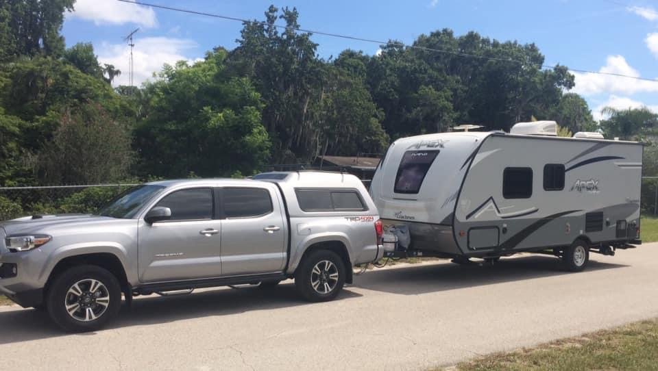

    I used a Fastway E2- 600 lb model for my Satellite 17RB. My truck also has Wheelers 1.5 AAL to compensate for the drop I experienced after adding the topper, toolbox and bedmat.
    The pic below is without the WDH since I was only borrowing a friends trailer to see if I wanted a trailer this big.3A286E41-41A0-4952-8836-E7E37823EBEA.jpg
