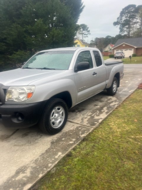

    I bought this 2011 4x2 Tacoma my two questions were will it be able to pull a zero turn mower and medium size trailer and what gear do I tow in thanks
