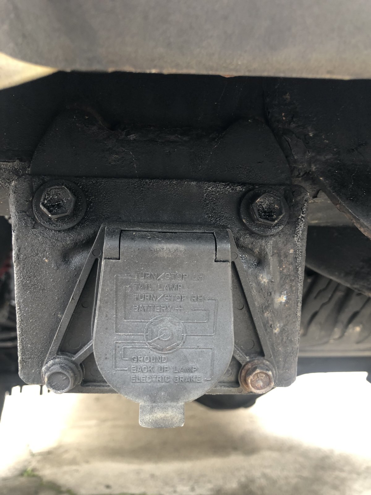

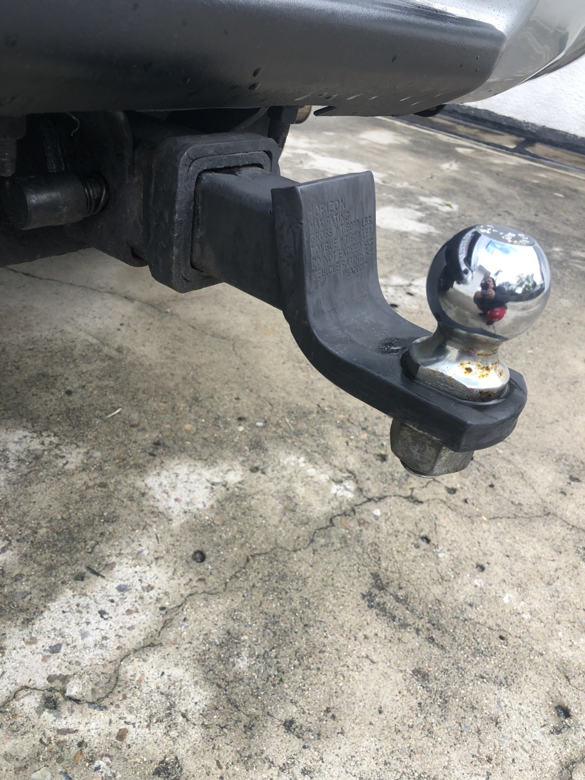

    Question regarding towing a U-Haul trailer for a 2013 Tacoma V6 I don't believe it has a tow package on it although we have a 6000 pound hitch do I need stabilizing bar to drive from California to New York?

    U-Haul’s aren’t know for being light trailers. So you’ll start with a bit of weight empty. Depends on what you put in it as to how much it’ll weigh. You have to determine if you have a tow package. If you bought the truck new, do you still have the window sticker in the glove box? Is there an 7 pin trailer harness under the rear driver’s side of the hitch? Otherwise you could tell if you have an external oil cooler. Post a photo showing the color of the fan pulley and another of the oil filter. That would help determine if there is a tow package. I, personally, wouldn’t tow near max weight. It would give me a white knuckle ride. For the distance you are towing, a stabilizer sway bar would be helpful. I don’t know if U-haul’s set up is compatible with a load stabilizing hitch that they could rent you. That would transfer some of the weight to the front axle of the truck. It’ll squat a lot riding only on a regular hitch if the trailer tongue weight is heavy. The last bit of advice is to make sure the u-haul’s brakes work well. They tend to use surge brakes which is a spring in the hitch assembly that senses when the trailer is pushing into the truck and activate the trailer brakes. I’ve had bad luck with those where the spring wasn’t set correctly and it would push the truck very hard before starting to brake. Not good in a downhill turn as it would push the truck’s rear sideways.

    The trucks not here right now but I will send a picture from the engine and I don't see what looks like a seven pin trailer harness under the driver rear near the hitch but not exactly sure what I'm looking for either

    i have these in my fone. will need to check the other thing
