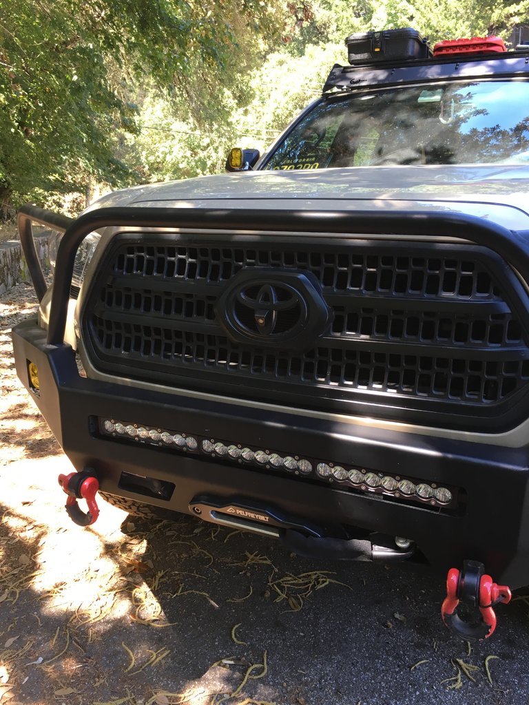

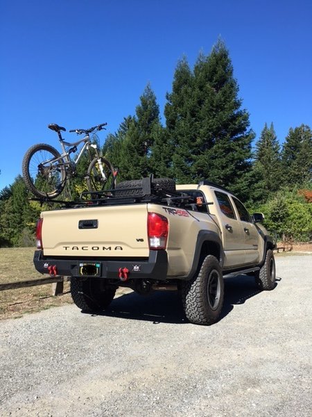

    The rear @Pelfreybilt bumper and another pic of the front. IMG_4361.jpg IMG_4352.jpg

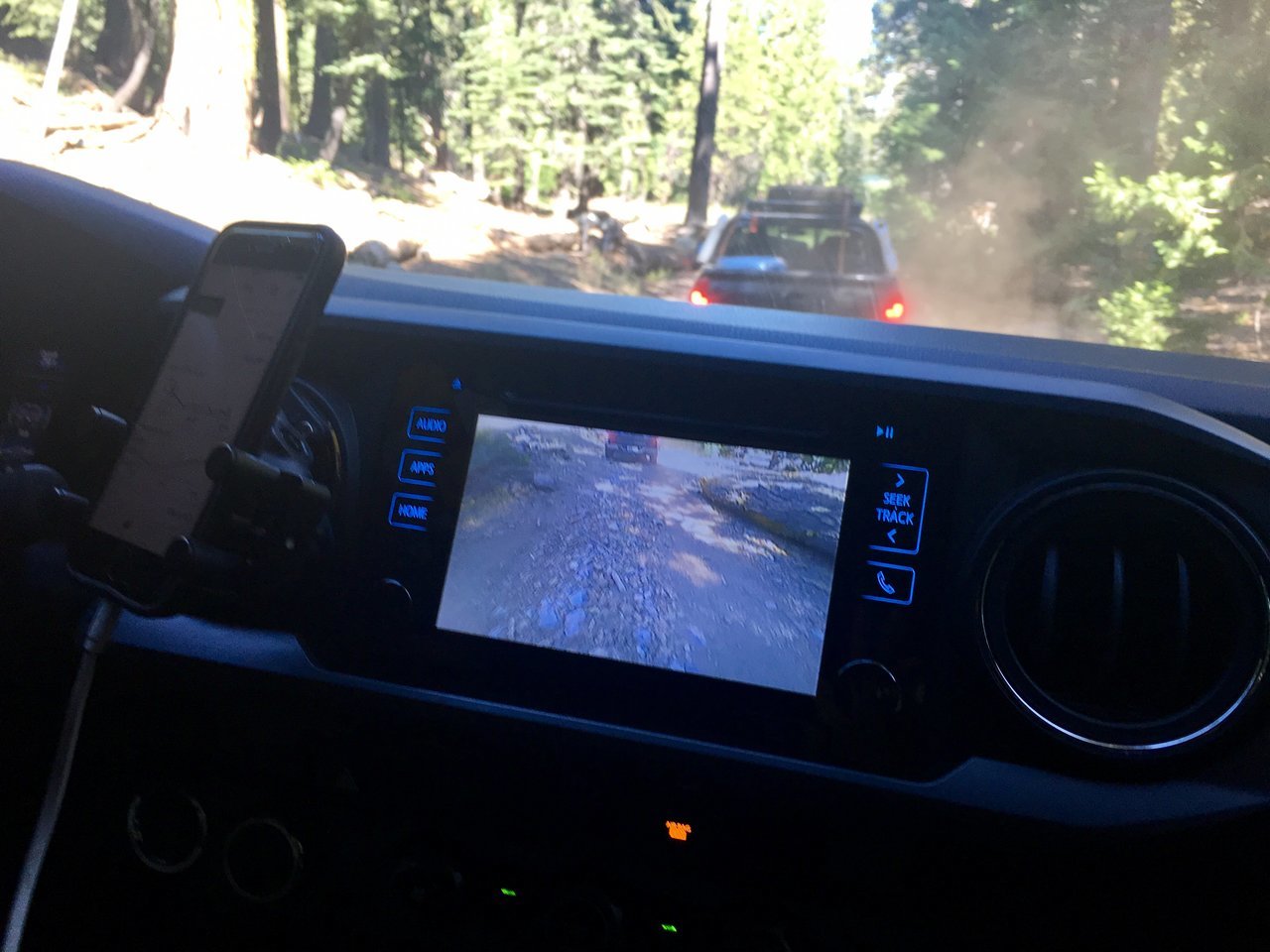

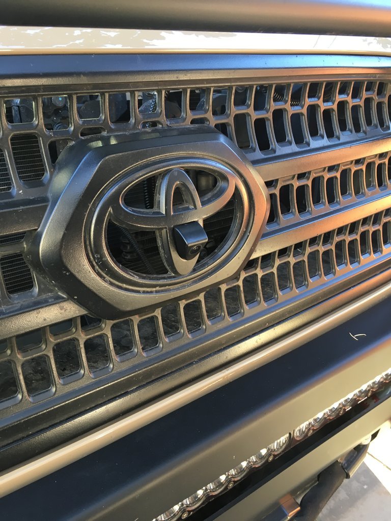

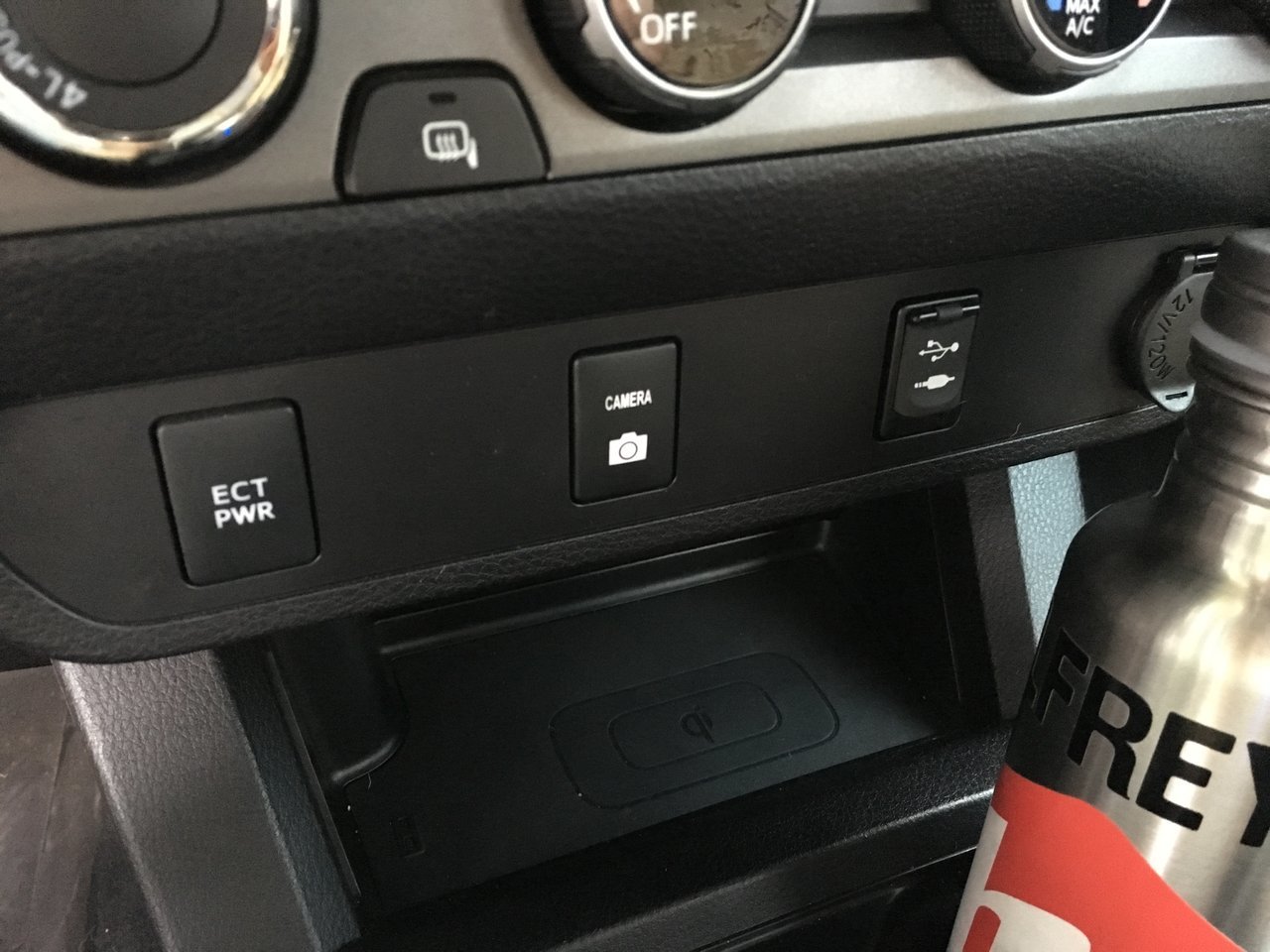

    Installed #BeatSonic's CS6EP anytime front camera interface.
    http://www.beatsonicusa.com/cs6ep.html
    Install is easy and tough at the same time. Easy in that it is simple plug and play, tough in it takes a bit of time to run the wires through the firewall.

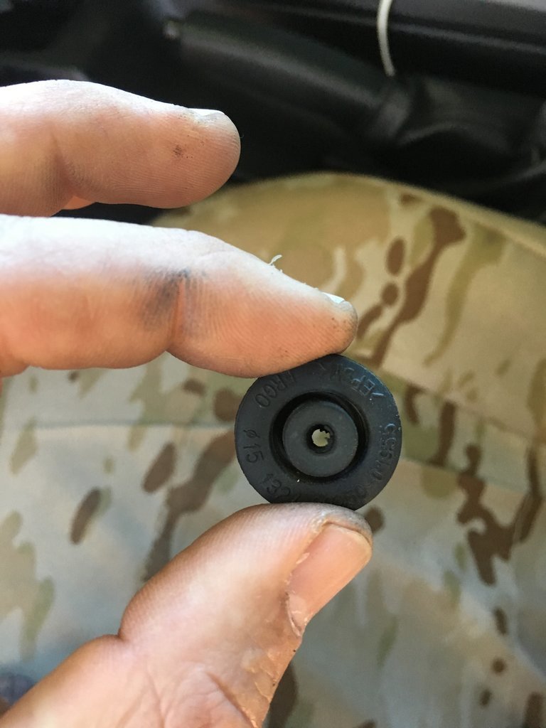

    Pulled out this plug in the driver's side firewall and drilled a hole though it for the wires then fished the wires from behind the carpet with a coat hanger. IMG_6127.jpg
    I have an iPhone so I don't use the Qi wireless charging so I unplugged it and put the camera button in its place. IMG_6133.jpg
    I used a camera BeatSonic recommended from Amazon:
    https://www.amazon.com/iNewcow-Embe...500652151&sr=8-1&keywords=toyota+front+camera
    It blends in nicely into the front Toyota emblem.
    Haven't had a chance to REALLY need it on the trail but I definitely used it a few times last weekend and that extra "pair of eyes" up front is a bonus.
    I've also used it since instal in a few parking situations and again it's a bonus to have.
    Another nice feature is that you can view the rear camera at anytime as well - you don't have to be in reverse.
