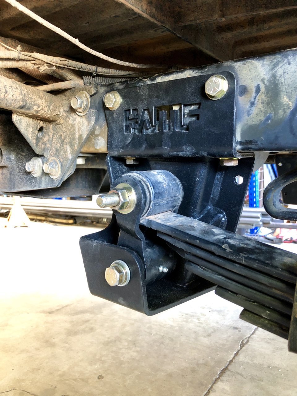

    Installed BAMF shackle hangers and shackles.

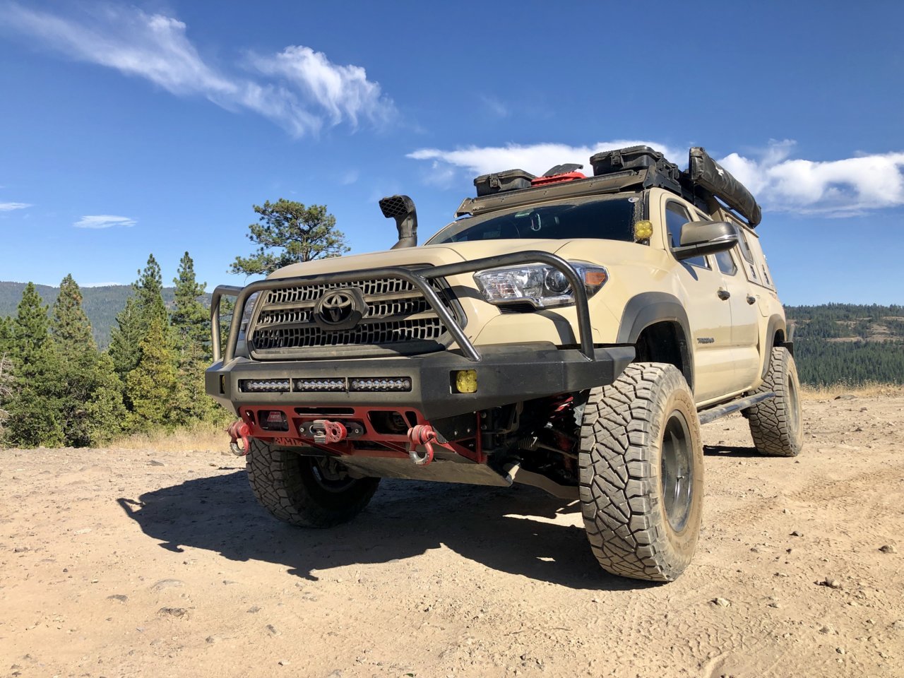

    So stoked on the new BAMF bumper!! :bowdown::bowdown::bowdown:9CDFFED3-56AA-4081-8E0B-D5834898426F.jpg

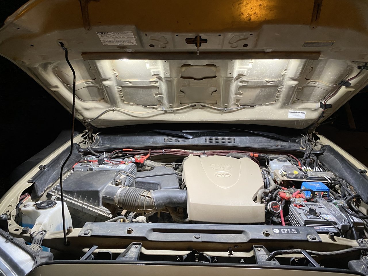

    Sure hope I never have to get under the hood at night but at least now I’ll be ready if I have to. Installed a couple KC Cyclones under the hood. 09C0FB26-BEFE-4FA3-885D-10453C5DF733.jpg

    Did you buy the kc kit or build your own? I’m curious about the hardware people are using to mount them

    DIY. A couple self-tapping screws and a small toggle switch over by the battery

    any chance you remember the sizes?

    Sorry I don’t remember. I just took one to a hardware store and picked out a washer that fit and the shortest self-tappers they had (1/2” or 3/4”)
    where I placed them there was sizable enough gap not to have to worry about the screw penetrating through the hood.
    Just be careful to watch and as soon as the screw starts to create its own hole to go slow after that. The metal is thin so it could be easy to strip it out.
