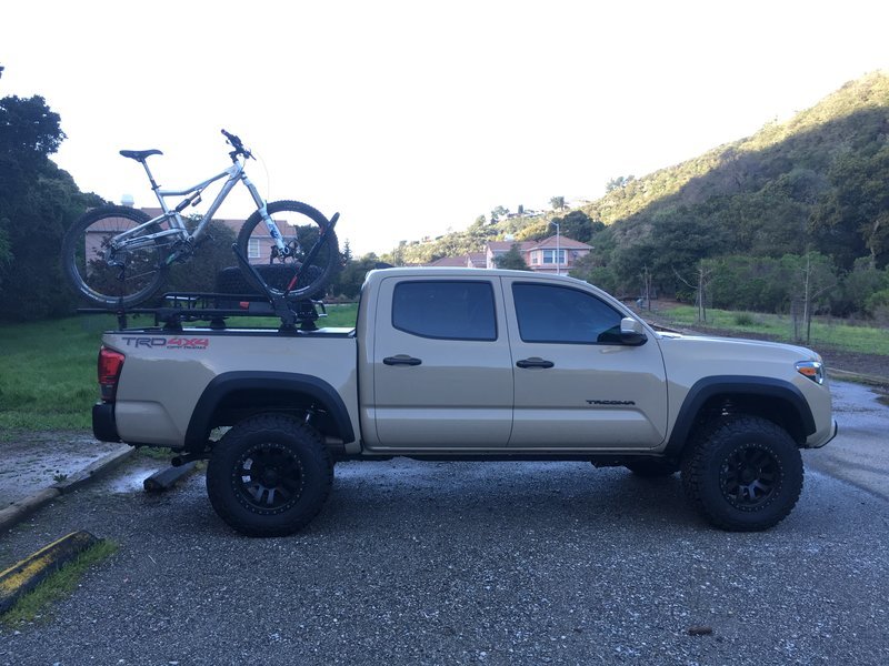

    Had the opportunity to do the hood swap but after sitting in a sport and looking over the scoop I decided to stick with the OR hood. I may have gotten used to it, but it did seem to make judging where the front and especially the front left corner a little difficult. But I do like the look of the hood scoop so having second thoughts... Should I have done the swap???
    Got a break in the rain so took off the B-pillar vinyl and got a quick mtb ride. On the quicksand OR I think it looks better without it. I like the contrast between the two windows.

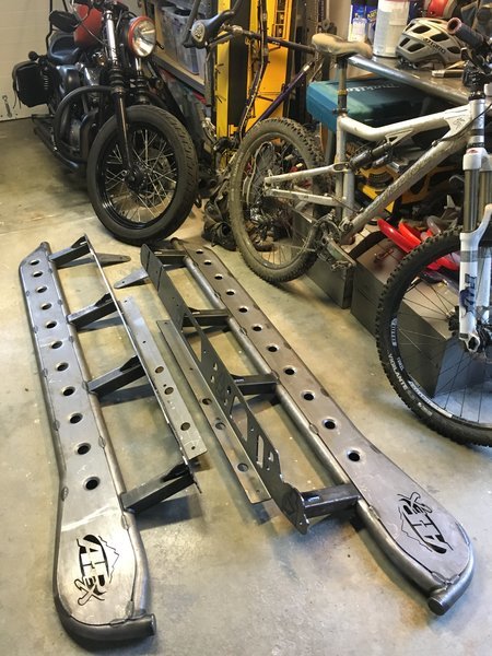

    Ok so I've never had any desire to sleep in the garage but damn is it tempting now! Seeing the pics on Allpro's website is one thing, but DAMN are they some combination of BADASS & SEXY!!
    Hoping I can start priming and painting tomorrow evening.
    Big thanks to Tracy and Allpro for the 20% off group buy, I'm so stoked right now!!

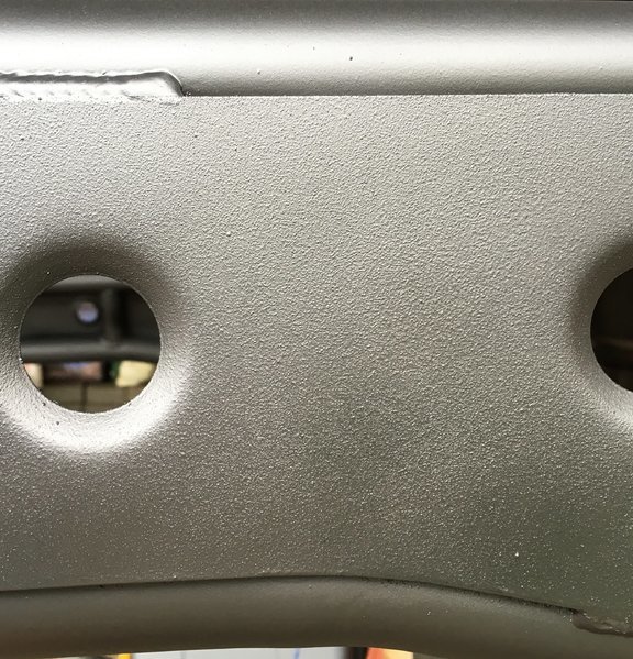

    Here is a pic of them after priming with self etching primer. Used four cans. Three did a solid job but the last can made sure every inch was well covered.
    I then painted with satin black but was glossier than I had wanted so will do flat black over them tomorrow.

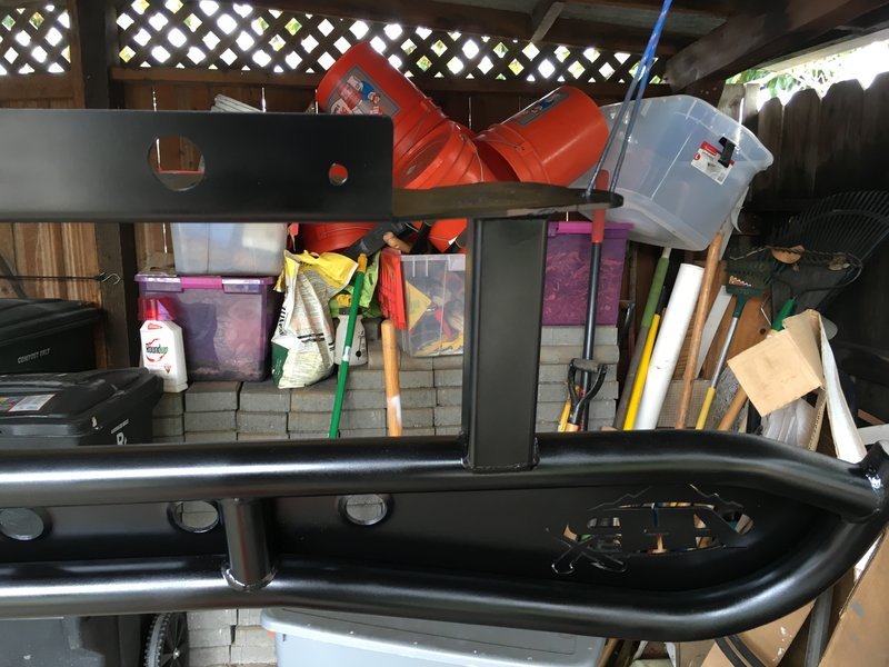

    I went with Rustoleum. Then did with their flat black, and then taped off the top fill plate and hit it with a few coats of Rustoleum truck bed spray. Had to spray that further away than the spraypaint as it is very pressurized and it would be easy to overspray. I then did a couple coats of flat spray paint over that to get everything back to flat.
    The satin was glossier than I had wanted:
    Taped off to to hit fill plate with rustoleum truck bed spray liner.
    You can see texture contrast between regular spraypaint and the truck bed spray.
    Hopefully have some time to mount them tomorrow!

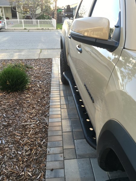

    Got the Allpro sliders installed and they are BAD ASS!!
