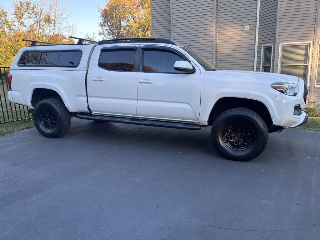

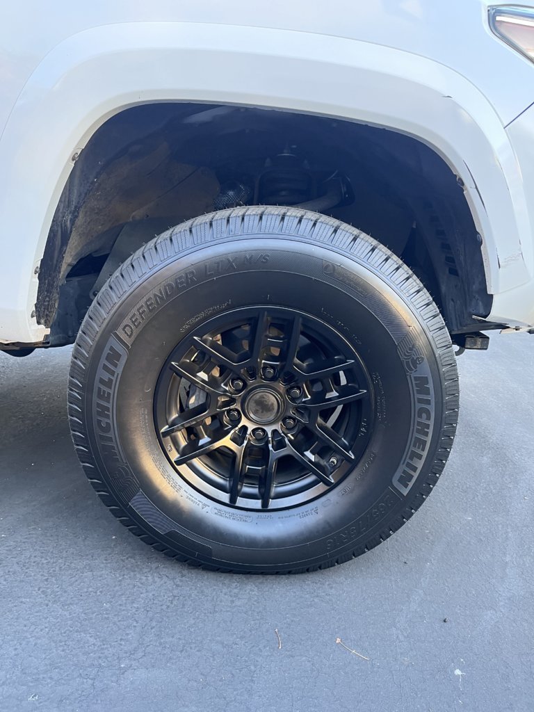

    richiedafish
    richiedafish [OP] Active Member
    Feb 3, 2024
    #443084
    26
    Rich
    2020 DCLB
    ditched the AT’s for Michelins and couldn’t be happier. The truck is wayyyy quieter, seems peppier, handles better, and rides like what I imagine a Lexus Tacoma would feel like if they made one. At 75mph it feels like a brand new truck.
    I did NOT try to warranty to the toyos. Based on the verbiage in the warranty, I thought at best I could get 50% of purchase price which wasn’t worth the hassle to me. Stay tuned for terrain handling updates.
    Canadian Caber and skidooboy like this.
