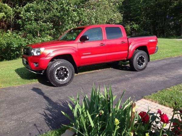

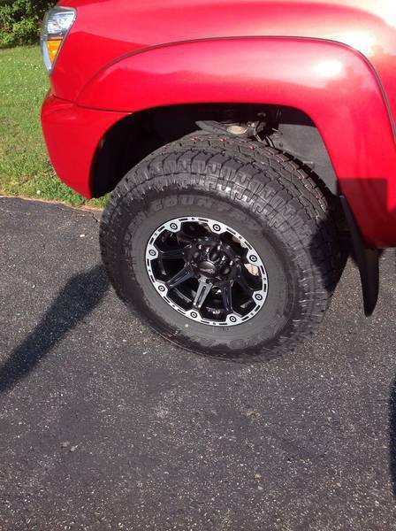

    I just picked up a set of AT2s in 285/75/16.
    I wanted 265/75/16C but Town Fair Tire didn't have any in stock. They told me try the 265/75/16E and if I don't like them He'll ordered the range C's and that I get to drive the Load Es until He gets my new tires." I ask him if this is the case can I try 285/75/16s.... He said no Problem!!!

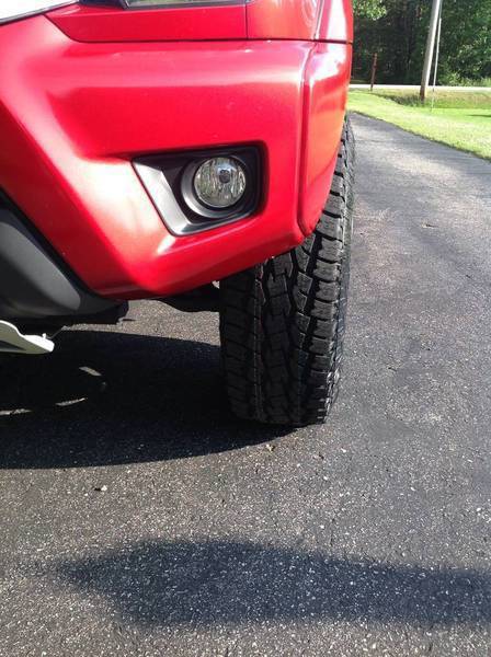

    Actually they are 285/75/16s on Dick Cepek Torque rims. The rims are 16x8 with 4.5 backspacing and 0 off set. I had to remove the little front flaps in front but so far clear my mud flaps. So far the only rubbing I had wasd backing out of my buddy's driveway cut hard to the right. Not sure what rubbed it only lasted a quick mil-second and I haven't notice where it hit.

    Interesting... How severe is the off-roading and how bad do you rub? I am currently running Bilsteins at 0, OME 885 coils, with my stock UCAs.
    I know that if I was to go off-roading with this setup I'll be rubbing for sure, but I would have thought the front of the fenders. I have very little room between the front of the wheel the fender.
