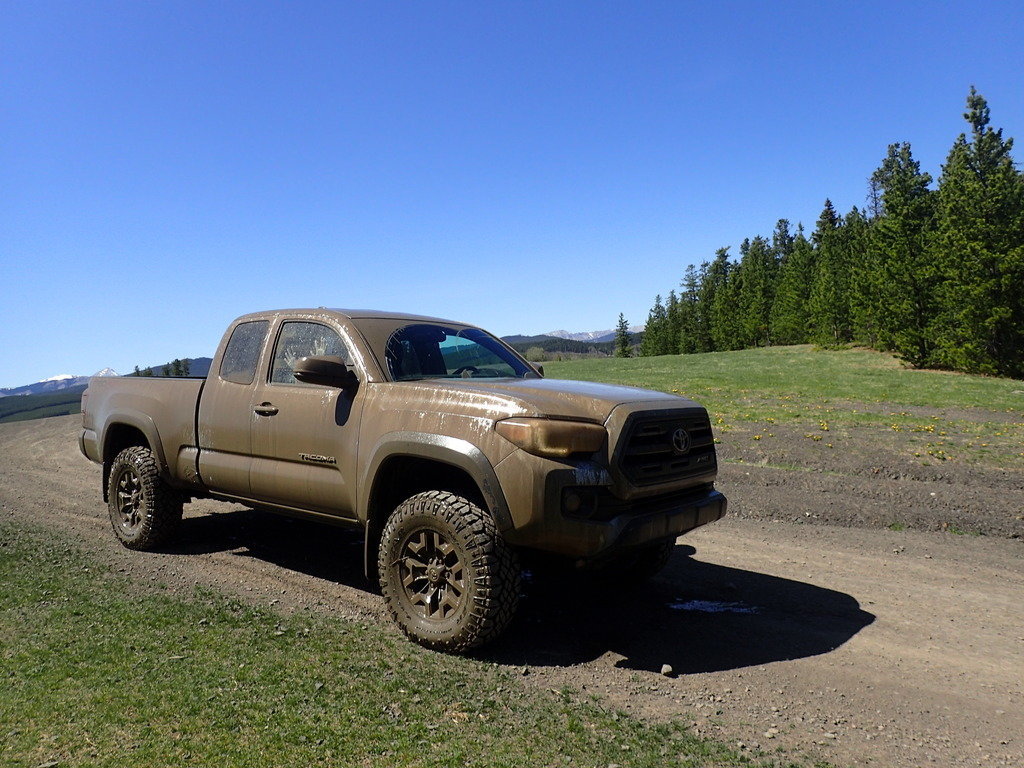

    The 265/70R16 wranglers are ok for winter, I ran 265/70R16 winter tires and 265/75R16 duratracs summer. The 265/75 is 31.7" so its only 1/2" less height than the 33" 255 85 16.
    Pic of my old rig for tire size.

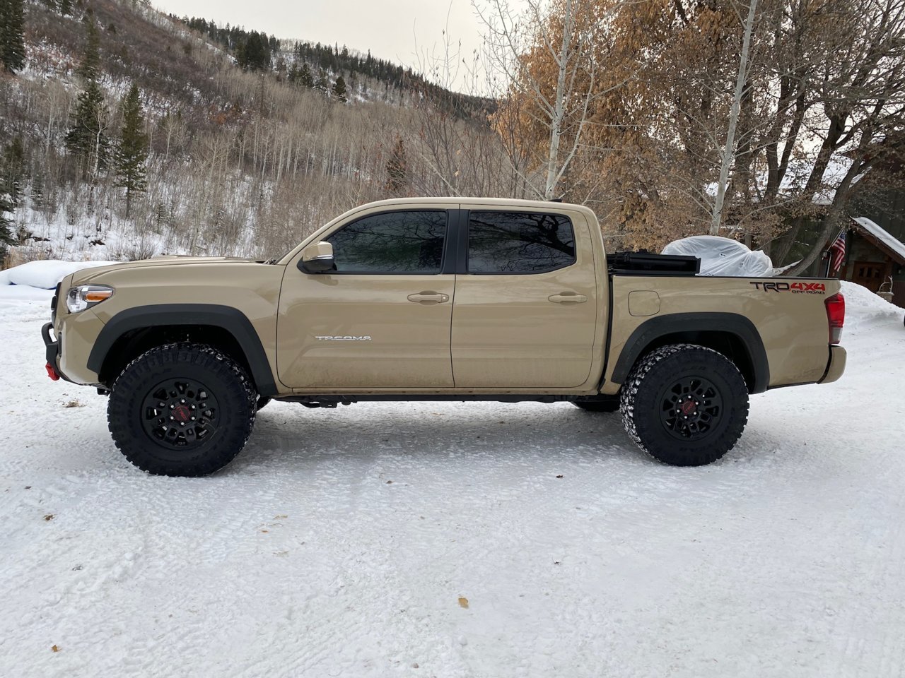

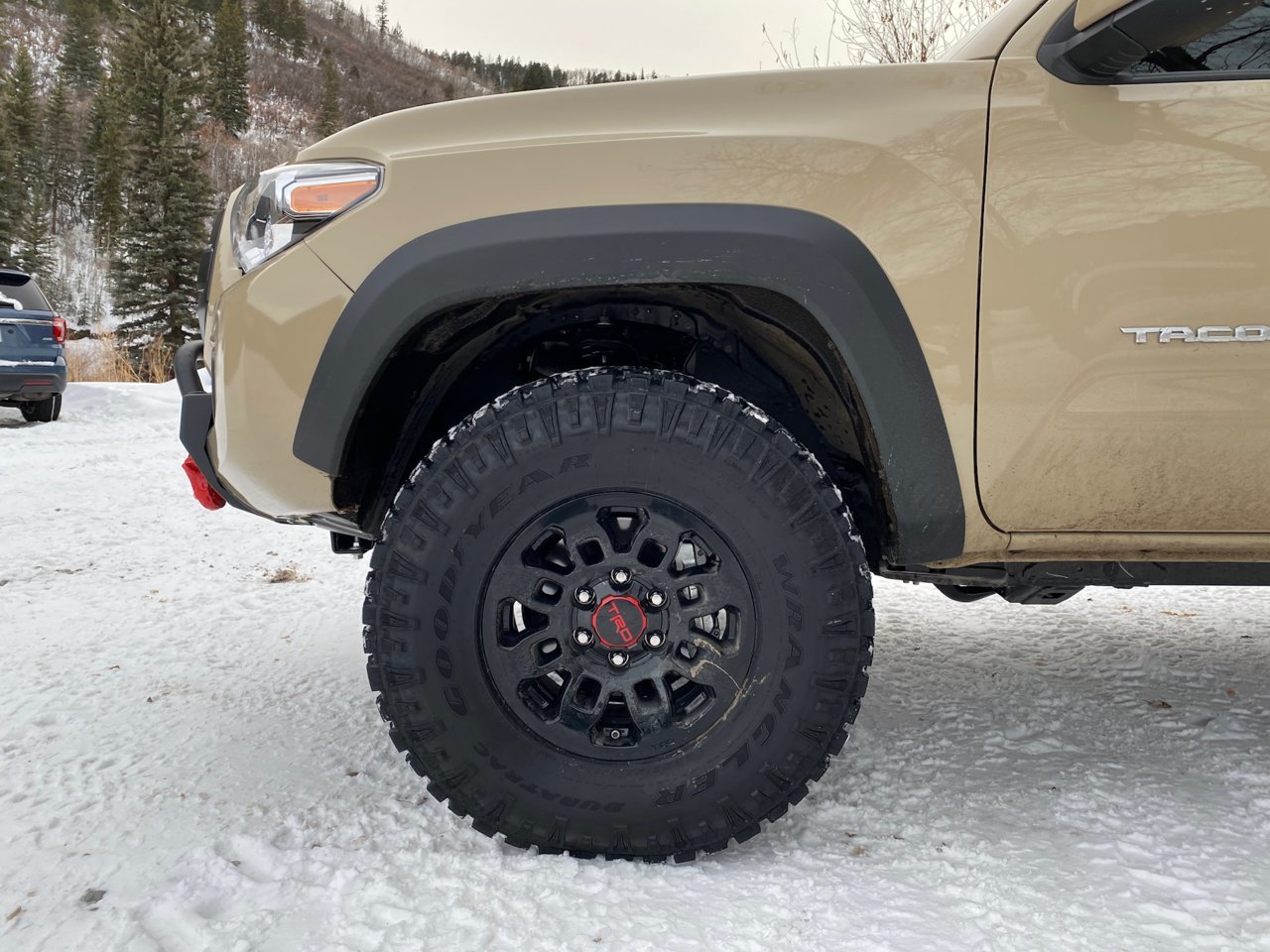

    WTF??? The 285 duratracs fit with no rubbing?!? Who woulda thunk??? I only raised the front an inch, well 1.5” but I do have a heavy bumper and winch that sunk it. So the front is now level with the back. I REALLY didn’t think there was a chance in hell 285s would fit. I’m so psyched! Best of both worlds, lift and traction. It’s getting an alignment right now. Pics to follow.

    947BC065-578D-4334-BC70-F1F1B043FAD4.jpg 7CCB1A0F-D15E-4D7C-A6C8-E04306EC9992.jpg 2F3E7C1E-8746-4C72-9817-9467E8585FF6.jpg
