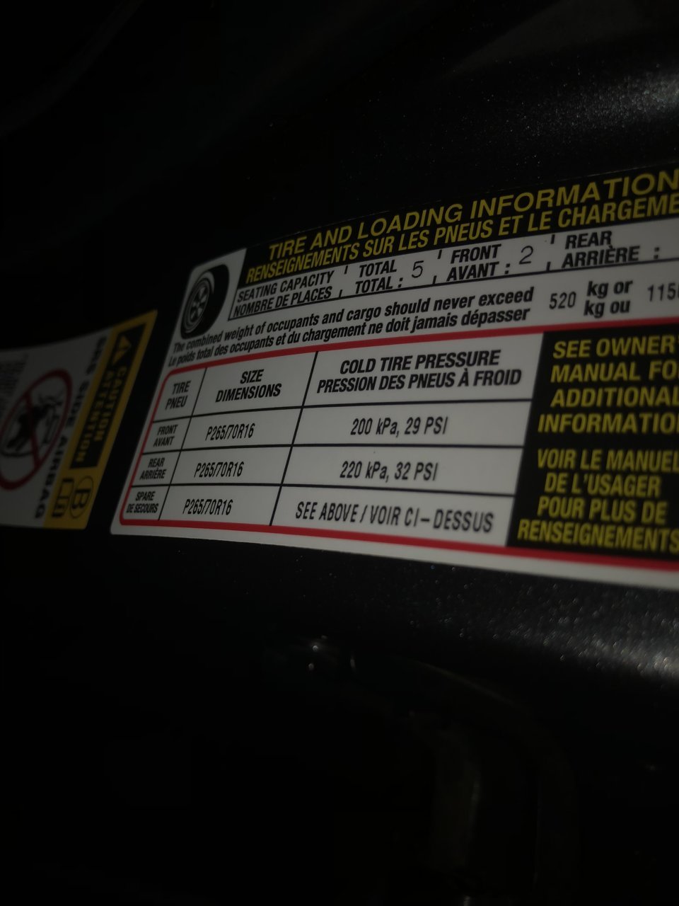

    $hit really the centers wear out with anything higher that sounds crappy i think the tire shop that put mine on put factory pressure in the tires and i believe that’s 35 psi. I ran 40 in my old ko2s and those wore in the center pretty bad but if i didnt run 40 i was getting under steer in the front end and it was wearing away the sidewall.

    Well i was Totally wrong 35 psi isn’t the factory tire pressure but i wasn’t running factory tire size with the ko2s they were 275’s so i ran Them at 35 then the fronts at 40psi 7BE5AB5B-0C31-40D3-8EAD-A0B8CD288178.jpg
