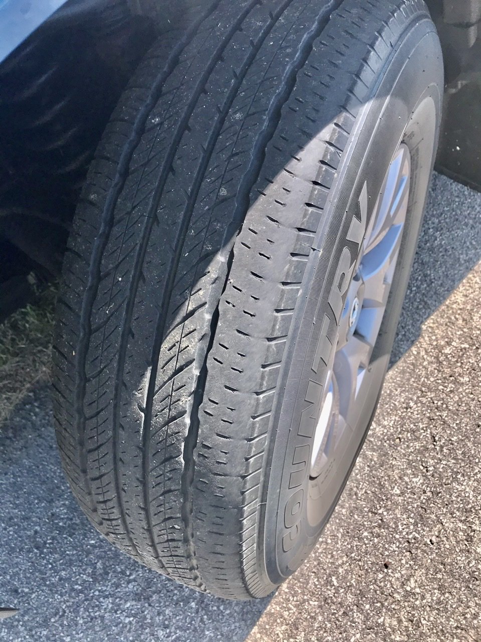

    Info?
    You have 23k miles. Your tire tread life is 50%. They’re also dry rotted.
    In short, buy tires.

    Photo. Sorry Tacoma owners I’m in my late 60’s and not as quick with technology

    The wear on the outside of that tire is horrible, check tire pressure and maybe alignment is needed.
    That's some bad feathering happening there.
    Also rotate tires more often.

    that tread wear is yikes, possible camber issue

    You got some bad wear, as others have said, alignment. But from what I can see of the sidewall (not a lot), i'm not seeing any rot.

    Agree with others, your alignment is no good. Make sure you get it done, otherwise your new tires will look the same in no time.
    I dont see any rot.
    Good luck!

    You need a closeup picture of the front of the tire where the name brand is.

    I don’t see dry rot, but I question your air pressure and alignment.
    There are a lot of videos about tire pressure checks with chalk and it’ll show your contact patch. This is a pretty cheesy video, but it gets the point across. That said, your tires are pretty beat. You would be best off doing this with newer tires.

    There is a manufacture date on all tires. Google how to decode it. I forgot. This dry rot issue has happened to me. We bought a car from Carmax and the tread looked great. Upon closer inspection, I found that the tires were 10 years old and dangerous AF. Carmax replaced them N/C.
