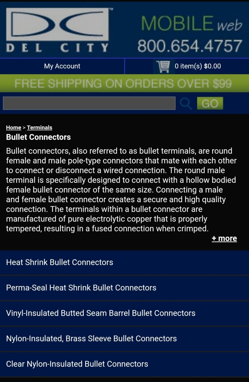

    Hey guys, doing some wiring and trying to keep it simple and stock-like.
    I need a 2 into 1 wire connector something like this -
    Does anyone know of an OEM Toyota connector style like this? If not I can easily install the one above I'm just not sure how weatherproof it is.

    Toyota doesn't have any bullet connectors in their harnesses. The aftermarket has lots of choices for you.

    Thanks guys, actually trying to avoid the bullet-type connectors! Sorry maybe it was poor phrasing on my part. I'm just looking for a 2 into 1 wire connector for the cheap running light mod as a more proper way to splice the wires.
