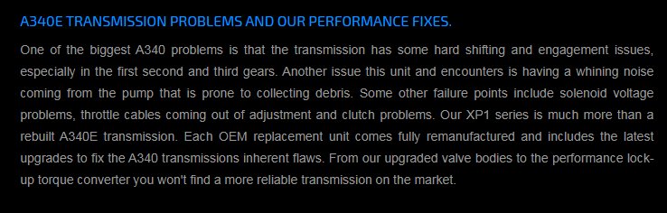

    I purchased a 2002 Toyota Tacoma 4x4 trd automatic a few months back, and have loved the truck so far. However I did notice when I’m driving the truck and when the truck shifts into third anything’s past about 2k rpms the truck shift into 3 kinda hard. The truck has the A340f transmission, and I believe the 3rd gear is a 1.0 ratio, so I kinda thought maybe that’s just normal as that’s a direct ratio. But when I drive the truck easy it shifts into 3rd flawless and can barely tell it’s shift. After a lot of research I’m believing my 2-3rd gear accumulator piston o ring is bad, I believe this is the probably as when I drive easy the pressure should be lower and so transmission shifts fine, but the on the rpms the transmission has a lot of hydraulic pressure so the fluid is blowing past the o ring not allowing the accumulator piston to do its job. Hopefully that all made sense, so my question was does anyone else believe this is my problem, and how hard would it be to replace the accumulator piston, but hopefully it’s just the o ring?

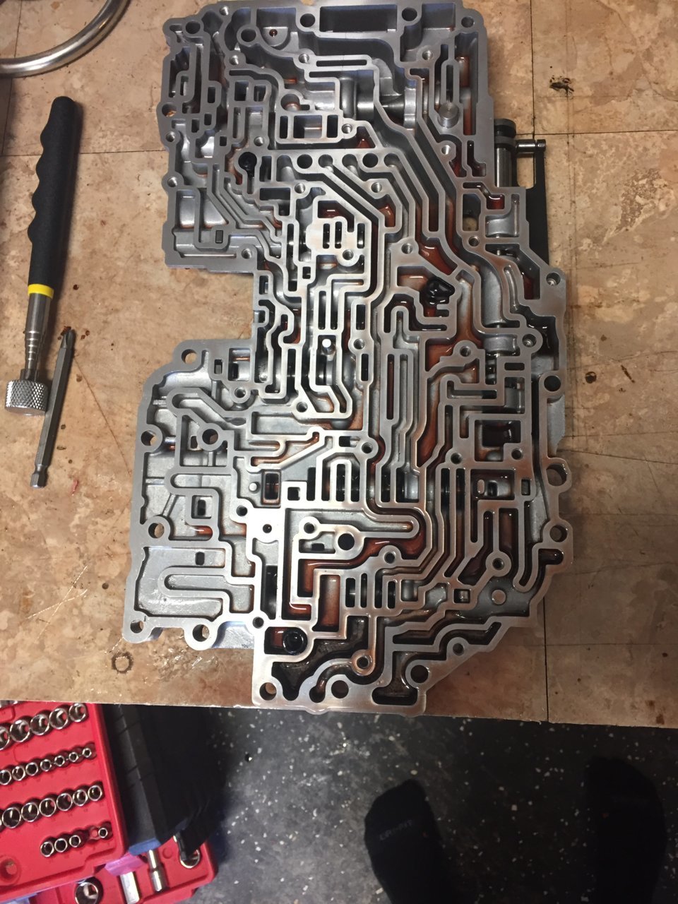

    FF033560-DBE1-47F1-9CDC-D4225233B450.jpg I’ll tell you this
    This TranGo HD upgrade is a Challenge

    It’s not a short order... i’m still in the process ....Let you know if I fucked mine up

    Everything came back together great
    Better shifting
    Better response
