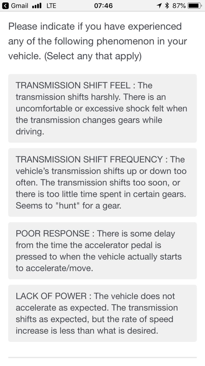

    Yeah, I was told the downshift clunk is normal as well. When the Toyota engineer flew out to drive my truck for the rear diff howl he noted the harsh downshift. He said it’s a software issue and not something mechanically wrong. It’s just a bit annoying at times ha
    I wrote about the harsh downshift in the survey. Never hurts to remind them about it ha

    I would say YES to all, due to the fact that some people are having these problems. If Toyota decided to do a recall the dealer can inspect everything and fixed what is applicable.

    Just filled out my survey tonight. I'm guessing they sent it to me since I took the time to respond to a previous survey they sent me about a year into owning my truck. The survey said it was in reference to my previous one describing drive-ability issues.

    Survey says... basically told them the hunting for gears & low power after coming out of a corner. Gonna look into the latest TSB from my dealership...
