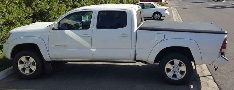

    My 09 Taco got totaled and I bought a low mileage 2012 TRD Sport. It appears to have 4-leaf springs and they don't sag, so I assume the recall has been done. Is there a good way to know without trusting the dealer to know?
    Also, do you folks know if there are there any issues specific to the 2012 model year?
    This truck was supposed to be "Toyota Certified", and have all the updates, but that whole business is a joke IMO.

    Thanks Jack. I did look up the recalls online.
    But how do I tell if the springs on my 2012 were replaced or not?
    Is their some special markings for the recall springs?

    I'd call or visit the dealer... if you had any work done on the truck, they will know your VIN, ask the Service Adviser for the status on your truck's leaf springs. If no work done on the truck, give them the VIN. He'll be able to track it, easier than having you and me both crawl under the truck and look for a number...

    The truck came new from Socal & I bought it used from a Norcal dealer. He claims "all the recalls were done" because it was "Toyota Certified".
    But they didn't do them. I'd need to track down the socal dealer.
