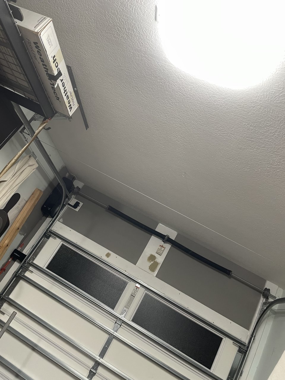

  9. Jun 18, 2021 at 10:26 PM
    baldbeardedtaco
    baldbeardedtaco Well-Known Member
    Sep 4, 2018
    #265223
    3,334
    FL
    18 TRD Sport DCSB MGM
    That’s my opener install
