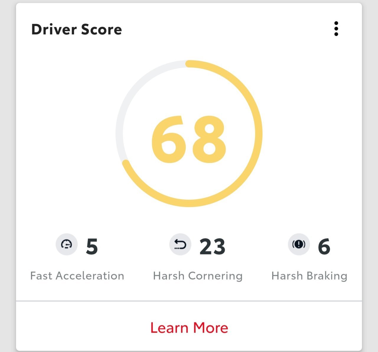

    I just found out my truck had remote start after most of winter is gone. Anyone else consider the amount of data Toyota collects to be alarming? The driver score thing is an absolute joke. I could see this being the future for how our insurance payments are structured. Just goes to show how auto makers are creeping more and more in to our privacy.

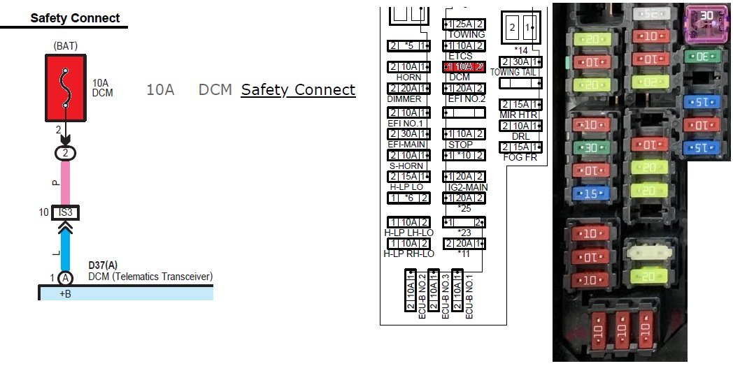

    You can pull this fuse to stop it all.. but say goodbye to your mic;

    So are you saying if I don't want all that information going to Toyota.. and then who knows who else... I can pull that fuse, but I essentially have to give up my phone mic?

    Seriously? Fast Acceleration? In a taco? What is the definition of "fast" I wonder? Going from 0-60 in 2.5 minutes? :rofl:

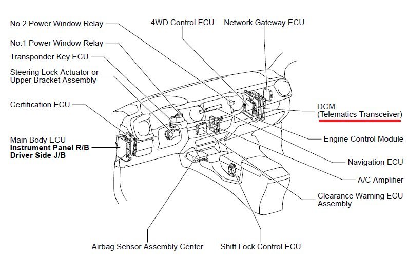

    Exactly. The mic, along with other ‘services’ such remote connect (notice how toyota does not call it ‘remote start’) and in car wifi runs through the DCM unit. It is located here (only on MY19 onward);

    Apparently with my harsh cornering and fast acceleration, I must of took it to the track? I raced a few senior citizens in a dodge caravan and lost :anonymous:
