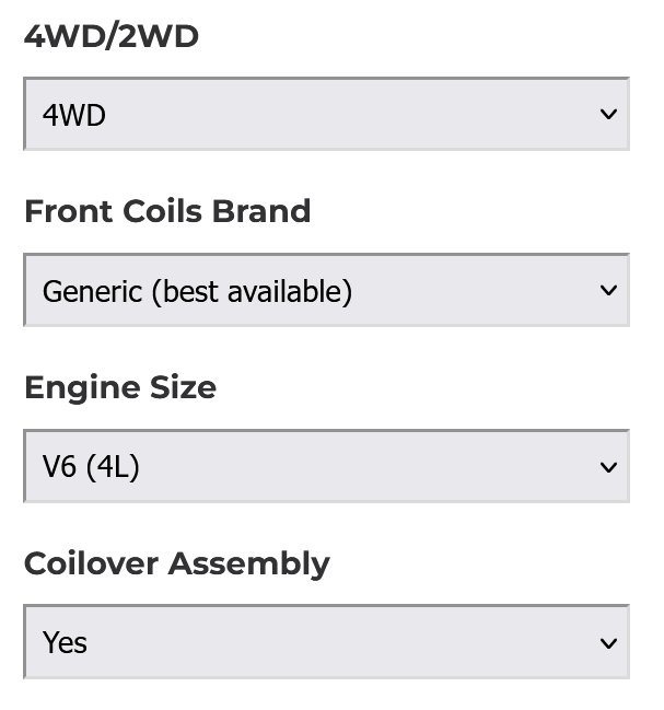

    On Front Coils Brand, is the Generic fine or should i go with OE Replacement?

    This is a new option. When I got mine OE coils were the only option. For a $100 more I would personally go with the OE coils

    Yes, I did not see that option either. OEM all the way.

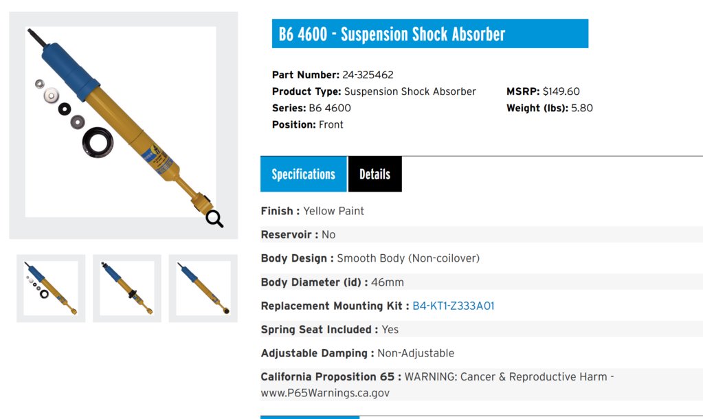

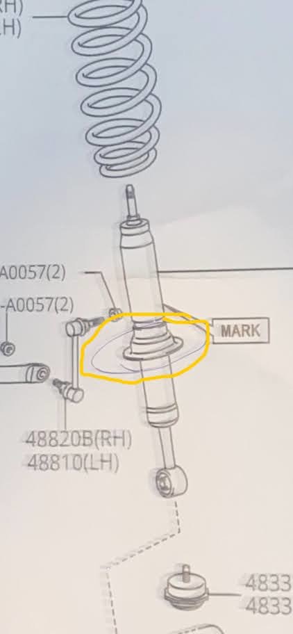

    OK so I think i got most of this figured out, I'll get the top caps for the coils from Toyota, the rest of the bushings should come with the shocks. What i need to know is what is this bottom piece circled in yellow?
    i don't see it on the shock itself from the Bilstien website, unless it that large round black piece.

    It’s the round black piece in your picture. It’s used to set the ride height for the shock in combination with the type of coils that you get i.e. OEM or aftermarket
