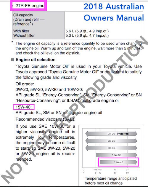

    Toyota is actually OK with viscosities as thick as 15W-40 for both the 4 cyl and V6 aust.jpg

    It's too thick you'll blow up your engine!

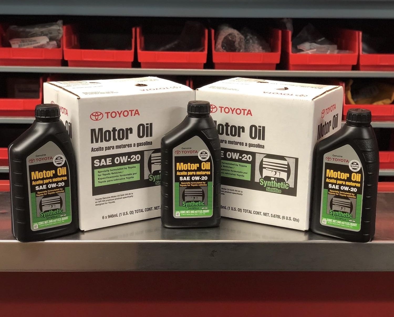

    You're right - the Toyota brand synthetic oil is unique. Even the factory fill break-in oil is unique. Below is some insider information about Toyota's factory fill oil as of 2008 and when to change it (not for at least 500-1000 miles). This insider information was provided by a Nippon Oil sales rep on another Toyota forum back in 2008 who wrote:
    "Just FYI, the factory fill 0W-20 for the 07+ Tundra are fully synthetic. A small portion of the 0W-20 is made by Mobil while the rest are made by Nippon Oil (whom I work for)."
    "Toyota doesn't require synthetic oil for subsequent changes I believe, but it definitely comes with it from the factory. In fact, quite a few Toyotas come with our 0W-20 from the factory.
    "We don't make the 0W-20 provided to Toyota available for sale to other car companies. It probably is a formulation licensed to Toyota and thus only they have the rights to it."
    "This is pretty common. For example, the new GTR coming from Nissan uses exclusively a gear oil our company created for them. But it is only sold to Nissan and no one else, so you will not find that product in the product section of our Nippon oil website."
    "Previously manufacturers did not recommend breaking in new vehicles with full synthetic oil due to how smooth it is that it will not property break in the motor. But the 0W-20 full synthetic provided to Toyota at factory fill is a special formula created for Toyota, so it will allow proper break in."
    "Yes, I do work for Nippon as mentioned previously. You don't have to believe me, just take it as someone's opinion if you don't trust who I am. Not ALL of a car manufacturer's oil comes from one company alone. However, all the 0W-20 coming from the factory as well as the red bottle genuine oil are produced by either Nippon Oil or Mobil. They are produced for Toyota, so it's a Toyota product, not a Nippon Oil branded or Mobil branded product. You will find a Mobil 1 (Mobil brand) 0W-20 as well as our own ENEOS 0W-20 (Nippon brand). You are right though, different Toyota manufacturing plants are supplied by different oil companies. I believe we supply a majority of the plants except the one in South Carolina (not 100% sure on locaton). That one is Mobil."
    If you JUST purchased a new Tundra, you probably shouldn't change out the factory 0W-20 for ENEOS 0W-20 for at least 500-1000 miles. The reason being our ENEOS 0W-20 is of higher grade and is extremely smooth, so it will be difficult to break in the motor properly."
