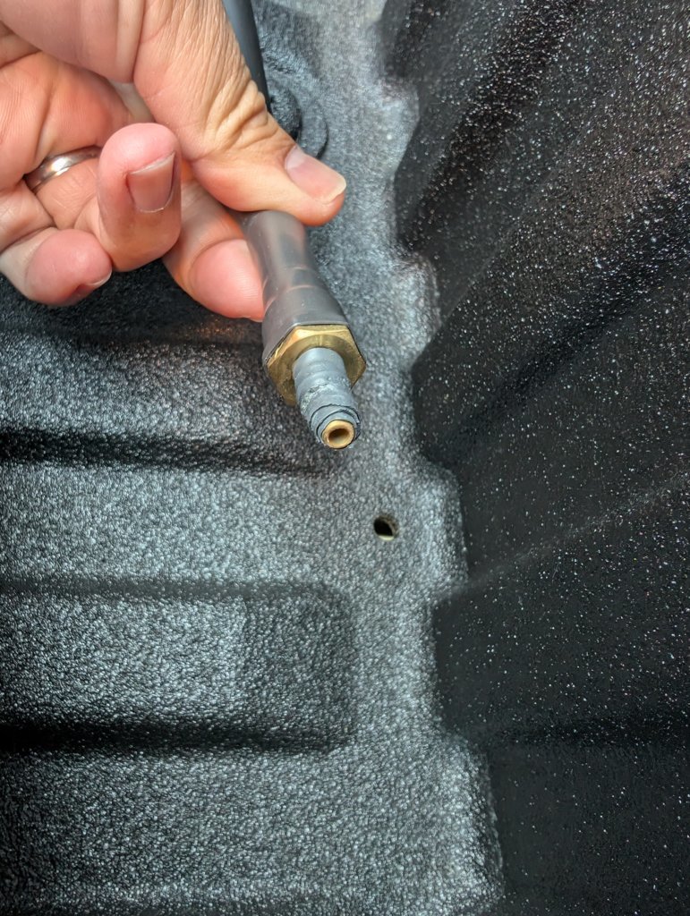

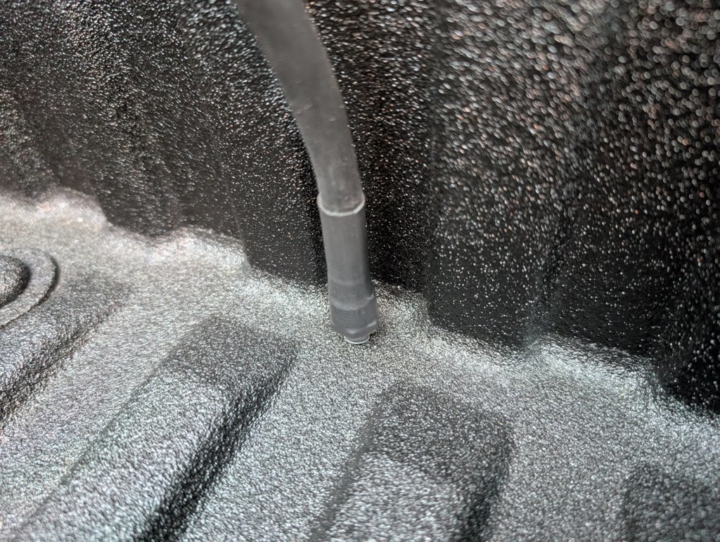

    I bought little brass reducers and used shrink tube to attach to the hose. Works great and I didn't have to enlarge the hole on my bed.

    Not a bad idea. Wonder if reducing the diameter so much will cause them to clog easier? I guess they are easy enough to pull out and check/clean once in a while to be safe.

    I have pulled them out several times over the last few months and it has been nice and open... But we don't get huge amounts of rain/debris here in the SF Bay Area.
