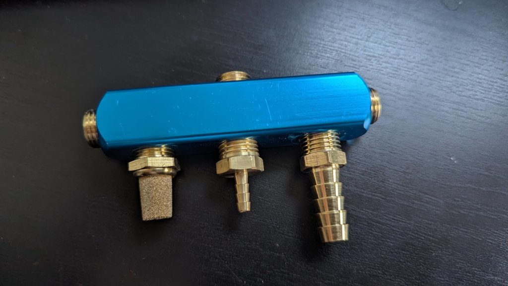

    I'm working up a scheme for the two breathers under the hood using one of those sintered brass filters. Its overbuilt for sure.

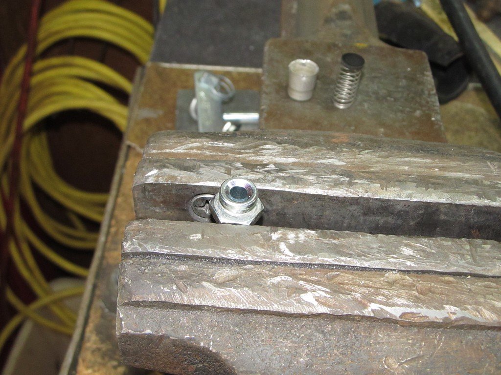

    You should go take one apart.
    There is indeed a small spring, and a rubber disc inside there. The spring keeps very light pressure on the rubber disc inside the valve, thereby allowing light air pressure to escape, but sealing when no pressure (or a vacuum) is present.
    You can see the cap, spring & disc in the background in this pic of a rear valve (the one from my front (the part in question here) had the same spring & disc in it):

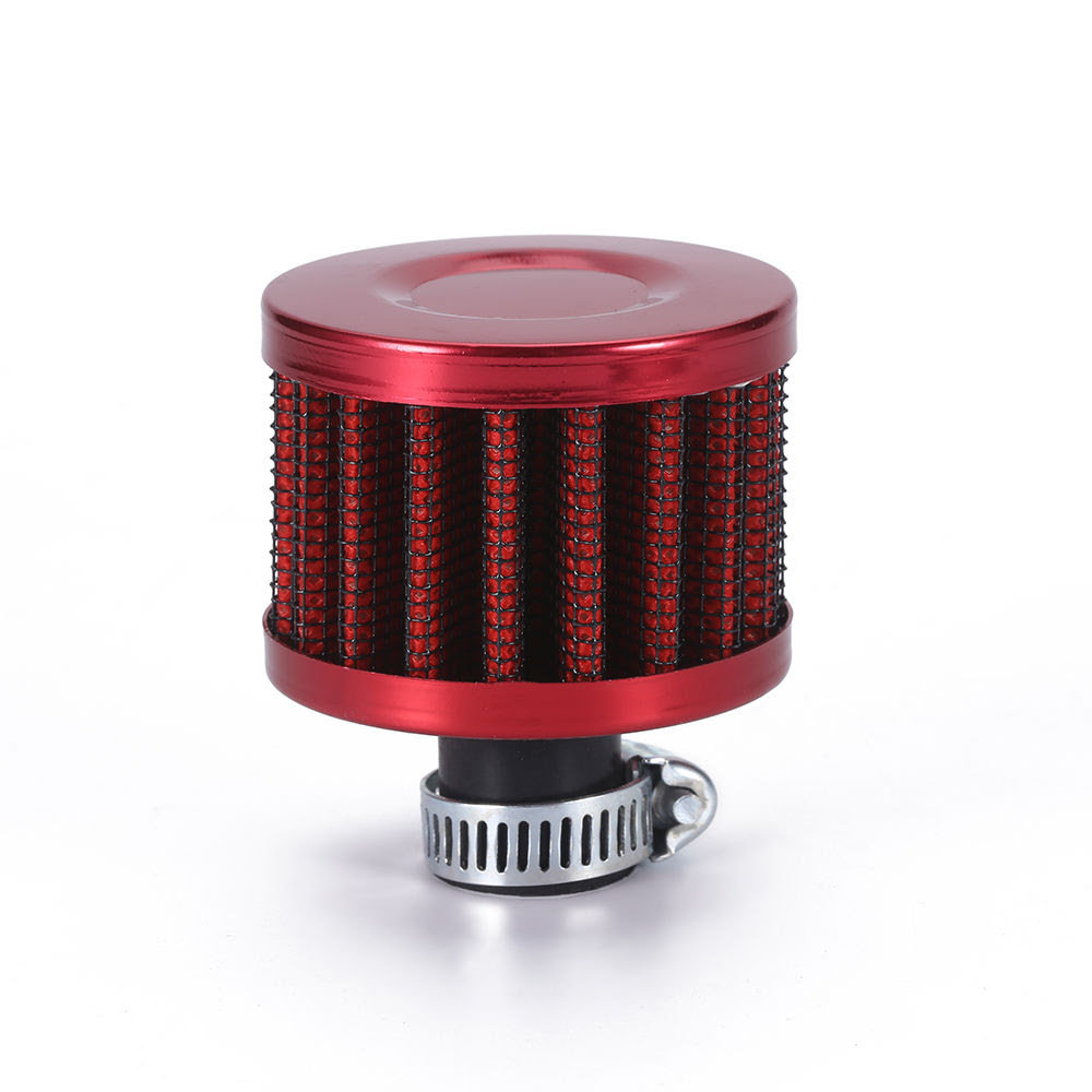

    Personally I am going for way overkill on the diff breather and recently picked up a 12mm intake filter off aliexpress to slip over mine. Kind of big but should keep the dust out. I am going to place the breather behind the bed inverter outlet to give it some splash protection. Havnt decided if I am going to pop the metal cap off first or not. Only cost like $3. If anyone is starting from scratch they could just go with a hose coupler instead of bothering with the toyota breather if doing this.

    The original breather is constructed like this but I ordered Toyota Breather Plug - 90930-03136 from my local toyota dealership and it only consisted of a plastic hose barb and a metal cap. I did disassemble it.

    Well I'm sorry if I'm missing exactly where you are placing the filter. But if you fit it remove the cap and place the filter over breather directly on the axle don't you think water could enter the dif ? The hose extension kit look way better imo.
