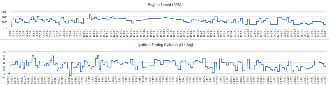

    This was my drive in this morning - @OVTune is this the type of correlation you'd be expecting? I think many feel a little "slip" when accelerating but this morning mine was pretty smooth.

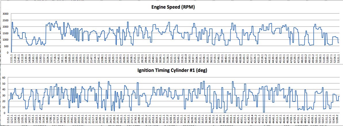

    And here's a good comparison of my engine speed vs. ignition timing BEFORE I replaced my CKP sensor. Same drive, though it was a bit more congested this day, same temps / pressure:

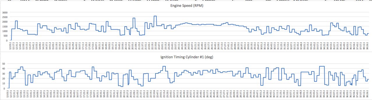

    This morning, while the truck was still driving pretty decent the steering was "heavy" again and it felt slightly more bogged than it has the rest of the week. Interesting to see the correlation from the same drive yesterday re: ignition timing. Lot's more variability even when cruising around the same RPM vs. yesterday. Also recorded a misfire toward the beginning right when timing was @ 50 degrees (it's peak timing for this trip)
