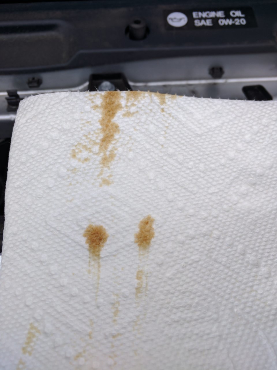

    Does this look like new oil?
    Looks awfully brown for 5k service to me.
    Paperwork from dealership reads 5k synthetic service.
    Oil cap doesn't look touched (no fingerprints).

    5k is a rotate only.

    I think some tech got your oil for his vehicle and paid for changing yours.
    Or someone marked the paperwork wrong trying to make you happy. Because 1st change is slated for 10k.

    The "5k Synthetic Vehicle Service" means they are servicing a vehicle that takes synthetic oil, not that they changed the oil. 10k is the regular oil change interval.

    Color means absolutely nothing with Synthetics. 10K is normal oil change interval.

    Not that color means everything/anything, but I think that looks pretty dang clean for 5k miles!
