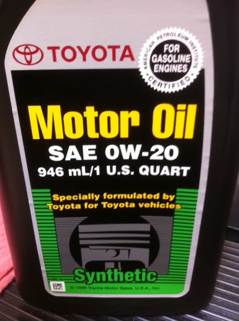

    I'm a tech at a Toyota dealership and I can sum all this confusion up for you. Heres the deal, the only cars Toyota ships with syt oil run the 0w20 oil. All others come with conv oil. You can swap to syt if you want to in any of them but toyota syt oil only comes in 0w20 so if they put that in your 4.0L that is not good, that stuff is way to thin for it. You want to run syt 5w30 oil and you will need to go aftermarket for that because toyota does not make that. They will most likely try and sell your mobile 1 or castoral at some crazy $9-$11 a quart price. The problem is that 99% of people at the dealerships do not fully read the info toyota sends out about this stuff all year when stuff is updated, they just schim threw it. Toyota isn't the problem, its the lazy people at the dealerships you guys are going to. Also, as far as oil change intervals go, both tacoma motors, L4 and V6 have 5k oil changes, even though the new L4 takes syt. All the other toyota vehicles that come with syt are designed for a 10k oil change. I'm going to put either amsoil or mobile 1 syt in my 2011 taco when I do my first oil change. I would not recommend extending an oil change though, plenty of people do it without issues but personally I don't like the thought of it being in there that long. If you want to run syt and bring it to a dealership my suggestion is to buy your own oil and bring it and let them do it with the toyota filter. But do NOT run 0w20 in the 4.0L V6.

    Did you read the whole thing and just look for something to dispute me on? Clearly I meant toyota brand oil, I don't know who physically makes the shit. It comes in a toyota bottle and that's what dealerships carry.
    This is the sythetic oil that toyota "makes" and so any other weight sythetic they use is not going to be toyota brand. Most likely mobile 1 or castoral.
