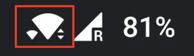

    Most devices like this will establish a bluetooth connection and then a separate wifi connection after they connect. Wifi allows for more data to be passed with less latency. That is why wireless AA and CarPlay use your phone to create a wifi signal (like a hotspot) that the head unit will then connect to. Again, I don't have an Iphone or Garmin, I am just going off what I have read and seen from other devices.
    By chance when you connect does this symbol show on your phone?

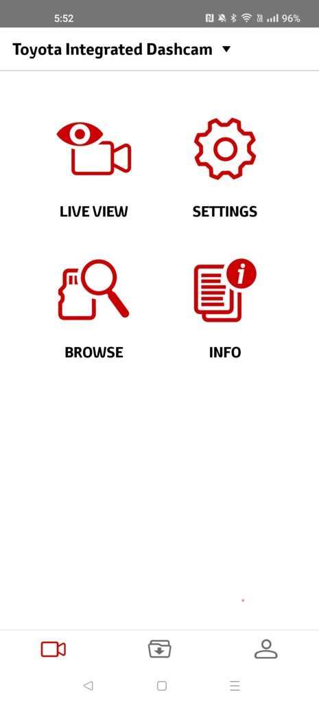

    No, I get this:
    TR, I got it to replicate connection issues. I can replicate reliable connection several times doing this:
    Turn off bluetooth on your phone. With vehicle ON, go to the head unit display. Disconnect bluetooth for your phone in vehicle settings. Press and hold the wifi button on the dashcam for two seconds. Wifi button will flash blue and chirp. On your phone open up the Toyota camera to set up wifi. You should be able to connect.
    Disabling bluetooth at both ends seems to work reliably for me.

    I was asking as a quick search showed that the one plus 8 does have a dual WiFi antenna where you can connect to multiple Wi-Fi signals. I figured that's what would make Android Auto and the dash work at the same time.
