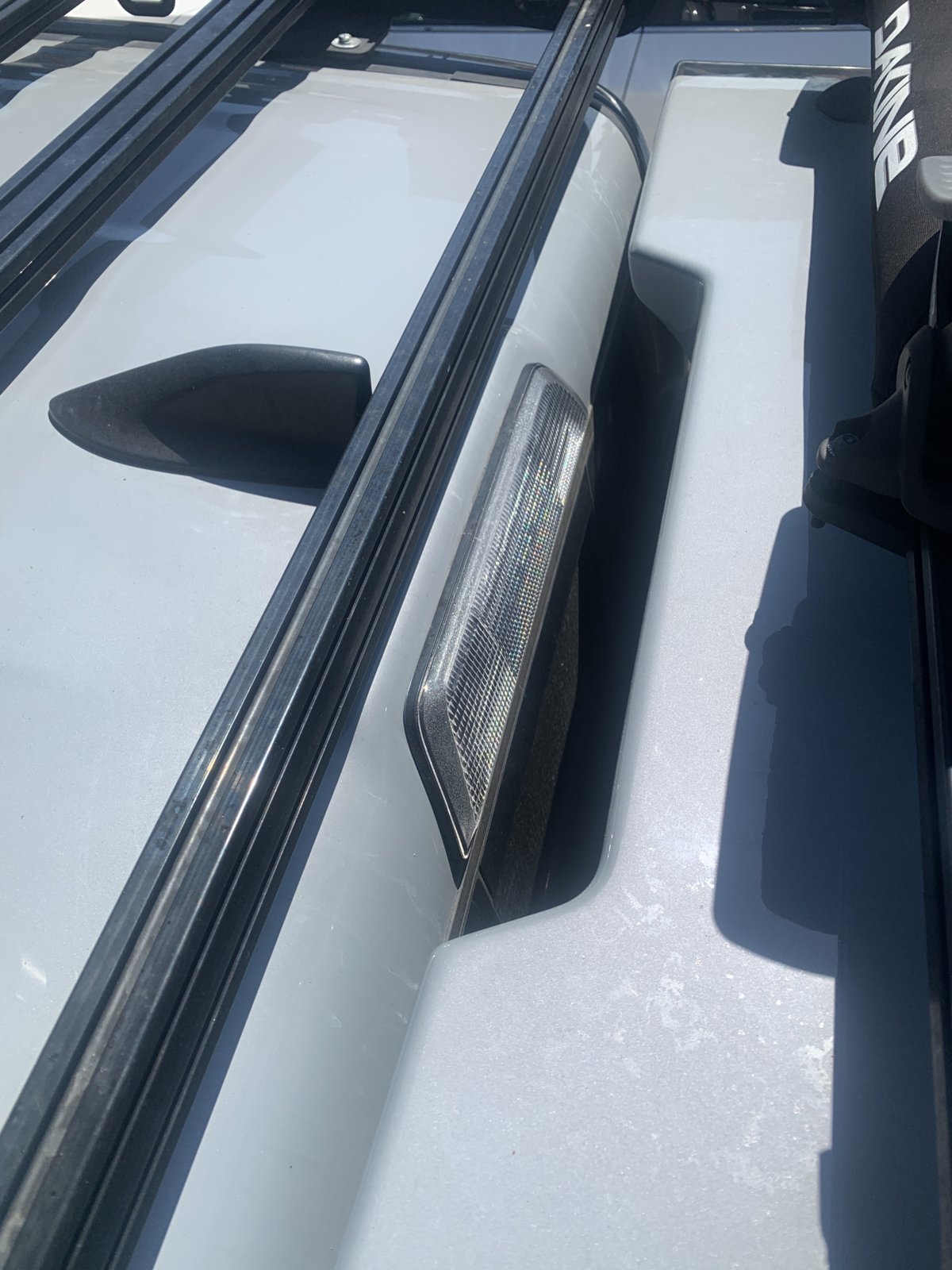

    Toyota denied doing the recall fix to my 3rd brake light on my 2019 tacoma. They originally asked if I had a camper shell on the truck. When I said yes, they told me that it would have to be removed in order to do the repair. My shell is siliconed and completely sealed to the bed. When I told them the shell is absolutely not coming off and that the 3rd brake light is easily accessible due to a cutout in my shell in that area allowing for the access to the light, they asked for pictures. I emailed the Service Manager the pictures showing the clearance. They told me they had to get approval from management in order to perform the fix while still having a shell on. The service manager said their tools would have trouble fitting in the space but he was confident they could get it done. After all that, I schedule my appointment, drive the truck/drop it off. 30 mins later I get a call asking if they can remove the shell or unbolt it and slide it back a few feet. Uh....what?
    I again told them again do not do that, it's silicone sealed and I have stuff mounted to the bedrails that would prevent them from simply "sliding it" it down. It would have to be picked up and removed. Absolutely not. They refused to do the work, so I ended up just picking my truck back up with zero repairs done. Looks like I'll be handling the repair on my won since apparently I am more capable than the Toyota service techs.
    Question:
    Has anyone actually done the repair themselves or seen what is actually done. I'm trying to see if it's a gasket that is being replaced or are they just removing it, adding some silicone and putting it back together. Another question is would it be better to just order an aftermarket 3rd brake light with all new parts, and silicon that one properly to start fresh. Any help is much appreciated. Thanks guys!

    They apply silicone around the outside of the light. Applying that silicone and ensuring it's a good seal would be difficult with a topper in the way obscuring the technicians vision. If I were the service manager I would have asked to remove the top as well, due to not being able to guarantee the quality of the job with the top on.

    Yeah thats not gonna be sealed correctly without removing the cap. You can do it yourself but you'll probably end up smudging the silicone or having it drop beneath the light.

    There isnt silicone between the shell and bed rails....there is the normal foam....but the front openings and any and all other openings around the shell have been filled and sealed. If removed...all of this would have to be redone as well as the chance of them damaging something trying to do so. If they cant handle a simple light repair, I for sure don't trust them with the shell and everything else that comes with it. I've watched plenty of videos of replacing a 3rd brake light and it can for sure be done without removing the shell. I'll probably have to access it through the removable front shell window and from above the shell, but it can for sure be done.

    You can probably replace the light, but that's not the work approved in the service bulletin. The service bulletin is to seal the existing light with silicone and add a new trim ring. The official work requires full access to be able to apply the silicon and trim ring properly.

    As an interim fix I applied Lexel sealant around the top and sides of the light. If you do that leave the bottom clear so that if water gets behind it can still drain. I'm not sure exactly what the official fix is. I heard that they put a new gasket on which is more robust than the original but some others in this tread mentioned that they just silicone it on. Either way although removing the topper isn't ideal its better than having unwanted water entering the cab.

    Denied is honestly the wrong term here. I had the recall done with a cap in place. Guess what it had to move. I just bucked up and re sealed the 2 front openings after. Took 15 minutes. You have an aftermarket component that is blocking the affected area that needed repair. You didn't want to work with the dealer to make it accessible for a tech. After working in a dealership and watching the morons that complain snd blame techs for everything I wouldn't go near trying to do that job with a cap on simply for the liability issues of oh you scratched it now you gotta paint it. All for a warranty job that pays the tech so little it might aswell be nothing.
