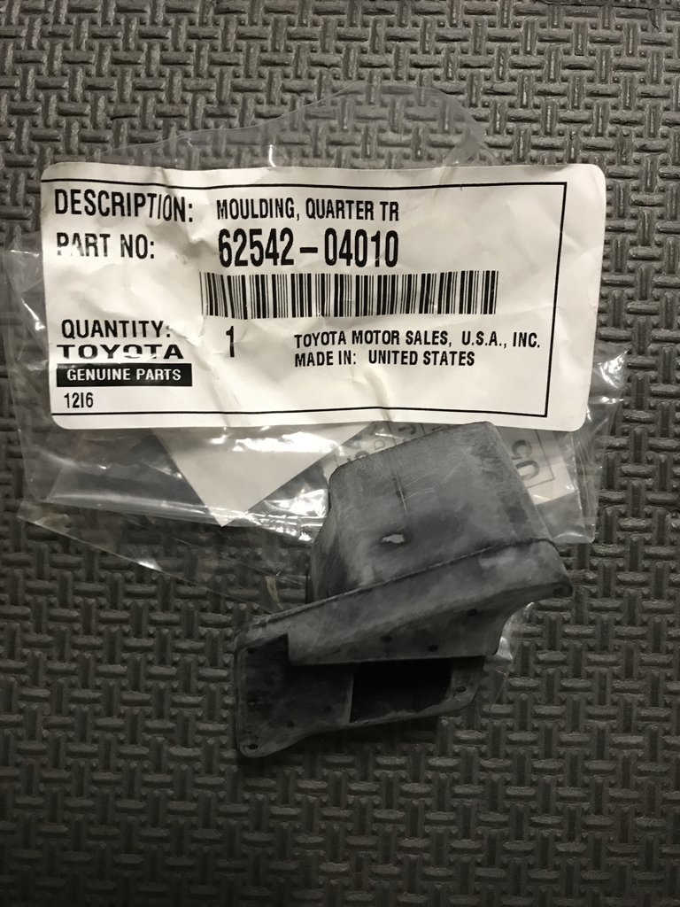

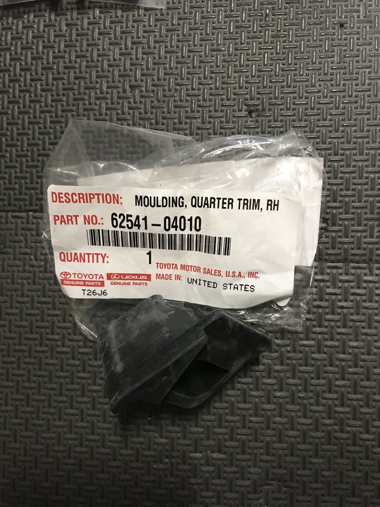

    Are the little rubber pieces in place on the corners near the cab?

    Which little rubber pieces? Photo please?

    Thanks a million for taking the time to post these photos. Where do these pieces go? Were they supposed to come with the OEM tonneau cover if my truck came with one?
    Again, thanks so much!

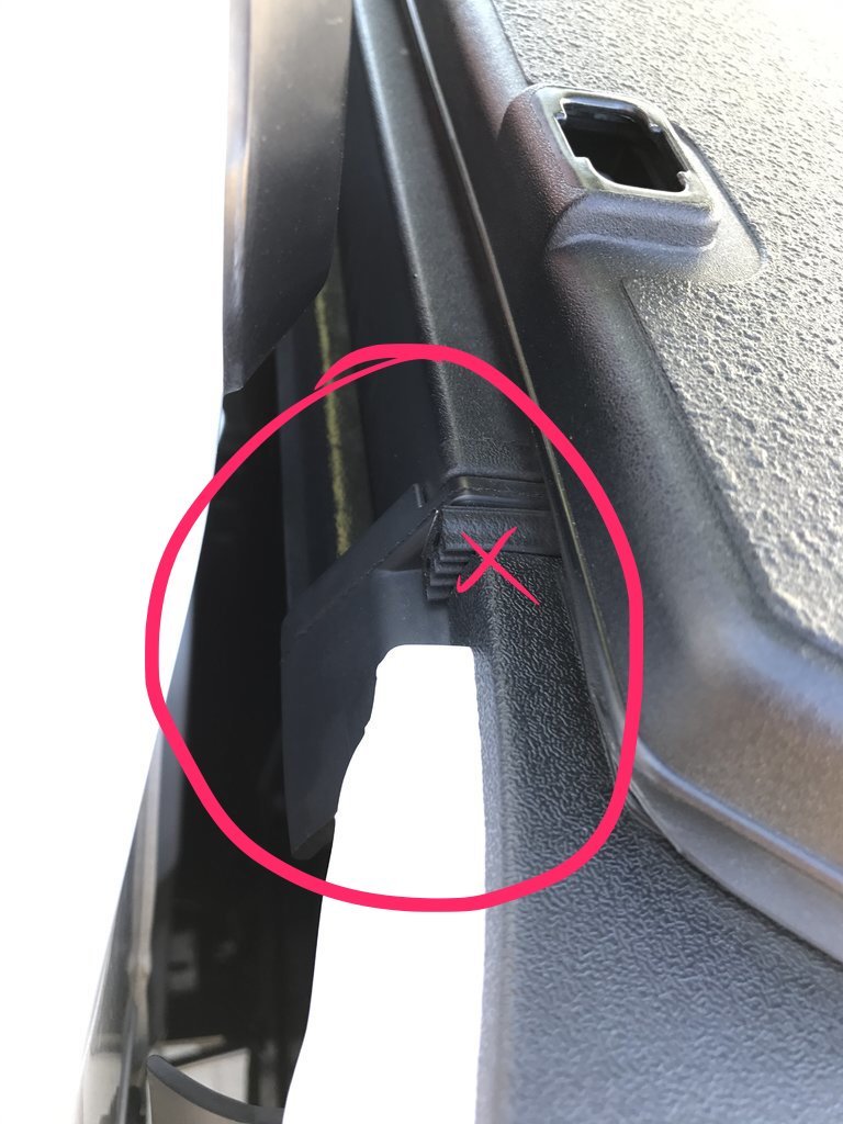

    If they were installed they should be up where the side rail meets the header rail up by the cab. Some daylight still shines through, but not as bad without these.
    Not my picture. The circle shows the gasket. The x is where the light comes through and someone put a small piece of rubber to help.

    Yes mine has the rubber things in the corners and yes I do see daylight where the X is in the picture. I don't expect no water what so ever but mine is letting a lot of water in. Hope it rains this weekend so I can post some pictures.

    I used windshield caulk there...no daylight
    This is passenger side, circled pick above by other cp would be drivers side
