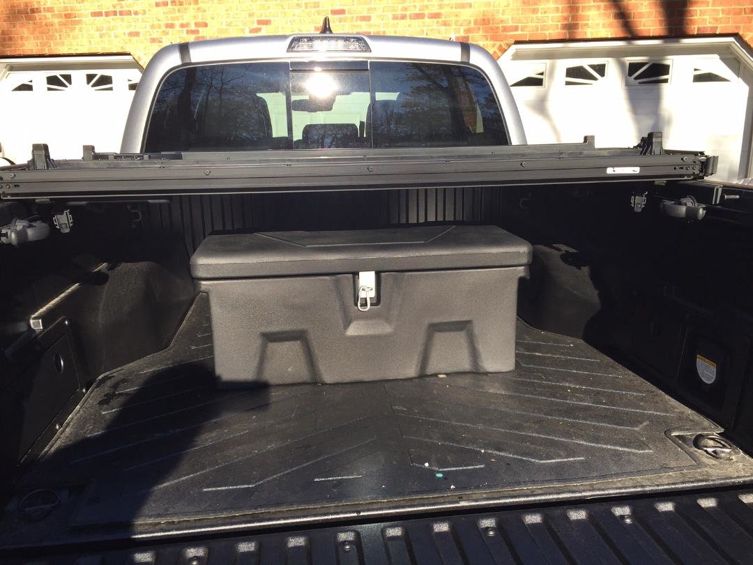

    My '18 TRD Sport OEM cover leaks very little as well. Below is morning after about 8 hours of steady rain.
