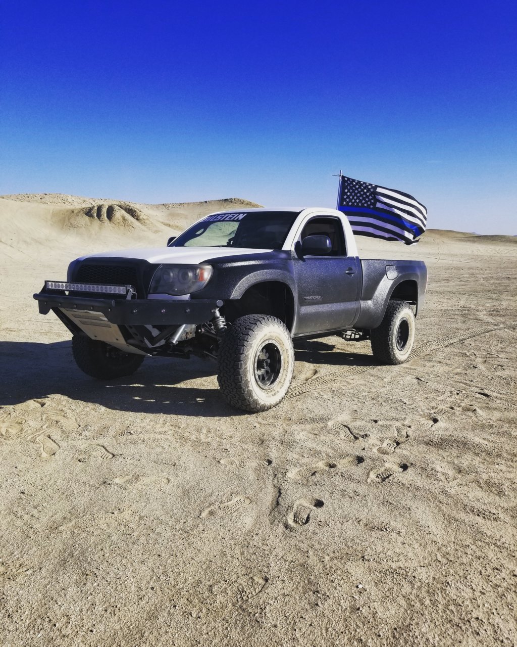

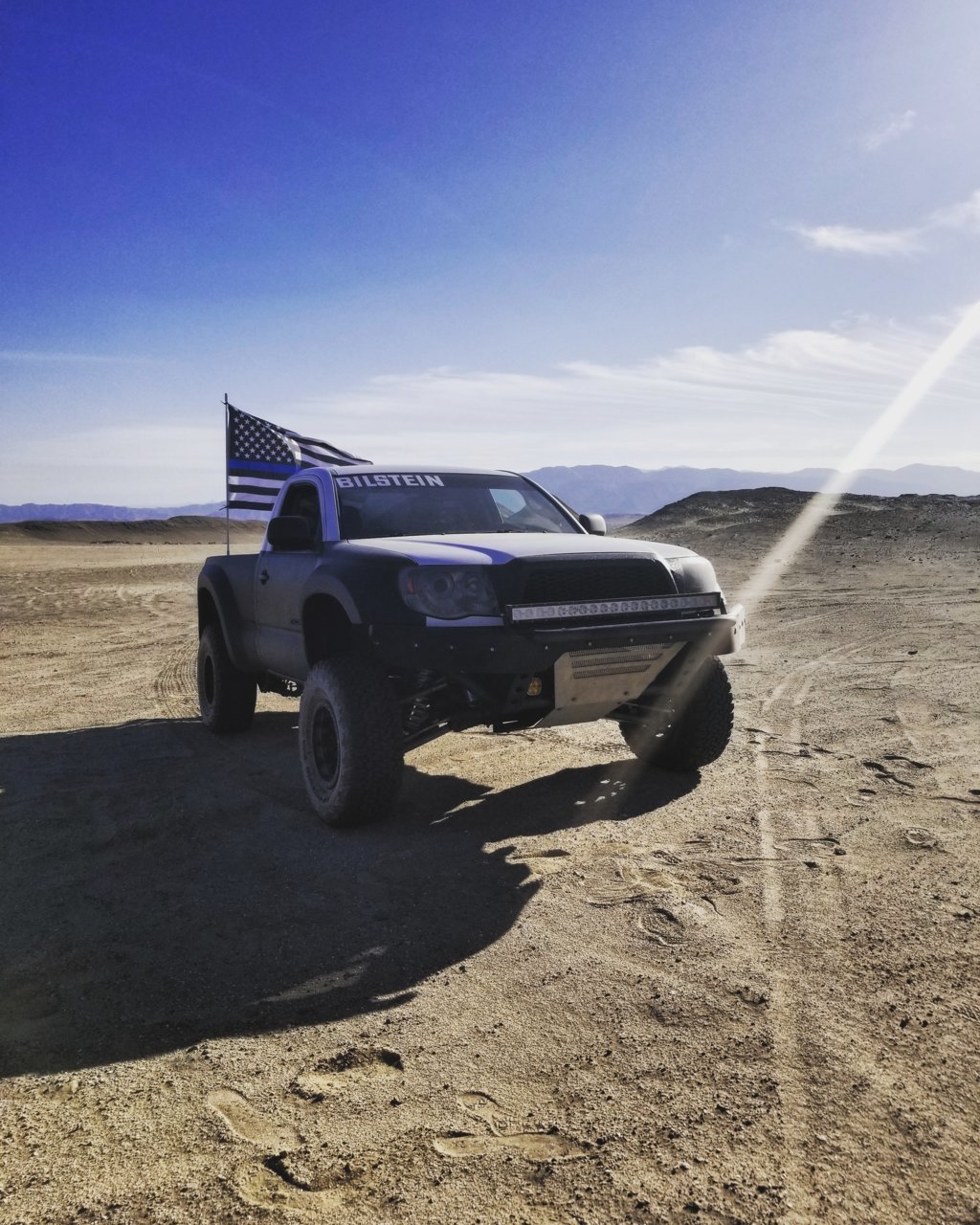

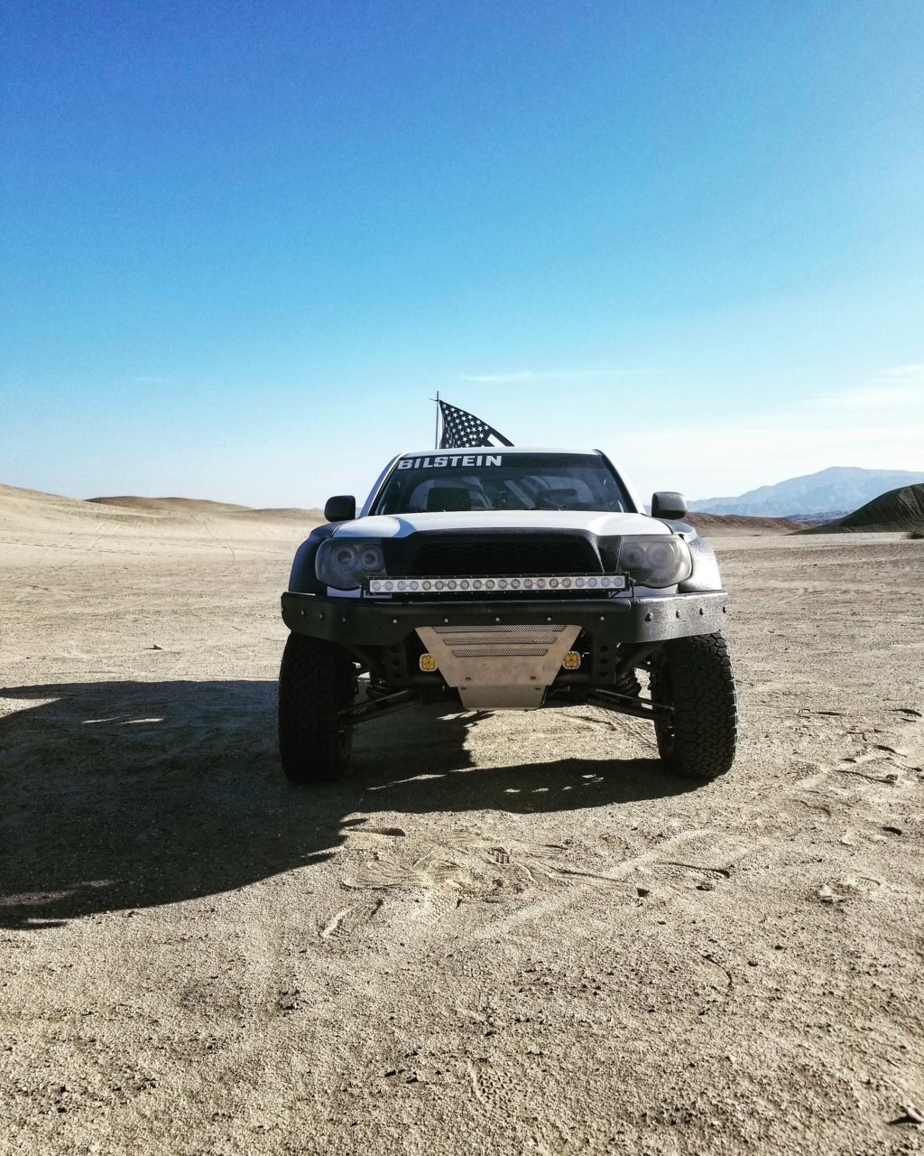

  8. Sep 4, 2018 at 1:28 PM
    #248
    dillonk1602
    dillonk1602 Well-Known Member
    Apr 2, 2013
    #101176
    1,031
    dillon
    san diego
    tacoma 5 lug
    Vehicle Modifications: TACOMA 2007 FRONT TOTAL CHAOS 5LUG ,LONG TRAVEL KIT 13" OF TRAVEL KING COIL OVER (550 POUND SPRING RATE) (18 INCH COIL) REAR BED CAGE 16" SMOOTH BODY FOX SHOCKS 2.5 2.0 / 2.5 BUMP STOPS FOX ICON ADD LEAF PACK WITH OEM SPRING 11" OF TRAVEL TRUCK COMES SPRING UNDER BY MANUFACTURE TOYOTA REGEAR TO 4.0 WITH AUBURN UNIT ENGINE 2TR-FE WITH AFE COLD AIR IN TAKE DOUG THORLEY HEADER MAGNAFLOW EXHAUST TIRE S NEW KO2 32/11.5 METHOD RIM 15" WITH -20MM OFF SET

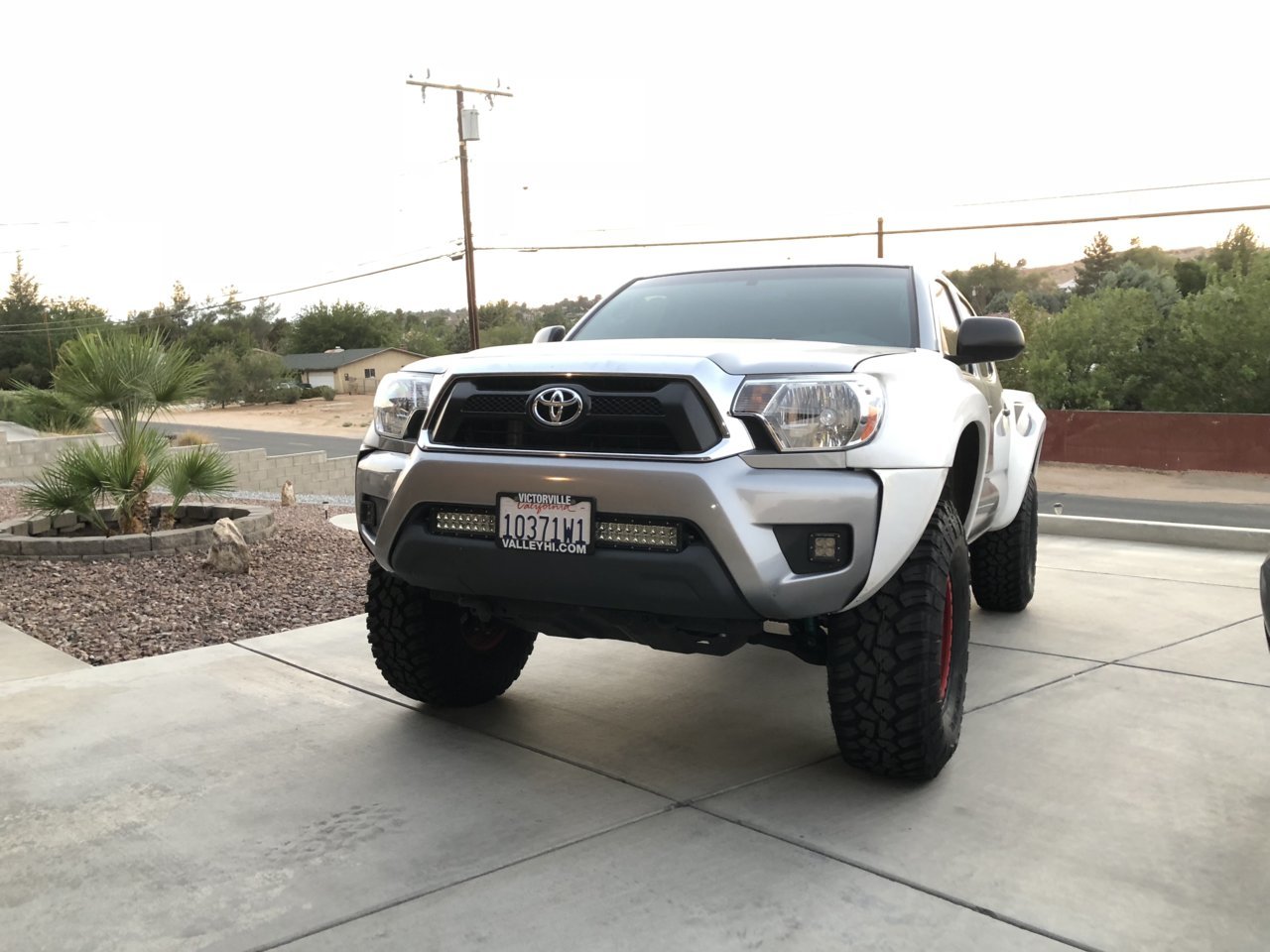

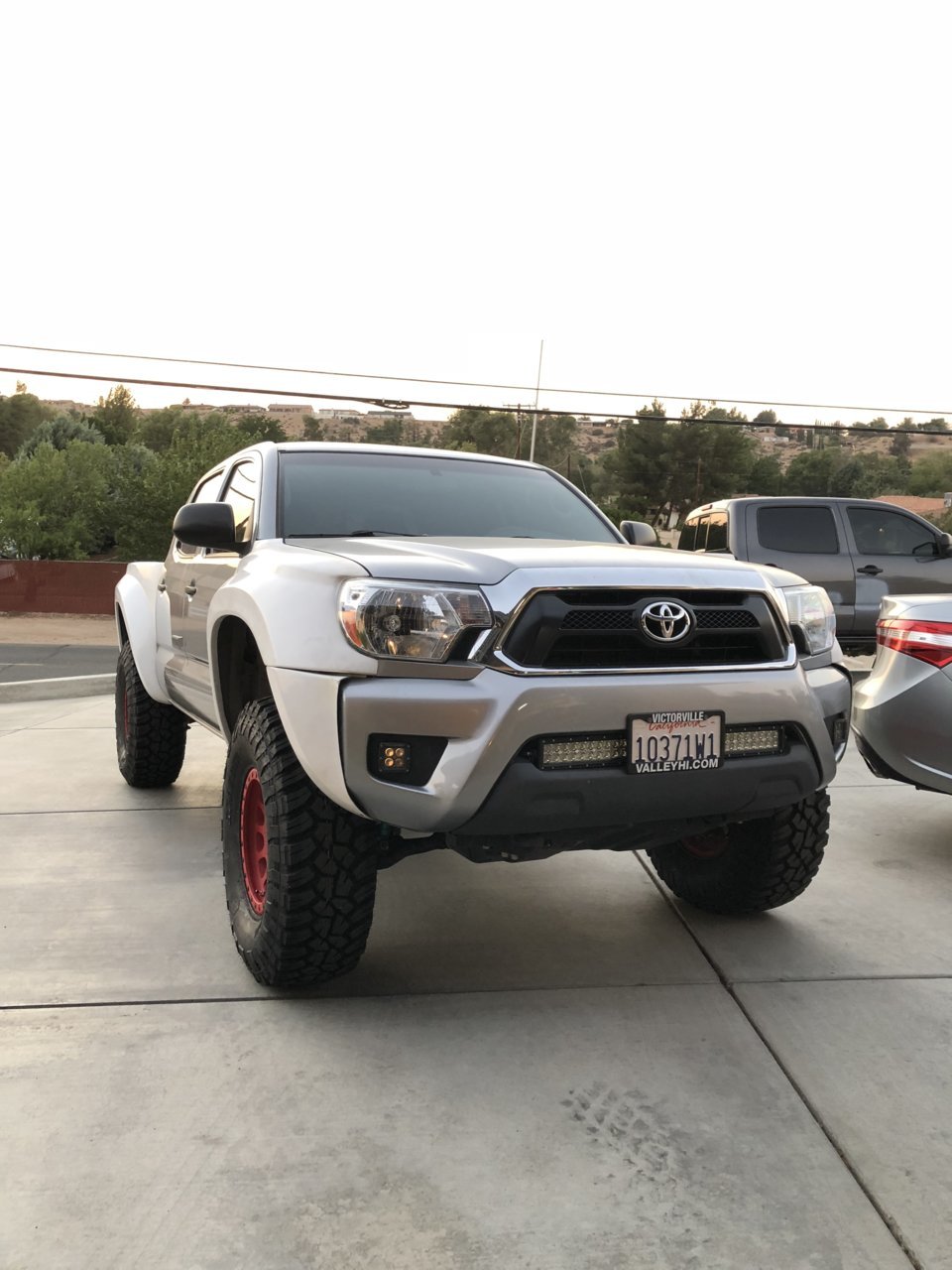

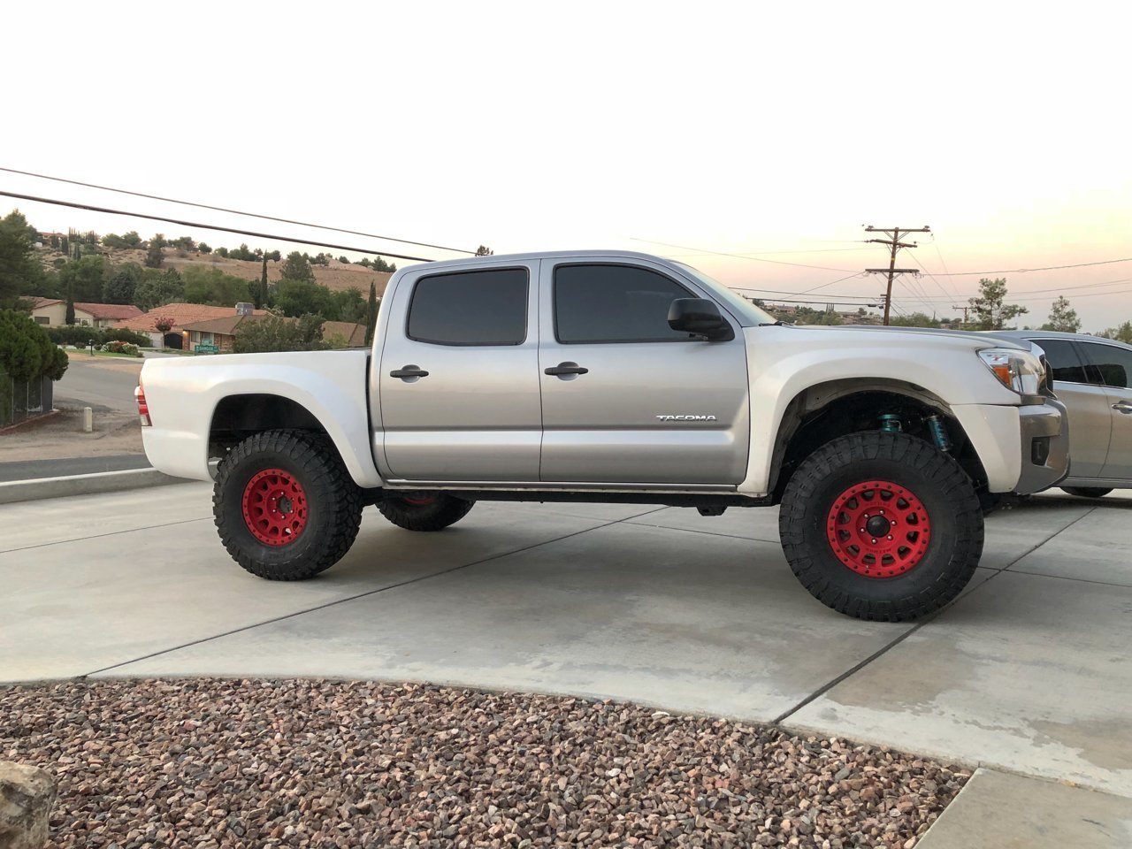

    TheBirdDog24
    TheBirdDog24 New Member
    Oct 3, 2018
    #268209
    3
    2014 Toyota Tacoma TRD
    What kind of suspension are you running on this? This looks almost identical to what I had in mind on one I’m trying to build.
    Running Board Man likes this.
  15. Oct 5, 2018 at 8:13 AM
    #255
    Coot83
    Coot83 DORKEL NATION
    Aug 9, 2016
    #194134
    13,250
    Scottsdale, Az
    2012 Baja TX
    TC 3.5 LT, RCV axles, Demello sliders, BD light bar/fogs, LP6, DMZ rear, SOS skids, custom bumper, King 16" triples, Locked-on hydro rear bumps...
    My guess is standard 2.5 kings. With wheel spacers and a good offset they match up pretty well with the fenders.
