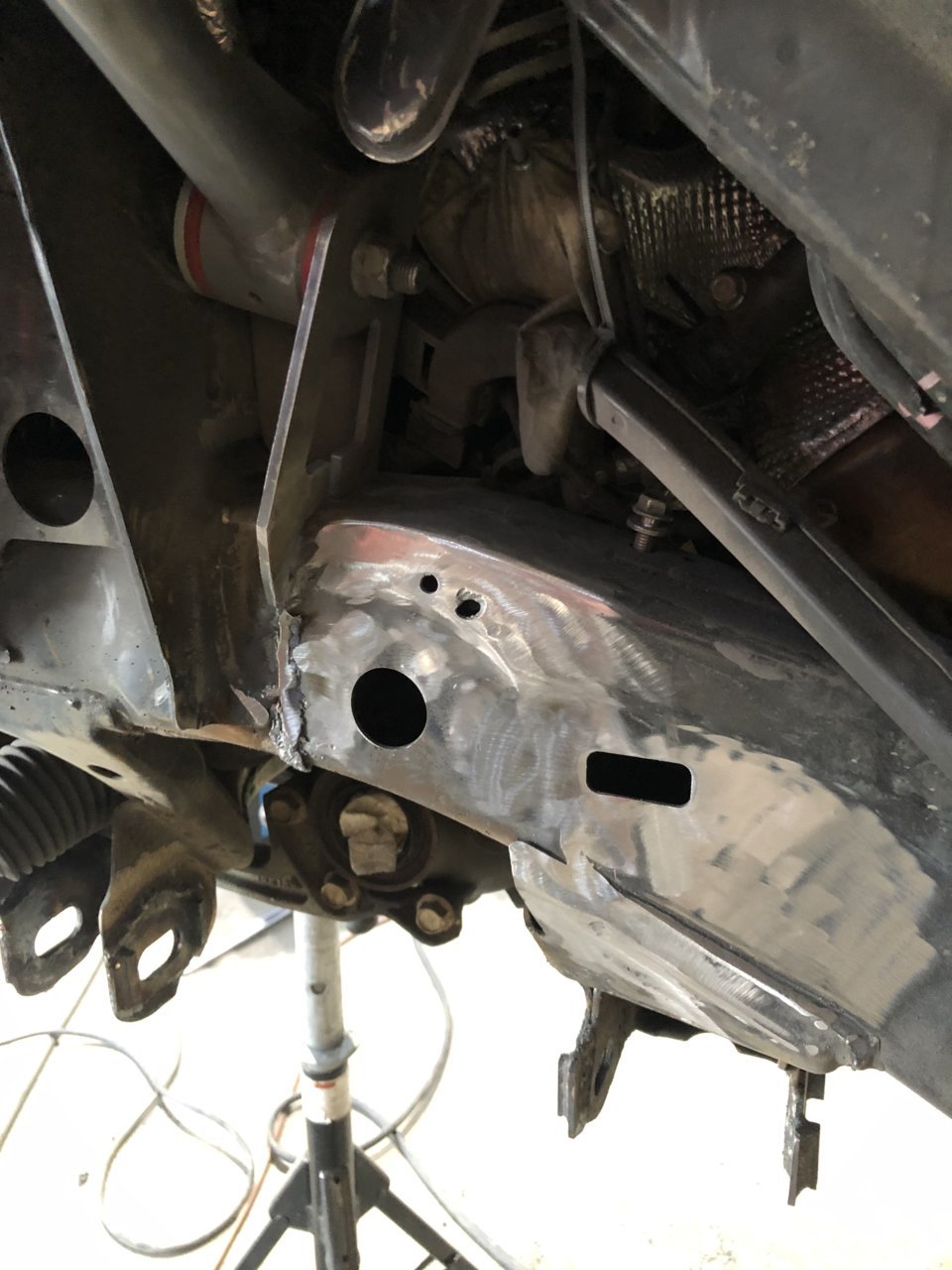

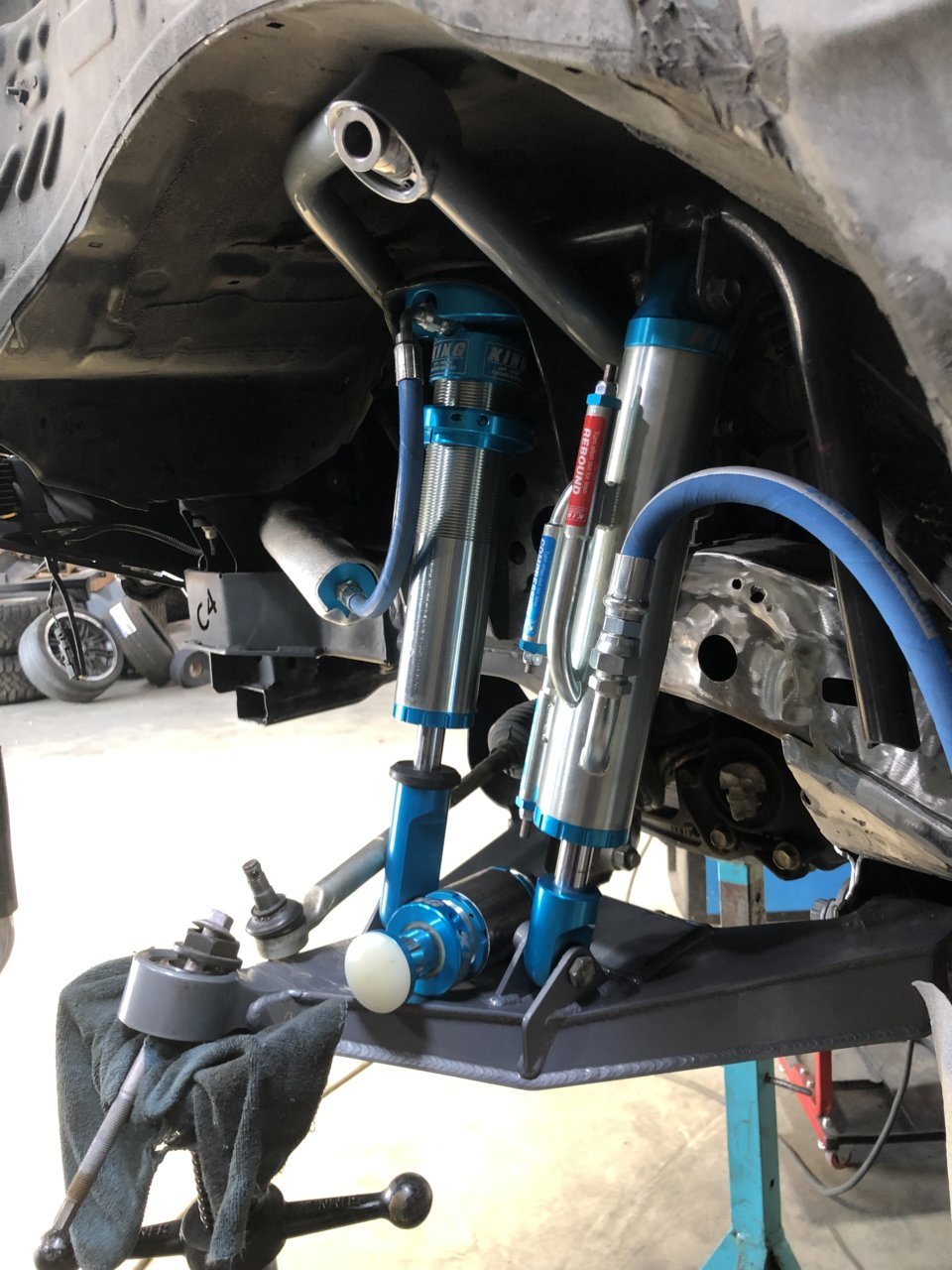

    Front was a PITA. The bumps were contacting the bypasses, So had to torch the entire bracket off and fab some new ones that hugged the frame tighter

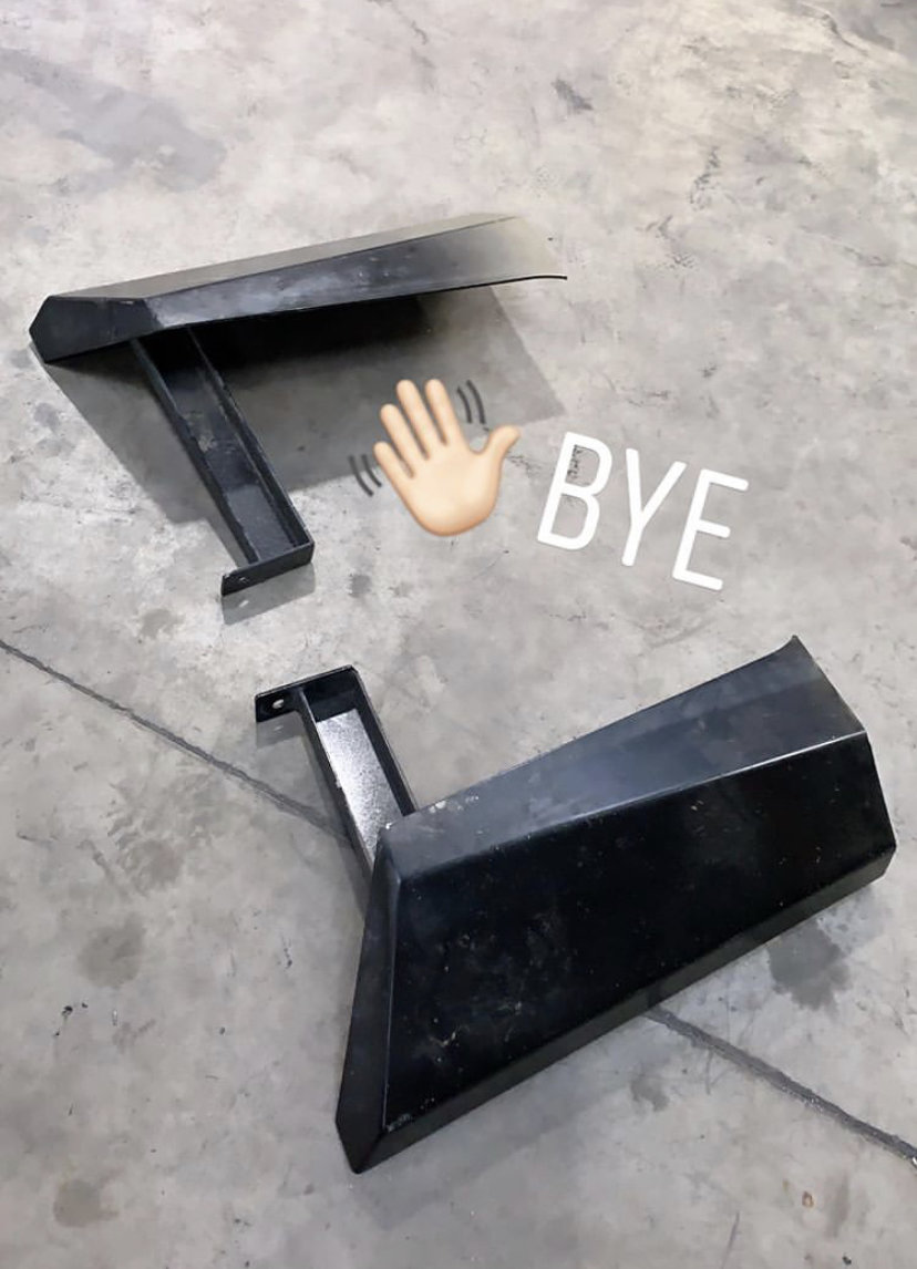

    Looking to install an aftermarket rear HC bumper with McNeil 3" glass bedsides/fenders. Most fabricators spec the bumper to fit OEM bedsides and therefore needs some modifications to fit the glass bedsides (my research shows most are about 1" too narrow and extend about 1.5" too long into the wheel well). Anybody with experience/suggestions for custom HC bumper options? Thanks.

    I had a CBI HC with 3” McNeil bedsides. It was off ~2” on each from being flush. We cut the CBI “wings” off then tubed the side to match the style I wanted and meet flush with the bedsides.
