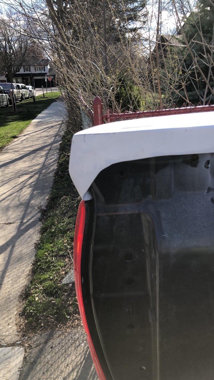

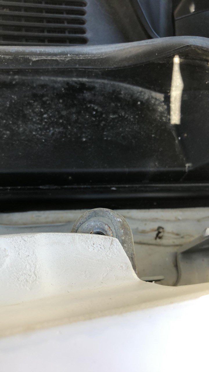

    So I was incorrect about using the T4R part. I had purchased the neck extender but my auto body guy said he was able to get the filler neck to attach without using that modification. I had provided the part but he never used it. Here are some pics of it installed. hope this helps.
    FYI my auto body guy spent a total of 52 hours fitting, installing, prepping and painting the fiberglass which probably would have equalled about 100 hours of my unprofessional time trying to install these. I think some of us underestimate how much work fiberglass takes to get it to look nice. I give props to those guys who have done it themselves.
    I still have to install the fender liners which I will tackle myself but this is a monster project from start to finish.

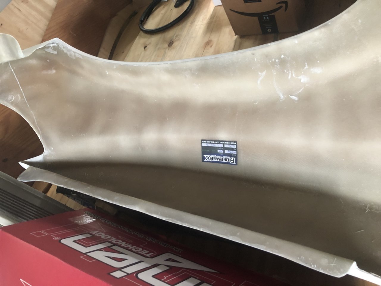

    I think there are relations between the two that separated on bad terms long ago. The guys at McNeil we’re truly awful to me and I have an album devoted to all the problems I had with them. And please understand, not normal fitment issues prima donnas complain about, extensive body work and quality issues and blatant coverups.
    My Fiberwerx have close to an aviation quality layup.
    I don’t want to bicker over it, but my experiences between both companies was night and day.

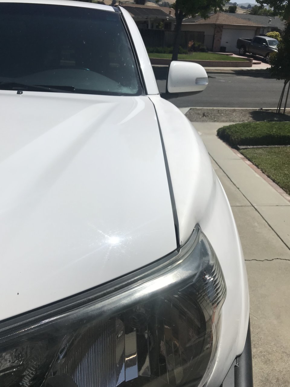

    I must have gotten lucky...I received my McNeil fenders this past Tuesday and mounted them yesterday. I ordered April 15th, they arrived May 5, not bad...never got any email saying they shipped, just a phone call from the local greyhound to tell me they arrived.
    I had no major issues with fitment. Driver's side was easy...as soon as I set it in place (no holes drilled yet), it kind of popped into place behind the headlight and set nicely in all around. Pass side was a little trickier, but nothing out of the norm for fiberglass. I am no pro by far, but I had glass on my previous 4runner and have patched my share of small fiberglass boats...so a little experience. The outer surface of the fenders seems a little inconsistent, but nothing sanding can't fix.
