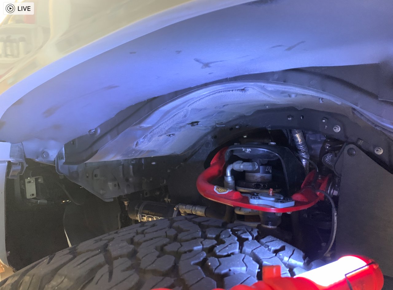

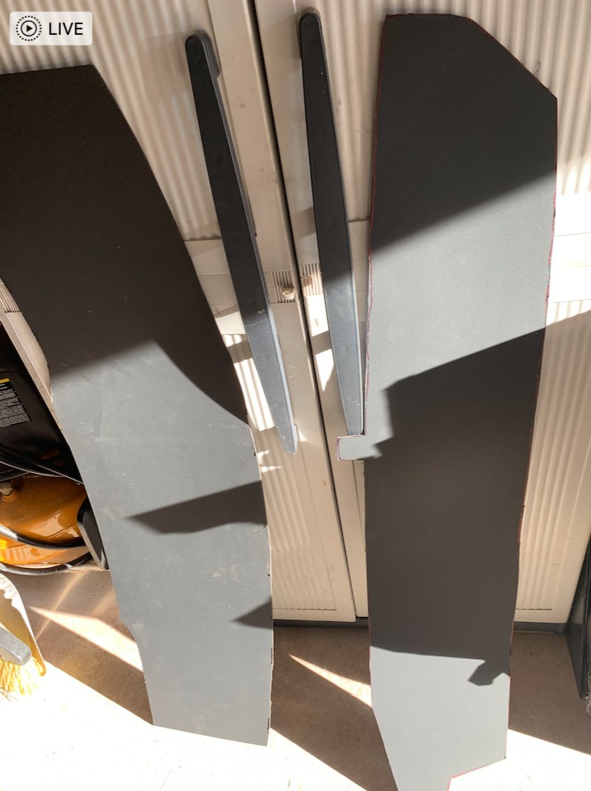

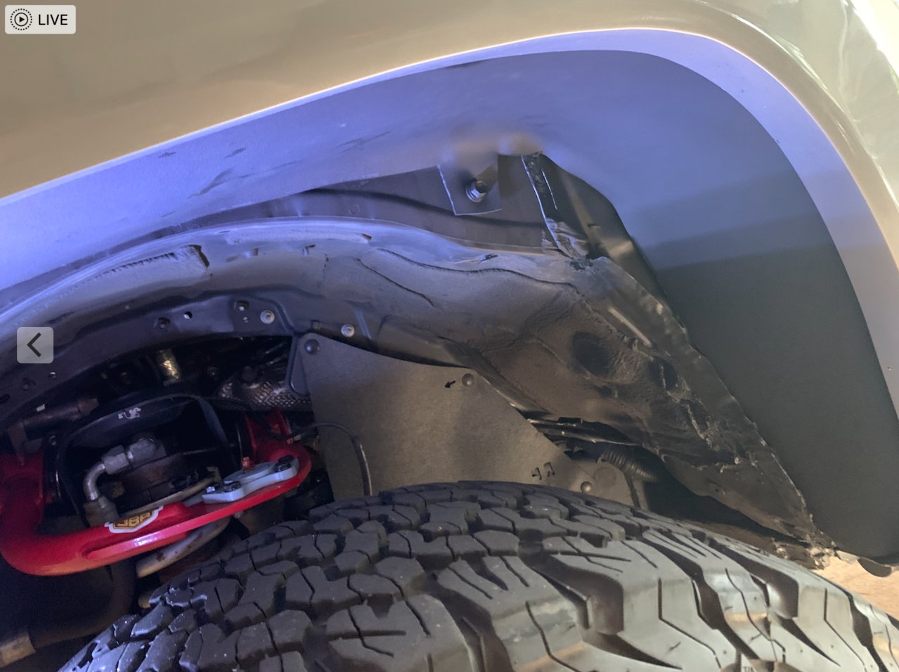

    Finally found some time to fabricate custom fender liners for my glass fenders/bedsides. I went with 3/16" Kydex. The Kydex has some flexibility to it but won't hold the shape of the fender without adding heat. Kydex is extremely durable and sturdy at room temperature but becomes malleable when hot which makes it easy to work with. You can reheat it multiple times without cracking or warping. Although somewhat time-consuming to cut, heat and reheat, it provides an ability to mold the liner multiple times for precise fitment.
    Once heat-molded & cooled, the fender has tremendous rigidity to maintain its shape. This allowed me to install the liner only using 3 bolts to fasten to the inner wheelwell body. This was my first time using Kydex but would recommend it

    Kydex!! Never thought of it, you just stick a heat gun up they’re and work it with your hand (gloved)?

    Yes applied heat with heat gun and used gloves to shape it. Only need about 320 degrees F to get it to soften. Once cooled, it becomes rigid again. Won't warp and you can reheat if not satisfied with the bend or shape. It's thicker and more rigid than the OEM fender liners

    Curbellplastics.com There are a lot of options to choose from but I bought the Kydex 0.09 inch T thermoplastic 48"x 96" sheet and had them cut it into 4 equal pieces which significantly reduced the shipping expense. Somewhat expensive but wanted to give it a try.

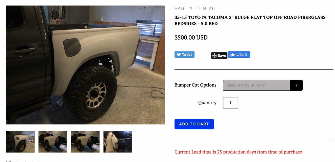

    So I have yet to find someone who has the McNeil +2" bedsides, so I finally gave in and put my order in.
