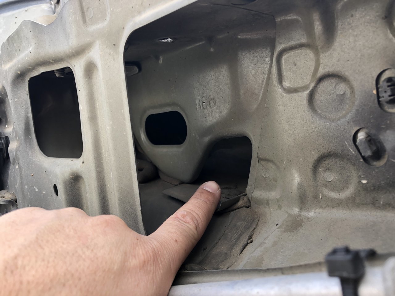

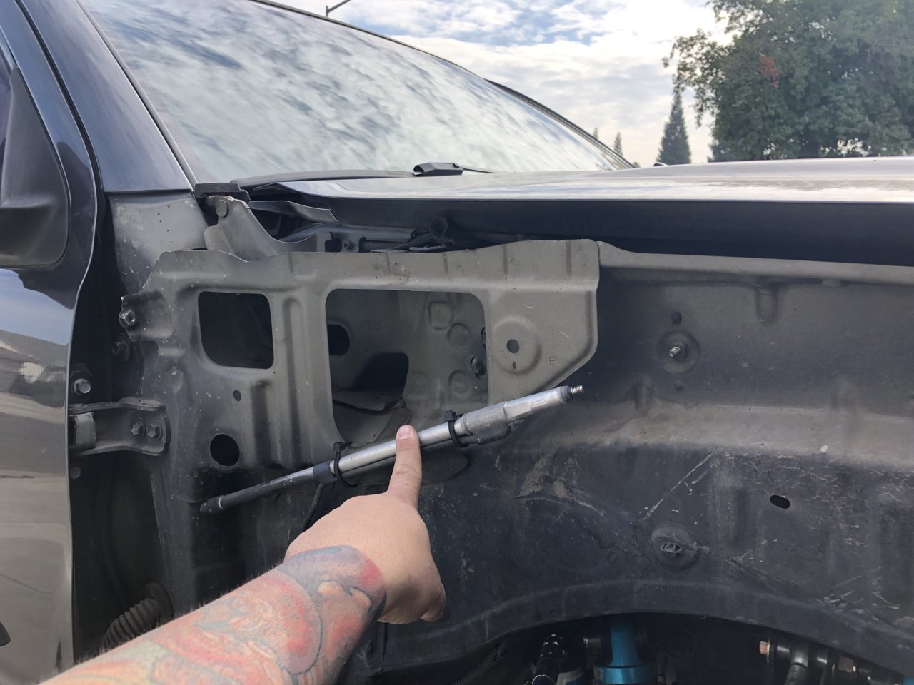

    I was thinking of filling these open areas with expandable foam, razoring off the excess, then painting this whole area with a cheap black bed liner from the hardware store. I was thinking of getting some plastic tubing, running it from where my finger is touching out to the edge to help with water drainage. Can you guys think of any issues this may cause?
    I was just thinking of filling in these areas to prevent mud and rocks and such from building up there.

    I believe that could be where the hvac draws air from if it’s like my 1st gen which I have good reason to believe since the cabin air filter is right behind the glove box in my 08. If the foam went too far you might have to open up the hvac from the inside and remove it. Maybe making a couple of bolt in abs panels like @kzrpk5 said or only to block that area in.
    Here’s some info on that kind of stuff:
    https://www.tacomaworld.com/threads...el-picture-extravaganza.439830/#post-12771628
    https://www.tacomaworld.com/threads...ture-extravaganza.439830/page-8#post-24529575
    m00seNUckLEz[QUOTED] likes this.

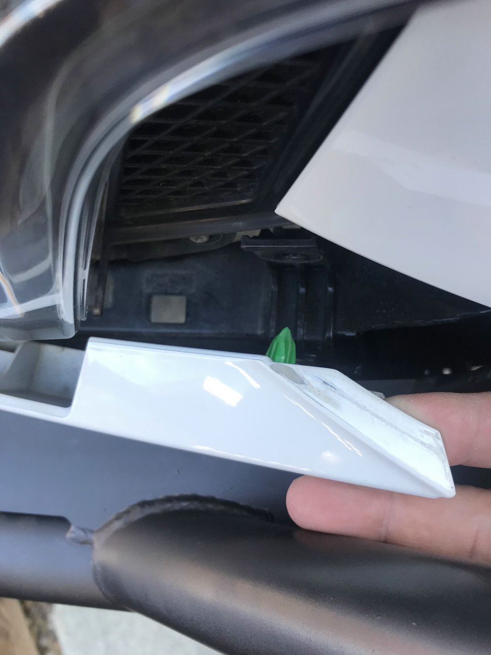

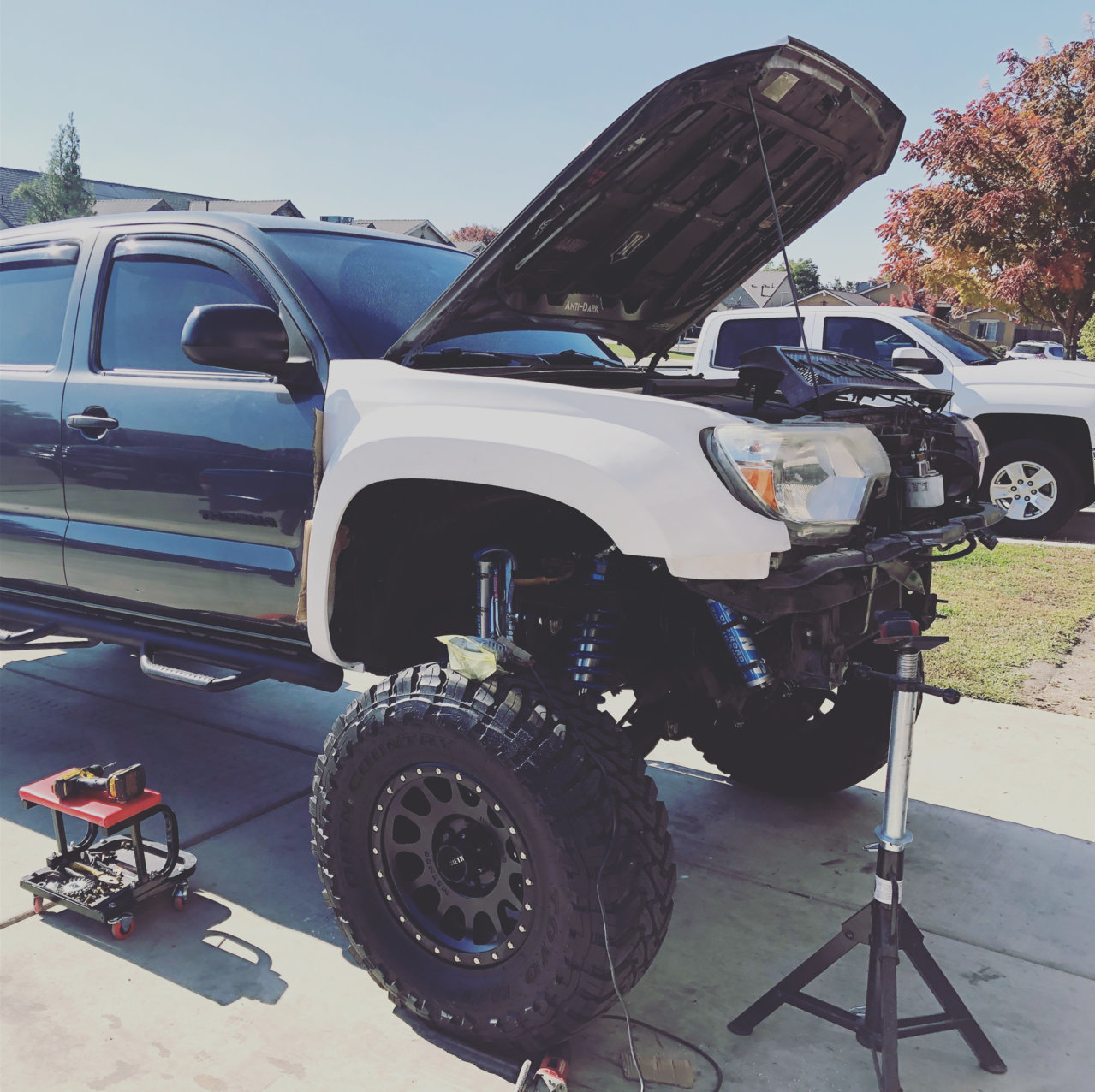

    Well, the fender install went smoother than expected. Just had to do some shaving around the headlights, other than that I need to figure out how to properly mount the trim piece under the headlights. These didn't come with the tabs that the factory fenders have.

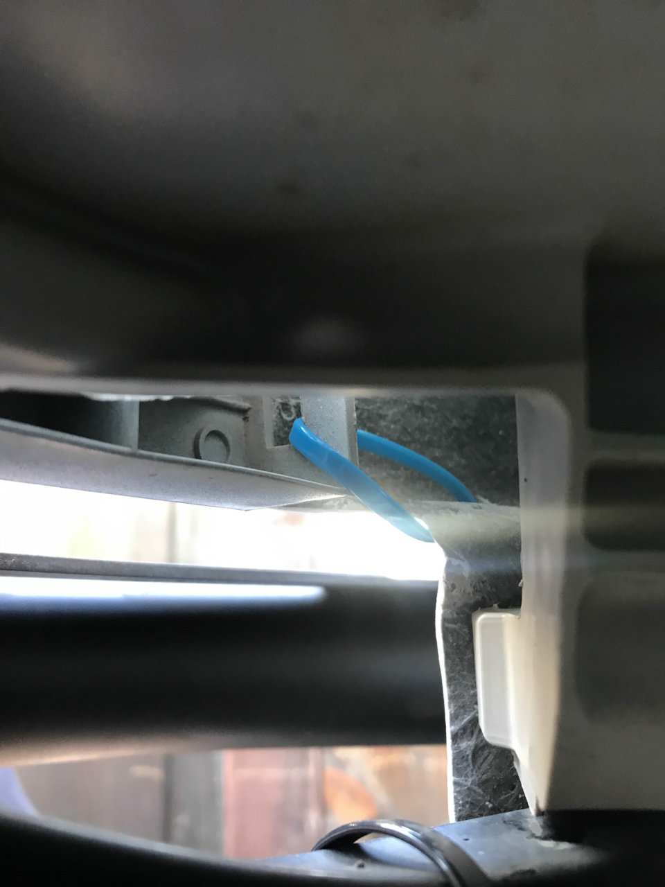

    I have McNeil fenders and had the same issue with re-mounting the stock trim piece under the headlights. I used a zip tie through the headlight mount that also attaches to the fender, and then thread the zip tie through the outboard end of the trim piece (where it has that loop). The inboard end of the trim piece is connected using the original green push connector.

  10. Nov 22, 2020 at 1:39 PM
    #410
    BertH2O
    BertH2O Well-Known Member
    Feb 13, 2019
    #282920
    81
    Bert
    Bay Area, CA
    2015 Tacoma TRD Pro AC

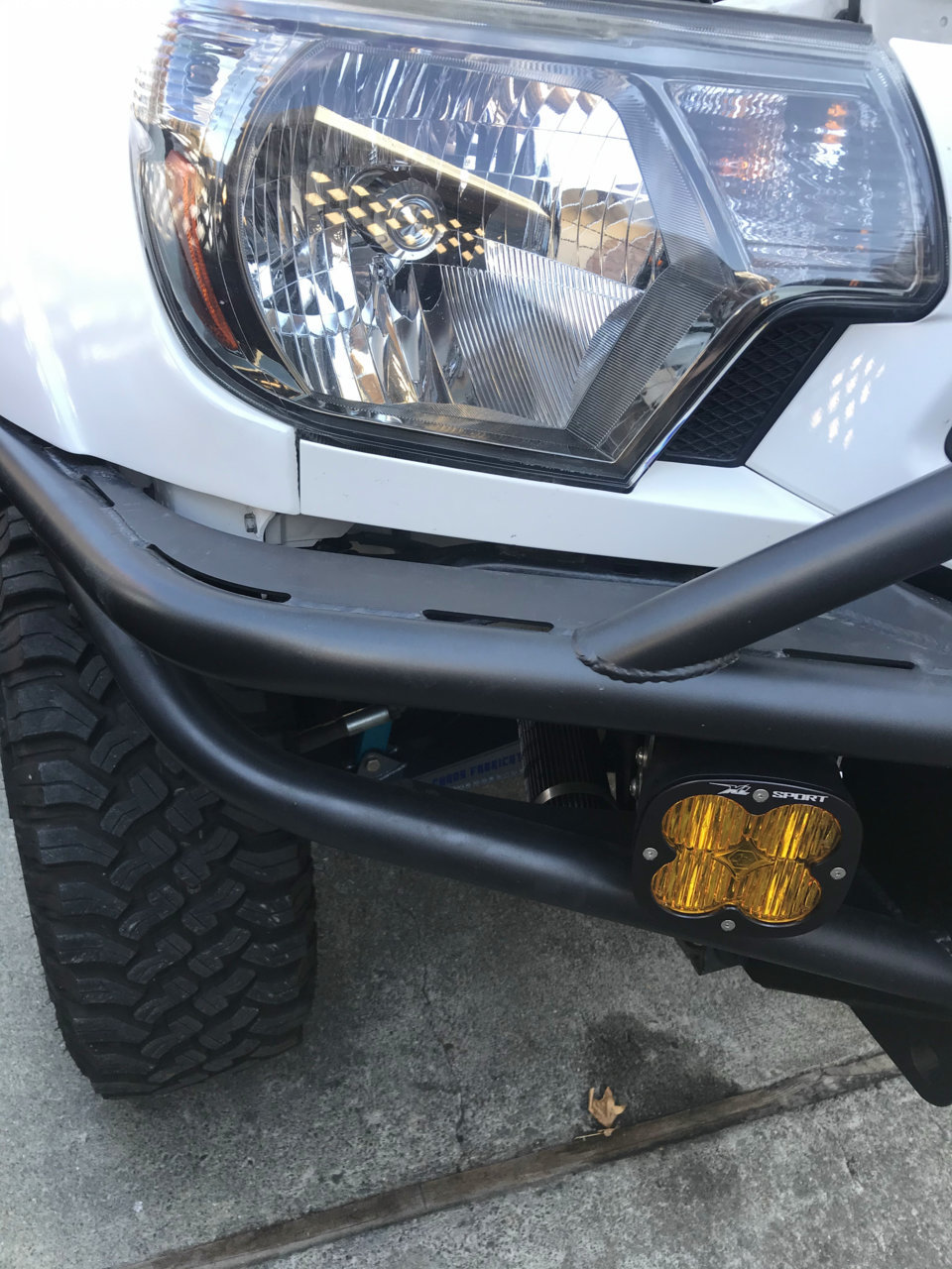

    Tried my best to get half-way decent photos. You can see the blue zip tie going through the "loop" on the outboard end of the trim piece. I drilled a small hole on an inside lip of the fender to secure it.
    This photo shows the oem green fastener that attaches in its original spot.
    And here's a look at it all. I had to shave off some of the front edge of the McNeil fenders for it to fit, but not a lot. Hope this helps!

    Perfect, this is exactly what I needed. So simple, I would've never thought of doing it like that. Thanks
