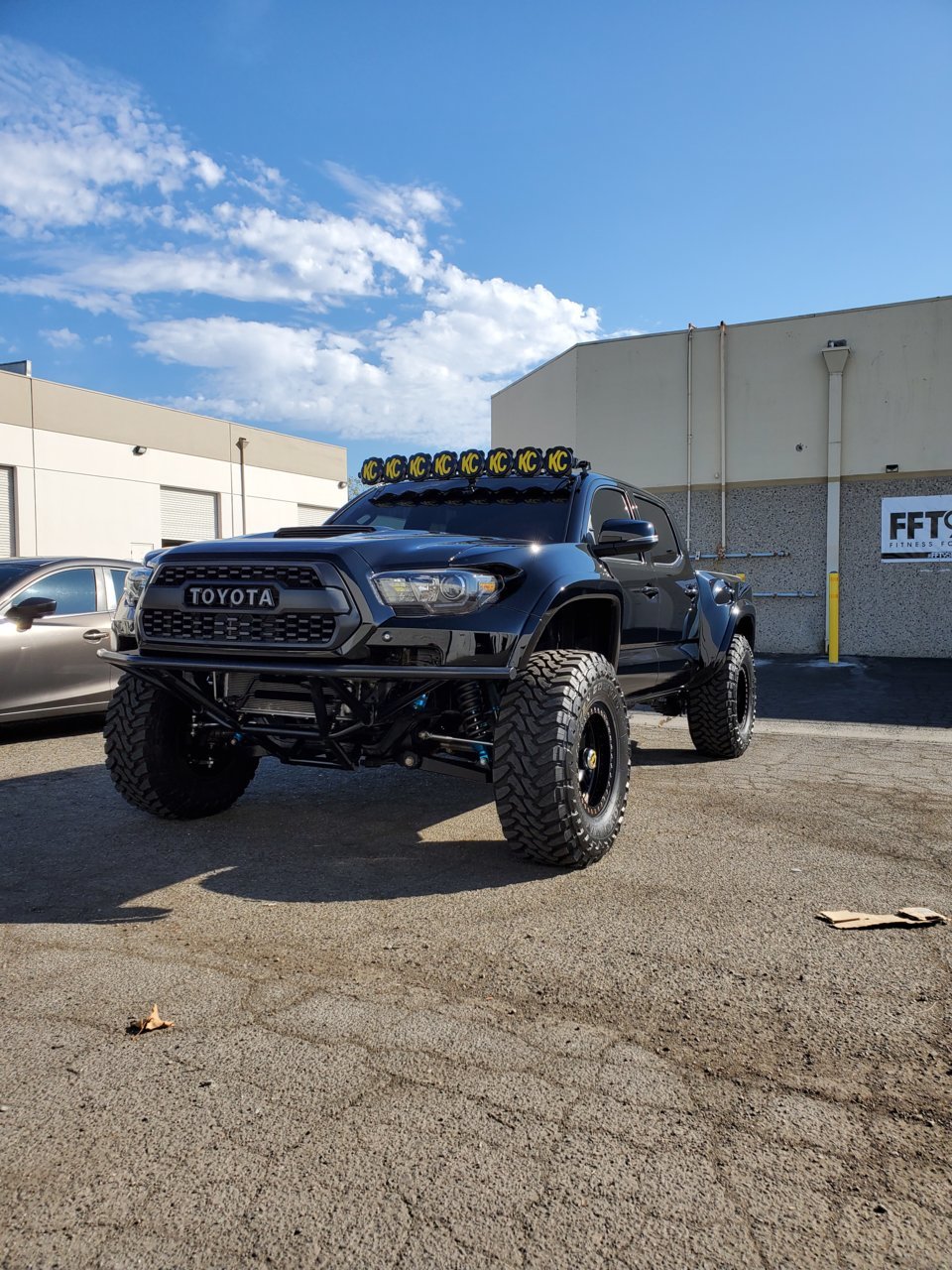

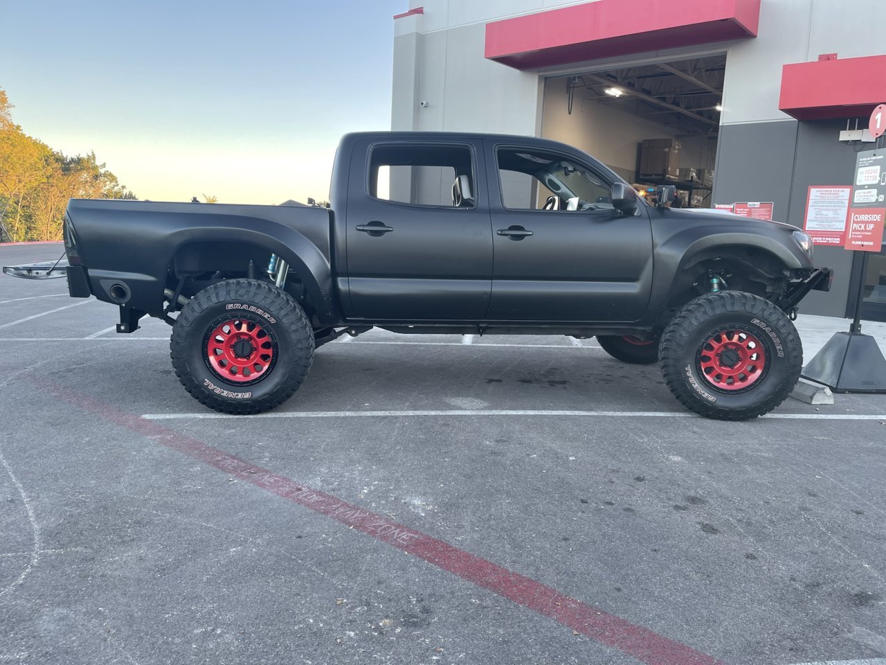

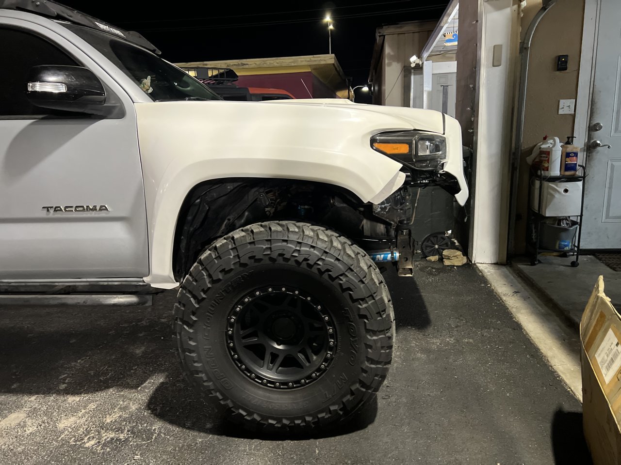

    Shaffers offroad just put one one. The biggest complaint you will prob have is the rear fenders. they are not as open as 2nd gens. He is running 37's and ended up having to cut a ton off the back and I think they still rub a bit.

    2010 TRD Off-road Double Cab 4x4 McNeil Racing Fiberglass 3rd gen conversion all the way around. 4.56 nitro gears, Doug thorley long tubes, TRD exhaust, 37” Toyo M/T’s on 17x9 Method 312’s (5),Dirt King +3.5 Long Travel up front with 2.5 kings all the way around, durobumps up front, Alpharex headlights, Baja Design Fog lights, SR20” rigid bar, Demello Offroad Baja bumper, Dakar HD rear springs, prinsu rack, taco bed mat, AL off-road Trailgate,rci skid plate, full sound system, katzkin all leather seats, 10 pro comp rock lights, switch pro 8 switch setup, on board VIAIR compressor, smittybuilt 9k winch, total chaos cam tab gussets and spindle gussets.

    You are correct, my 37’s don’t like tucking in there at all lol

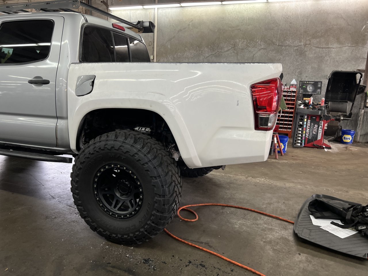

    Headlights mount basically in the same location, McNeils sells a bracket that bolts to factory locations for the grille to sit on and it has small tabs to bolt the piece that goes under the headlight and a tan for the bottom of the headlight I believe. Haven’t gotten that far yet cause I’m trying to not run hood pins for this hood and fabricate a striker to utilize my factory hood latch assembly.

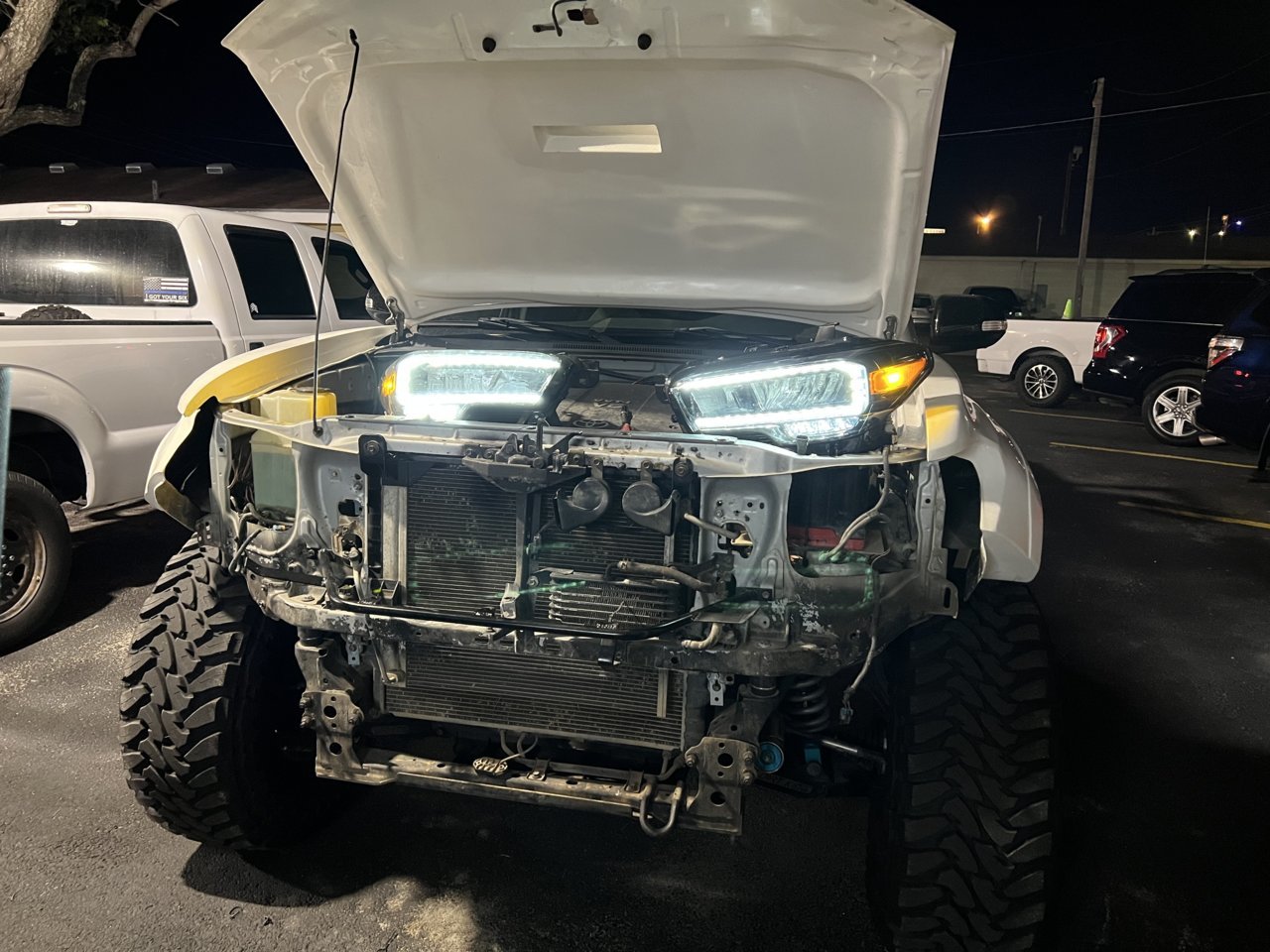

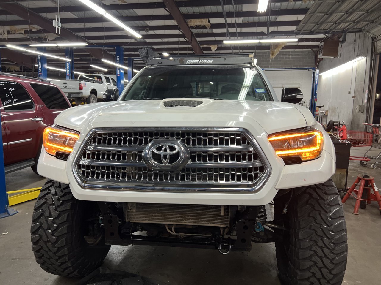

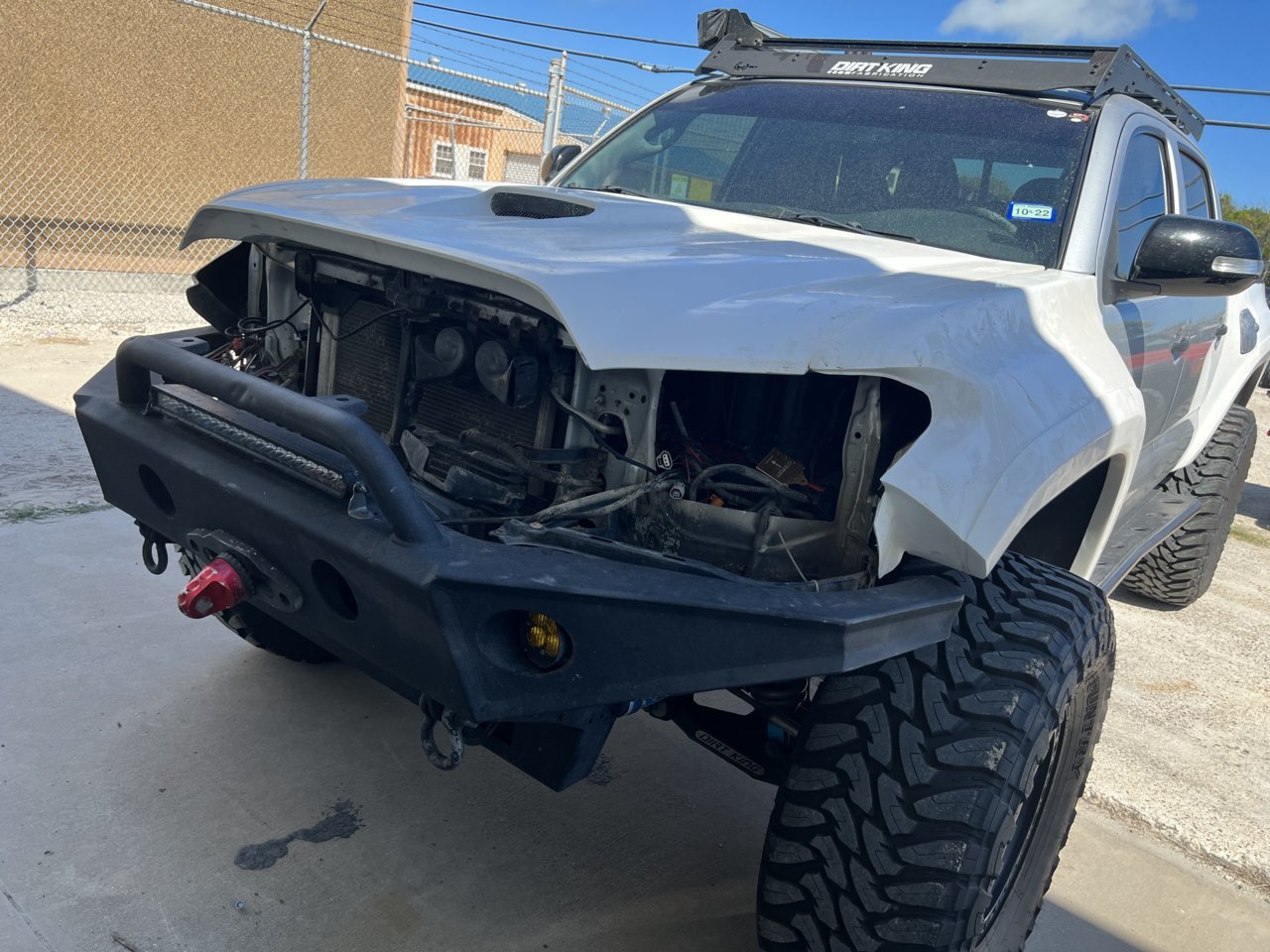

    Fitment is actually pretty spot on, gonna mess with it some more tomorrow after work.F4C9E02A-166B-442D-8696-5EAC8DB51B64.jpg76E3DA3F-39FB-4D0B-AA18-872AD650EEDB.jpg 3E4AAD23-B614-44E8-B372-73278D456CA4.jpg

    How it sits for now

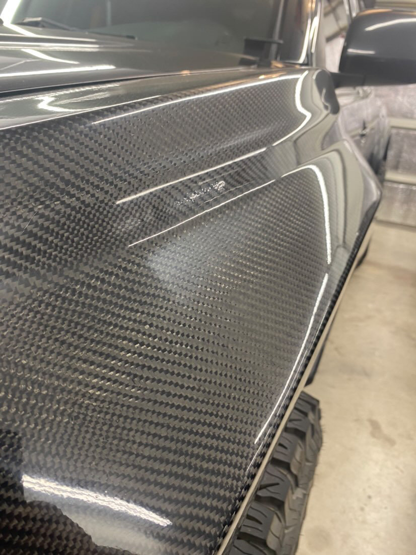

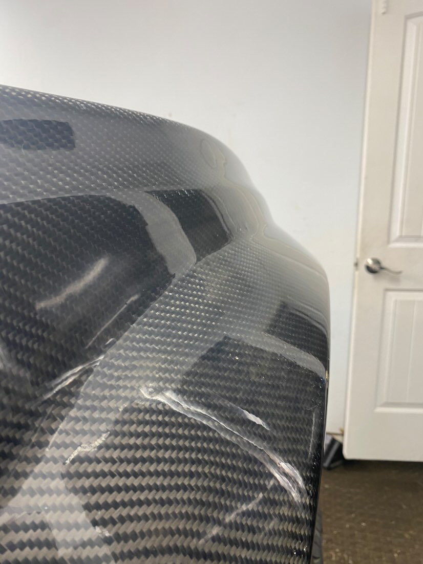

    How it currently sits with roadrunner fiberglass but going to pick up these CF Fiberwerx from a buddy in a few weeks 22BDE122-048B-403D-B820-6B2439276BA6.jpgFD4B6D1B-14A4-4485-A45D-EB28D09B81A2.jpg1FC66DA4-BA20-4193-B049-B4DE505A196A.jpg84714BDF-4EEE-427F-A1EE-61279B90507A.jpg
