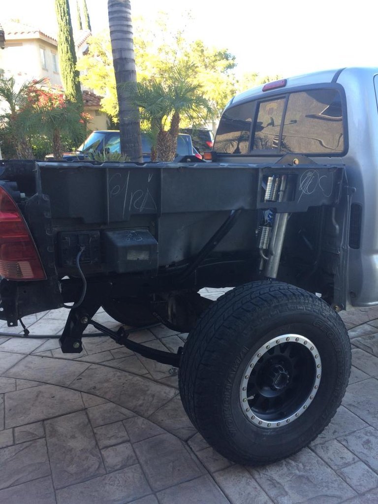

  12. Dec 8, 2015 at 6:11 PM
    #112
    txmxer
    txmxer Well-Known Member
    Jun 20, 2010
    #39228
    1,742
    California and Texas
    06 dc tacoma
    - Total Chaos 3.5 Long travel kit - Fox 2.5 coilovers w/ resis -Prerunner bumper -Fiberglass front fenders -Fiberwerx tt bedsides - Dmz Sua - fox 2.5x16 triple bypasses
    Not sure if im right on this but on 1st gen dont you still use the sheet metal skin for fiberglass fenders? On 2nd gens the whole sheet metal fender comes off and theres nothing left except for the composite bed and the fiberglass fenders alone are not strong enough to support a hard top camper shell. I want to add a camper shell to my 2nd gen with bedsides also. You would have to fab up something with tube supports or sheet metal? Maybe a tube structure with sheet metal to mount the shell to or something... let me know if you figure something out haha someone on the long travel thread said they had built a structure to mount a shell but I never saw any pictures. It sucks because most other trucks you keep the sheet metal bed so you can still mount a shell.

  14. Dec 8, 2015 at 6:25 PM
    #114
    txmxer
    Jun 20, 2010
    #39228
    1,742
    06 dc tacoma
    Yeah that area on the 2nd gens is a composite plastic/rubber inner bed. I wish it was metal like on your truck! It does make it really easy to mount fiberglass though on the 2nd gens

  16. Dec 8, 2015 at 7:11 PM
    #116
    txmxer
    Jun 20, 2010
    #39228
    1,742
    06 dc tacoma
    Yeah this is what the 2nd gen looks like without bedsides:
    7746F477-6F32-4F39-93DF-8AC38AA1A24B_zps_ea3188c269c8a6b3a5564c2a61b540aa891181a1.jpg
    surforegon likes this.
  17. Dec 9, 2015 at 5:45 AM
    #117
    tfeltz73
    tfeltz73 That's greasy Ricky
    Oct 20, 2012
    #89405
    487
    central Wisconsin
    2013 supercharged long travel thing
    Dam, well at least it's all open to fab up a small frame at least for a topper. Otherwise I might look into a bestop but I use the shit out of the rack on top of my cap right now.
