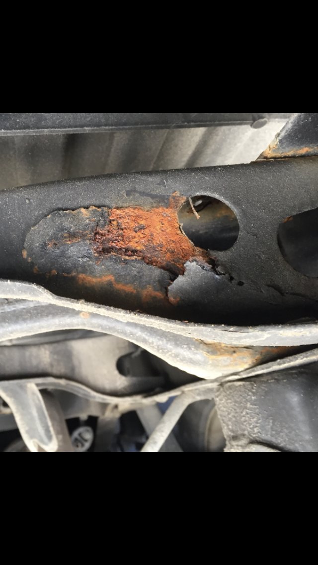

    Don't let them put that on your frame!!!
    If you've done that much to save your truck tell them to piss off.
    This shit kinda prevents you from seeing what's going on and until it dries up would be a bitch to remove.
    Mine has it I'm still pissed but found lps3 rust inhibitor keeps it wet but needs to be done regularly to maintain. I feel I'd been in better shape without it but my OCD may talking here.
    So I don't maintain the tire catch thing so this is what it does if left to Toyota and the rest is me trying to save it.
    This is my 08 at 160k I gotta pick some scabs and coat again before snow hits and vt breaks out the salt brine on the roads!!!!!

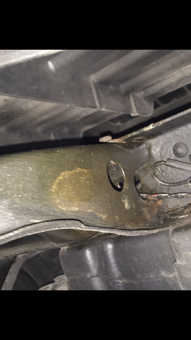

    Here’s 1 winter with their crc.
    Damm Toyota just covered everything without any prep.
    First coat of lps after picking the scab.
