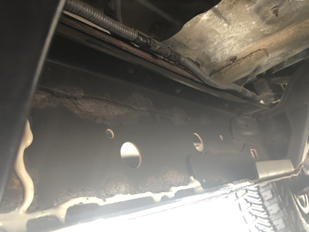

    I just took mine into Team Toyota of PA and they did an absolutely pitiful job on my frame inspection and “re-spray”. Also gave my truck back covered bottom to top in shop dust and overspray. Rust is still very much prevalent.

    I had my service advisor come out, we took pictures and I’ve now been waiting a week to hear back from a service manager about the issues.
