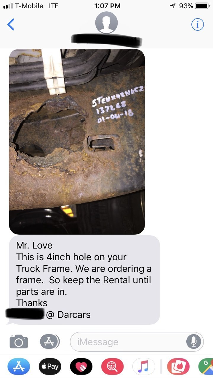

    I got a pretty big update.
    I'll do a little recap first.
    I dropped off my 2005 Tacoma ext cab, 4x4 at the dealership
    The next morning, the service advisor sent me this:
    Cool. Frame is trashed on a 12 year old truck. Crazy...
    Anyway, I'm a curious young guy, so I had managed to stop by the dealership for one reason or another about every 2 weeks for the past 1.5 months.
    From 1/4/18 (when they were done with the inspection) to 2/17/18, my truck was not moved from where it was parked after the frame inspection was done. It was left unlocked on the lot. Not so professional, but whatever.
    Last weekend (2/10/18) I drive by the dealership, and I see they got a a shipment of (5) frames in. Brand new, strapped on pallets.
    Here:
    (Picture was taken on 2/17/18, one week after I had seen the 5 come in, so they had used 2 frames).
    Ok cool. Finally some progress. I saw 5 frames, and I counted 4 Tacomas in the parking lot. WHOO-HOO!!! ONE OF THEM HAS GOTTA BE FOR ME!!
    Having a rental car is nice, but going 6 weeks without your car gets kinda old.
    I stopped by (2/17/18) a week after I saw the frames, and saw a lot of progress. There were only 3 of the 5 frames left, so they must be working on the trucks. And my truck was moved! It wasn't parked there anymore!! So it must be getting worked on RIGHT. NOW!!!!
    I was excited to see it taken part and take some pictures and document it here for you guys.
    Then I look around and see this:
    2 old frames, discarded. Neither one is mine unfortunately.
    It seems they all rust through in the same spot. Passenger side frame rail, front, right under the footwell.
    Then the driver's side frame rail rusts next
    And the rear area, where Toyota got rid of the box frame (where the 1st gen Tacomas would ALWAYS rust first). They have done an C-channel style frame in the back, to help prevent salt and stuff from getting trapped in there I guess.
    The seams still rust and bulge.
    [​IMG] [​IMG]
    When I saw that the dealership had gotten a shipment of frames in, and mine was moved, I thought for sure that mine was currently being worked on, but I was wrong. I did some math, and it seems to me that they shuffled trucks around in the order that they will be worked on.
    There were 5 frames, and a total of 5 Tacomas parked in the lot right next to the new frames, and then they moved all the other trucks over to a different parking lot, I assume awaiting a 2nd shipment.
    So...who knows, they may have my truck for another 6-7 weeks. Crazy.
