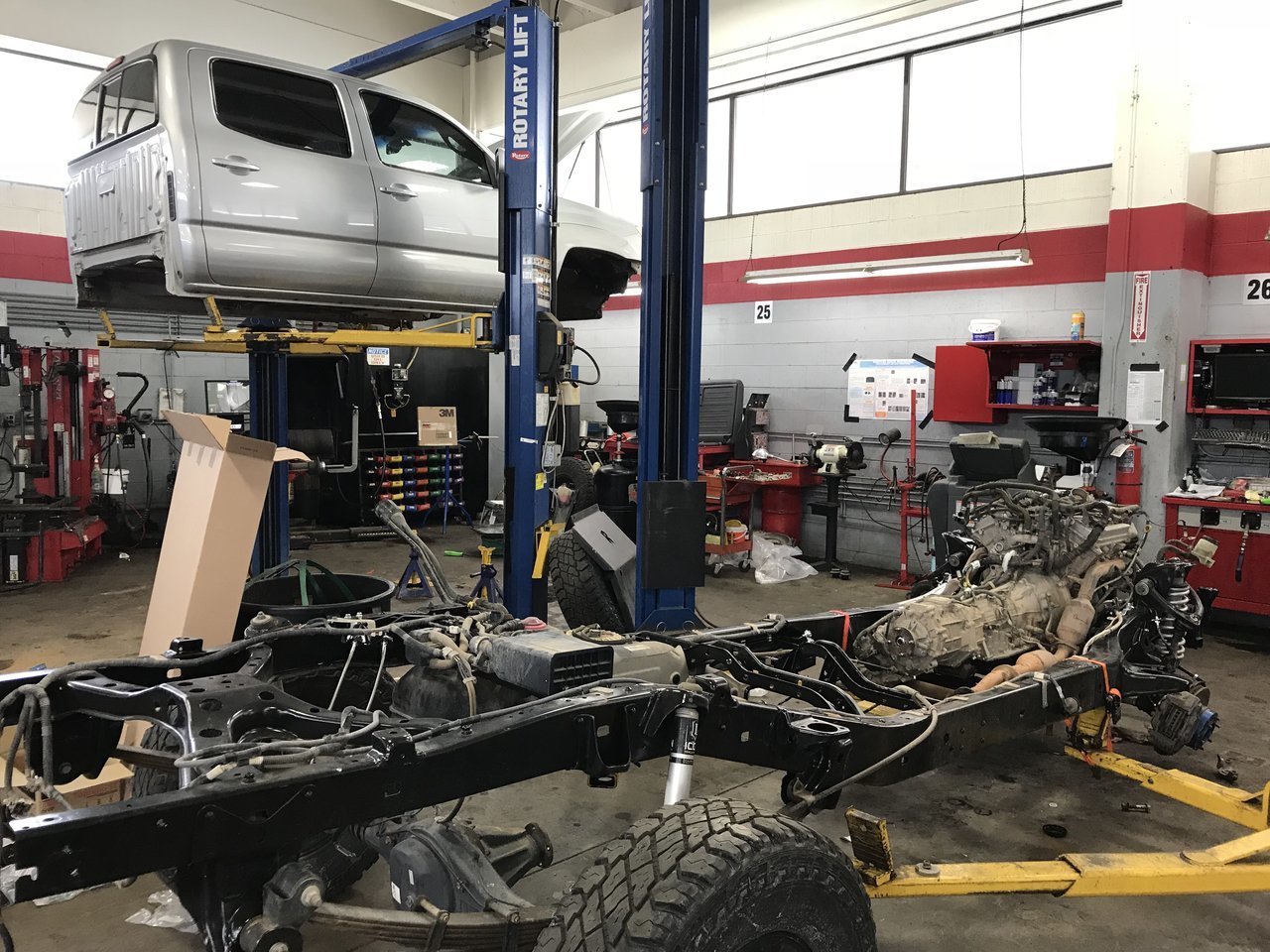

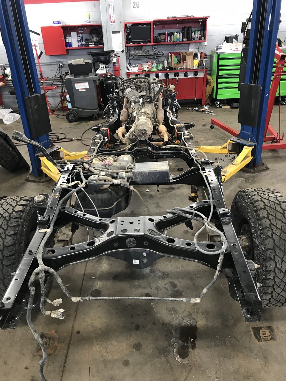

    Another update - 2/24/18:
    I've stopped by the dealership 3 weekends in a row. 2 weeks ago, when I saw the frames come in, I thought my truck would get one of them. Last weekend I found out that was wrong because my truck was moved to a further away parking lot, and suddenly more Tacomas appeared. 12 trucks, 5 frames, what gives?
    On Monday, I asked my service advisor for an update. He was out of work for Monday and Tuesday, but would send me an update asap.
    Friday morning, he sends me a message
    "It looks like your truck will not be completed this week. They are still working on it. Latest will be next Tuesday."
    I thanked him for the update (although the update was days late, and didn't tell me the fact that my truck was even being worked on before this) and I said if my truck is waiting until the next shipment of frames comes in, that is fine. Please, just please keep me in the loop so I know how to plan.
    No reply.
    So I go to the dealership and I see they got several more frames in!
    And there's another old frame being discarded
    Rusting through in the same spot. Again.[​IMG]
    For some reason, this one frame is matte compared to the rest, which are all glossy. Hope that one didn't escape rust protectant/prevention again :fingerscrossed:
    I looked around the lot, more and more Tacomas parked there every time I come. This time there were 20 Tacomas between the two parking lots. Half with new frames.
    For the first time, I saw trucks with the "CRC" or frame goop.
    This stuff looks a lot more 'vile' than what they sprayed on my 2000 Tacoma.
    Then I snooped around until I saw that my truck was on a lift in the garage. I played nice until one of the guys said it was okay for me to come in and look around.
    Apparently, my truck is actually all done. But the master tech has to do a final inspection, test drive it, and do an alignment. So won't be ready until Monday or Tuesday.
    The rest of these pictures are of my truck.
    The old frame is sitting under the truck with its new frame installed.
    You can see some of the old parts sitting on the frame: leaf springs, control arm, rotors, skid plate.
    What's weird is the rotors. When I was looking at the truck, I saw the rotors and got a bit excited. I happened to look through one of the front wheels and see nasty rotors still on the truck. I shrugged and said to myself "must have been rear rotors replaced then."
    Then I got home and said "wait a minute...these trucks have drums in the rear..." DUHHHH. Silly me.
    Then I zoomed in as much as i could and those rotors look like 5 lug rotors (there is a 6th hole, but it looks like an access hole because it's not symmetrical). I guess it's possible someone just threw the rotors from another vehicle on top as a junk pile.
    New tire carrier comes with the frame. Thank God because those always go to shit.
    New lower control arms w/ball joints on both sides
    New brake lines [​IMG]
    New nuts and bolts and brackets here and there
    Pretty new frame with those sexy leaf springs
    Apparently my frame was pretty chewed up on both sides: (You can poke through and pick chunks of rust off with your hand, by the way.)
    Twelve.Years.Old.
    Truck/Frame is twelve years old, and I can pick off chunks of rust the size of my hand.
    And remember, these things rust from the inside-out.
    Markcal and Nazupag524 like this.
