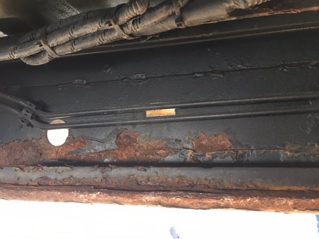

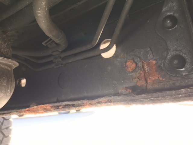

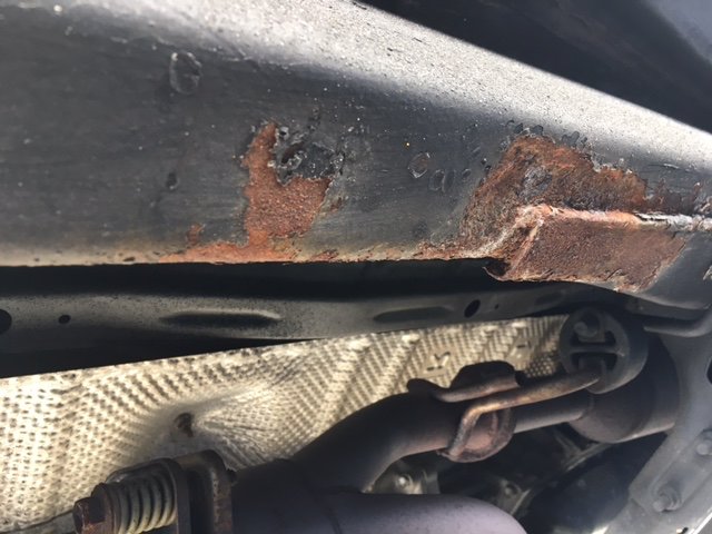

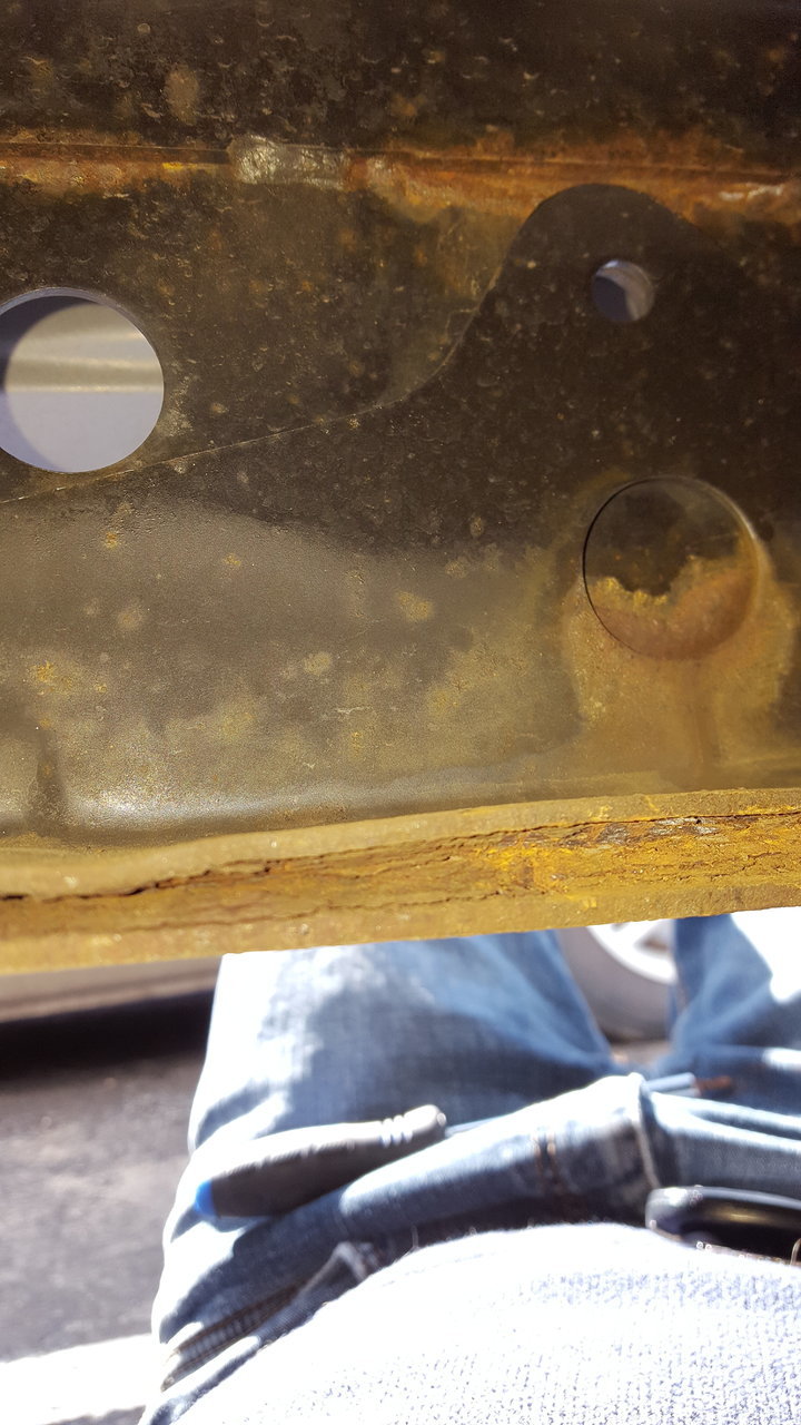

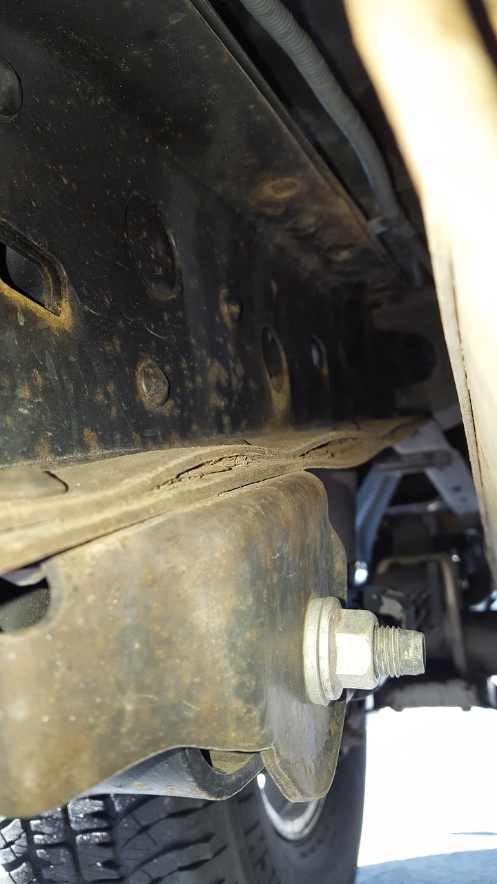

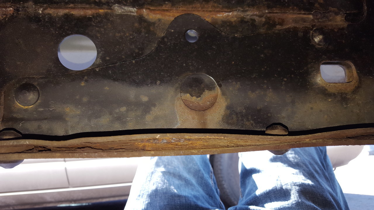

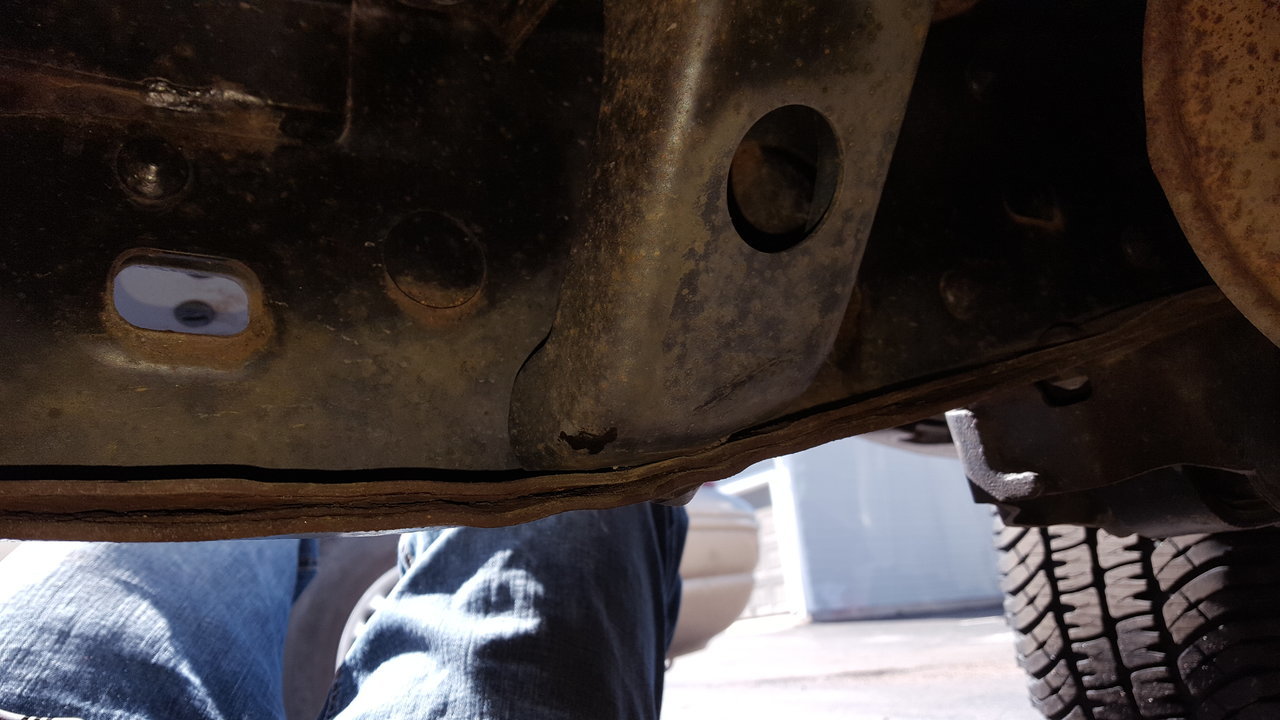

    20180320_144652.jpg 20180320_144626.jpg 20180320_144644.jpg 20180320_144636.jpg I've been perusing the forums constantly ever since my oil change a week ago and thought the swiss cheese effect looked funny. Truck (07) has lived in CO all of its life. Was inspected in Jan of 16 under the LSC and "all was fine"... no holes yet but the hammer test will come hopefully within the next week, along with some measurements. New inspection coming on the 2nd. We shall see. Pictures start from passenger side mid section and look toward back right spring.

    That first picture looks like my frame and mine passed . No holes ,but that rail is seperating !

    Man yours looks like shit too .Rail separation . Dealer told me thats normal . I call bullshit . I want a new frame!
