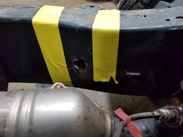

    I looked around under my truck and all I could find is one hole about 20mm x 36 mm. The rest of the frame is in pretty good condition, I put alot of work into keeping it nice but looking back, it was just a waste of time and fluid film.
    I saw a few trucks at the dealership sitting on trailers. Apparently too unsafe just to make it to the dealership.

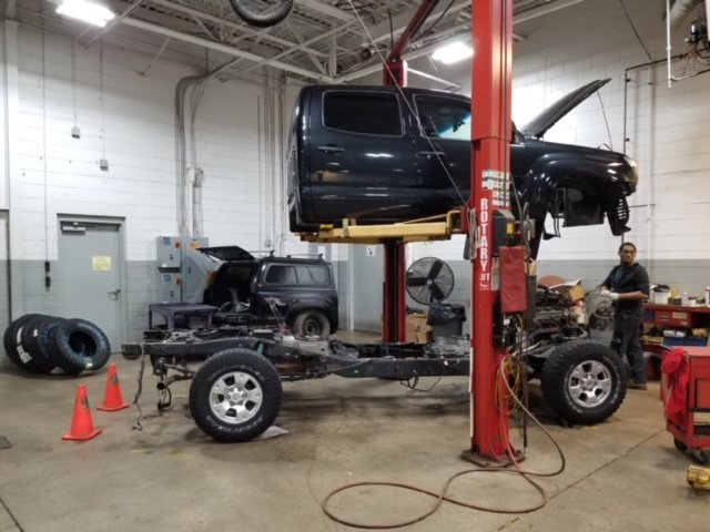

    My truck went in last Friday for a frame replacement. I don't think I had to wait more than 3-4 weeks for it to arrive.
    If you have the stomach for it I recommend going in and checking it out. I stop by every day and talk to the Tech doing all the work (Les).
    My service advisor explained to me that I could replace anything they had to take off with new parts if I choose although in some cases there may be a reduced labor cost.
    I bought Bilstein 6112's for the front and 5160's for the rear. I think he said there is a small labor charge to replace the front shocks because it takes a little more disassembly that a standard frame swap. I think he said $140 in labor for the front. The rear shocks do not have any labor costs for replacement.

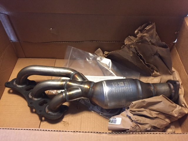

    I also ended up buying new manifolds (even though they don't have to take them off to do the frame swap the motor is removed and therefore the labor charges go way down, I will end up paying $120 which seemed like a bargain). Magnaflow doesn't make the 4x4 Y pipe yet so everything after the manifolds is still stock but I can easily change the rest out myself.
    I purchased some new factory *updated* headlights which my advisor said they would install for free.
    Finally I bought refurbished factory wheels and new Duratrac's to give me summer and winter sets.
    I figured a shiny new frame deserved a rust free tow hitch so I removed the bumper and hitch and cleaned the hitch up.
    I decided to replace the rear bumper frame piece because it was so rusted it was not worth attempting to clean it.
    Can't wait to get it back, hopefully this week.

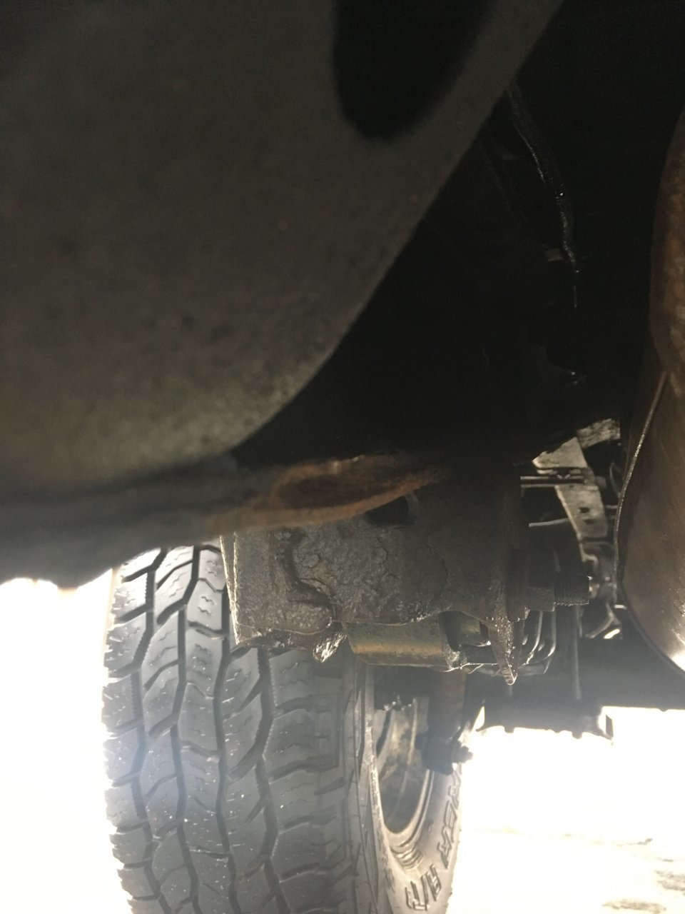

    IMG_2979.jpg Mine is seperating bad and passed. I'm bringing it to different dealer and if it passes again, I might be done with Toyota. So disappointing.

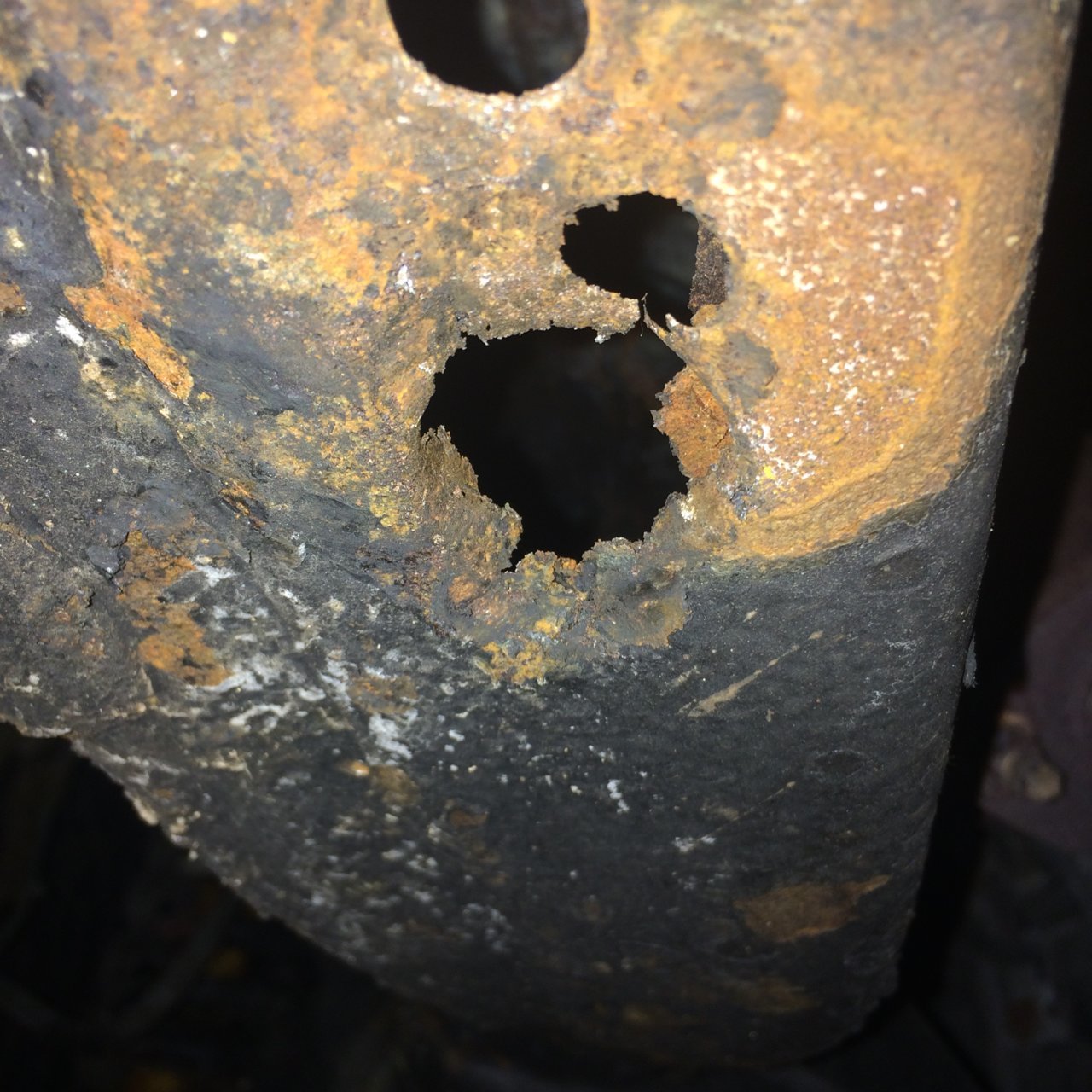

    Hello Everyone, I bought a 06 Tacoma in 11/15/2017 I had the frame inspected and it passed. Also at the sametime the dealer installed new rear springs and sprayed the frame with CRC, which was great. Until 4/3/2018 when my son got a flat tire while using the truck. He used the factory jack and he didn’t get the tire off the ground when the jack blew through the frame. Back to the dealer 4/4/2018 and now the frame failed inspection bad. 4/5/2018 Toyota rejected the claim for warranty so my truck is currently junk with 118,431 on the odometer.

    How did they justify not covering your frame, did they give you an explanation?

    The truck in service date was 3/22/2006

    That's a real shame, they must not have done a great job inspecting it in 2017 because I'm pretty sure it didn't rot away in 4 or 5 months.
    I can't tell where the hole is, I've seen a couple threads here that deal with patch panels that you can have welded on to repair rust prone areas.
