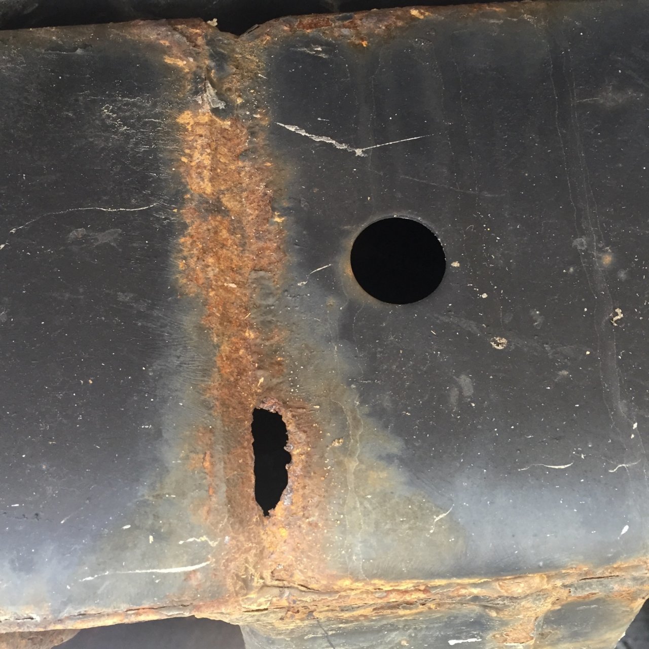

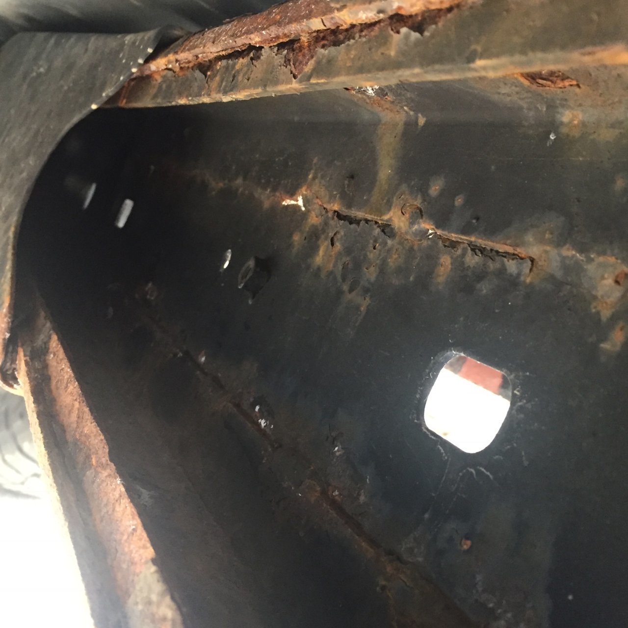

    I went to a different dealer and failed .First dealer only wanted to coat the frame .192DC405-A8FF-4038-8649-4595F3AB190A.jpgE72818DF-249E-4264-8D7E-179A2E6F0A8A.jpg

    Thats most certainly a fail, that other dealer must be a whole bunch of scumbags.
