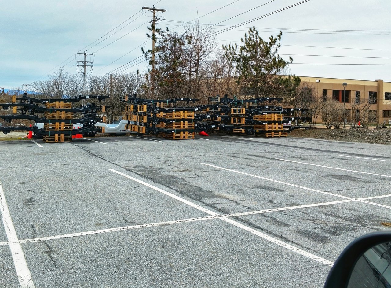

    My Dealer always keeps it's backlot filled with frame stock

    Looks equal to my dealer in Ma, we usually have about 5-6 frames going at once and the techs inspecting all do a great job. Makes sense that they dont often do frames in florida, if you can tap through any part of the frame that is the size of a quarter or so then you are Elligible for replacement. Saw one pass a couple days ago that was indeed pretty god damn crusty and crunchy looking. We looked all over but it was still solid! Got any pictures of your frame Darek661 im curious of how bad it is.
