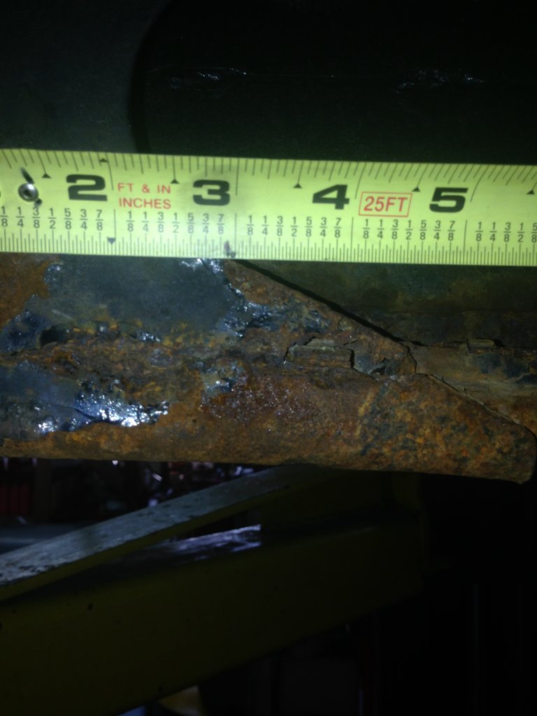

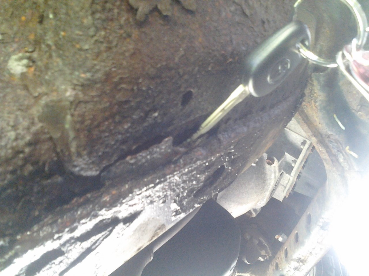

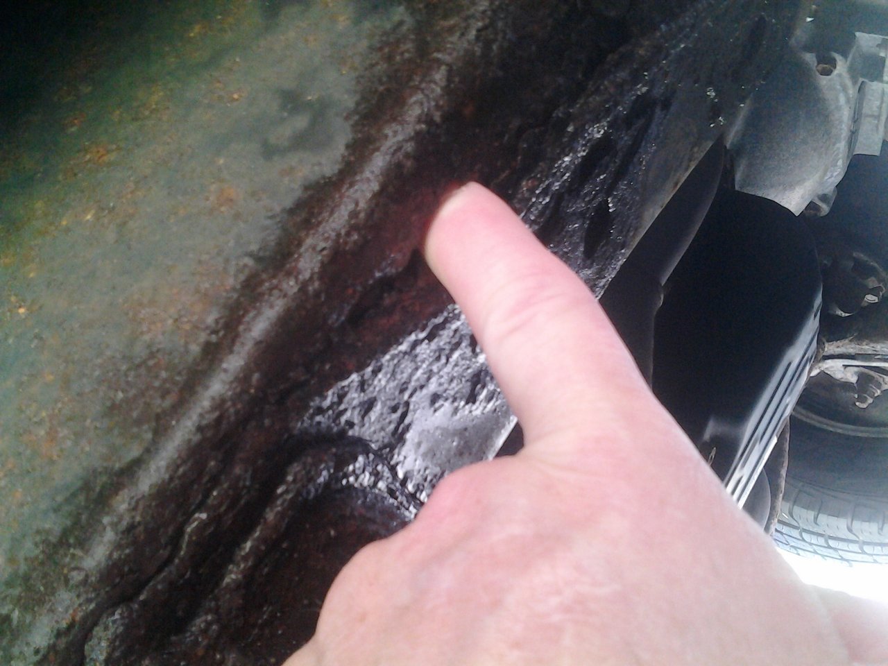

    This is the crack and hole that was found in my 2008 with less than 70,000 miles on the truck. Started out with a lot of surface rust that turned into chunks of metal chipping off to eventually crack and hole appearing on the passenger side of the frame.
    My dealer replaced the frame and much to my surprise a bunch of other stuff that went along with it like lower control arms,cables,etc on Monday. I picked up truck yesterday and it's like a new truck again underneath!
    I had the steering shaft replaced because I was experiencing stiff steering. Charged me $250 for the part. No labor because they had to remove it anyway. So that's all fixed now too. I am going to the website that I saw in posts for this to complain about this safety issue.
    I'm not happy that my truck needed the frame replaced but I am glad that it was done and that Toyota picked up the tab.

    Thank you for including pictures of rust damage. We took our truck into Toyota of Escondido (San Diego county) last week. It passed. The staff stated that they have only applied the coating once. Easy and off to work we went.
