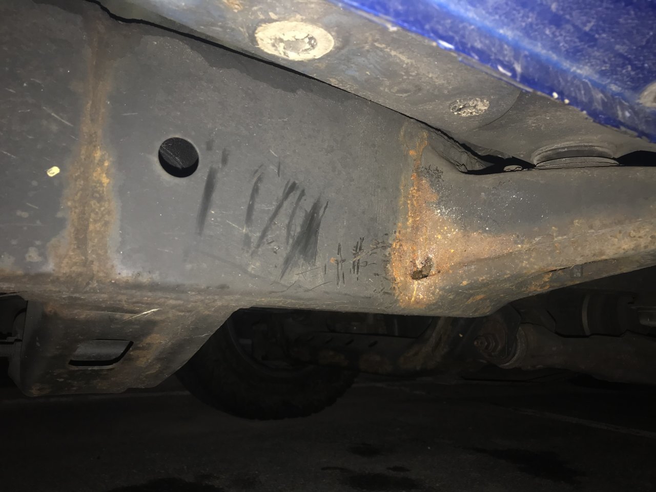

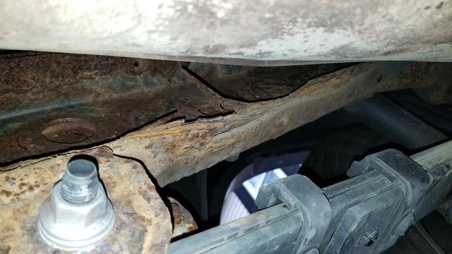

    Does anyone know what the standards are or the test for when they inspect the frame? I keep reading about at least a 10mm hole but what about mine where it looks like there is about a 4 inch long separation due to rust? I dont know if thats bracing thats separating or just the end of the front boxed section. I looked under the truck again and the same thing is happening on the other side as well.
    Quoted my pics for reference. First pic is what Im talking about.

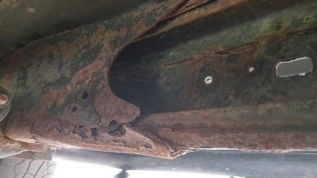

    this failed me. the rest of my frame is solid and not even that crazy

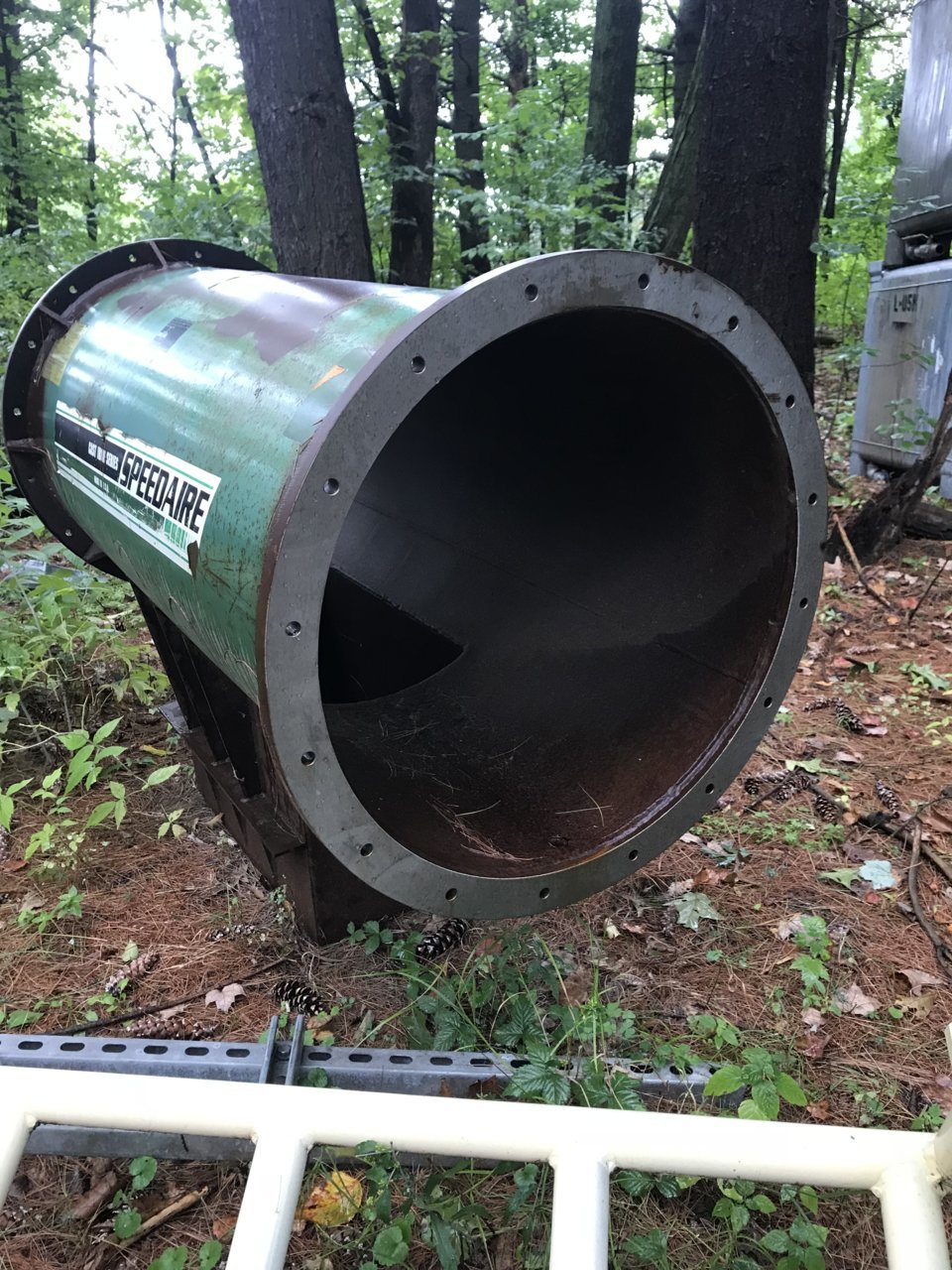

    We use lps 3 at work and this is a part I machined the flanges on.
    A light coat of lps 3 and it’s been outside in the parking lot or in the woods for close to 2 years.

    That will fail.
    Or it better fail if not find a different dealer!

    Im hoping it fails. like I said, I took it to a different dealership and it passed, but that was 3 years ago. I live in Georgia so I doubt its gotten too much worse in that time but who knows, I didn't look in these spots back then. I hate to say it but if it doesnt get replaced Ill be considering selling the truck. I carry my family in this thing and Im not dealing with the liability of something happening with them in it.

    Get it on a lift and do some poking. Seems pending the dealer is how willing they are to say it’s bad.
    My dealer jumped at the spot I showed them. They have done enough to know how make $ on them without putting the shaft to the owener.
    My thought is that if it’s a exception to the norm they are confused. And are reluctant to do it.
    I had spent a lot of time trying to save my frame and failed!
    Don’t trust the dealer!
    Those black spots?
    Are they soft?
    Don’t beat it but definitely tap at it maybe poke at with an all.
    If it becomes the size of the opening of a 10mm wrench it fails!
