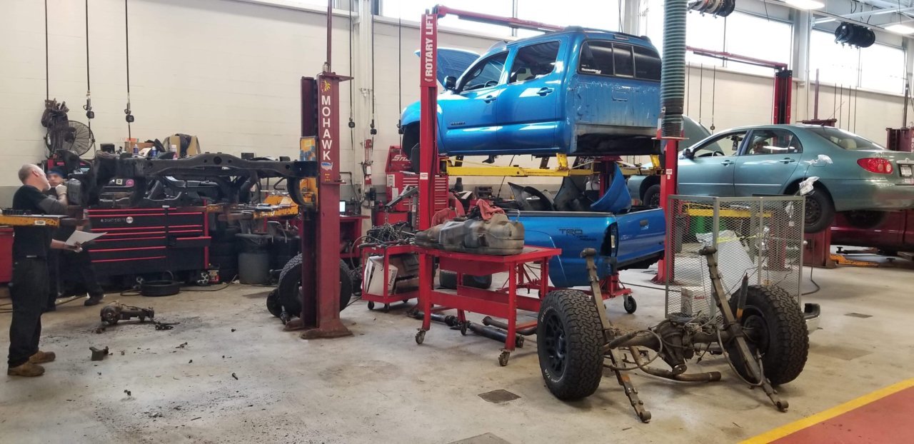

    Apologies if this has been posted before but this is flippin' awesome.

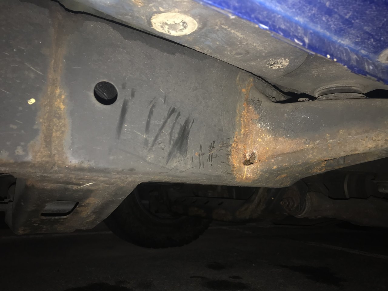

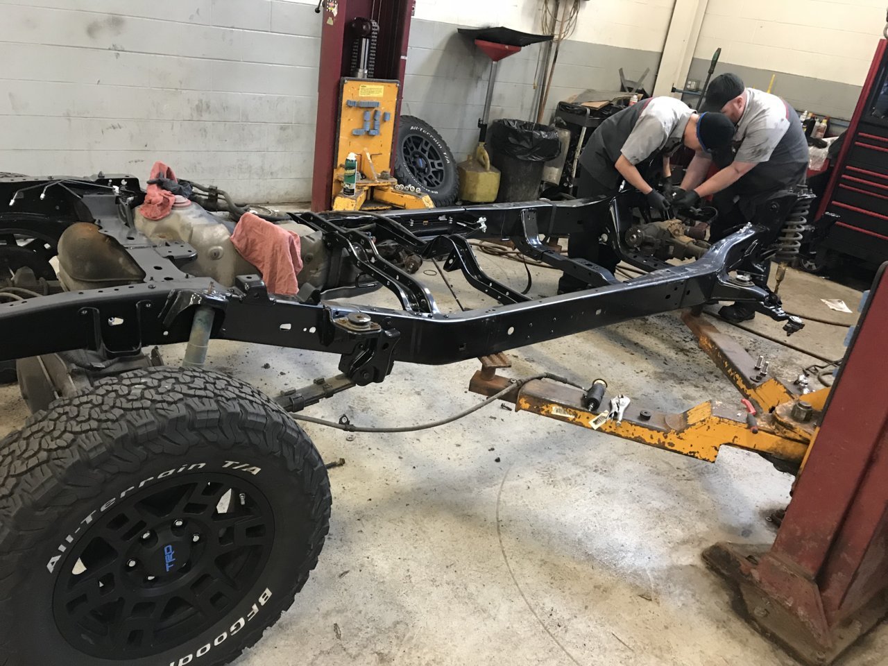

    just got my frame replaced. this is what failed me. so you would be surprised what would fail the inspection. rest of my frame was solid as can be!

    yeah i was shocked when they said it failed i was like wow!

    one thing i don’t understand is why they said to me oh yeah 41.1 hours. even is on paper... the whole job took one full business day to do. as they started tuesday morning and was done by close of business with the truck parked outside! that’s prob just book time right?
    anyone know?

    It sounds like it's probably book time, but don't forget that there may have been multiple techs on it.

    yeah iknow there was 3 tech’s.

    3 techs spend 72 hours in 24 hours
